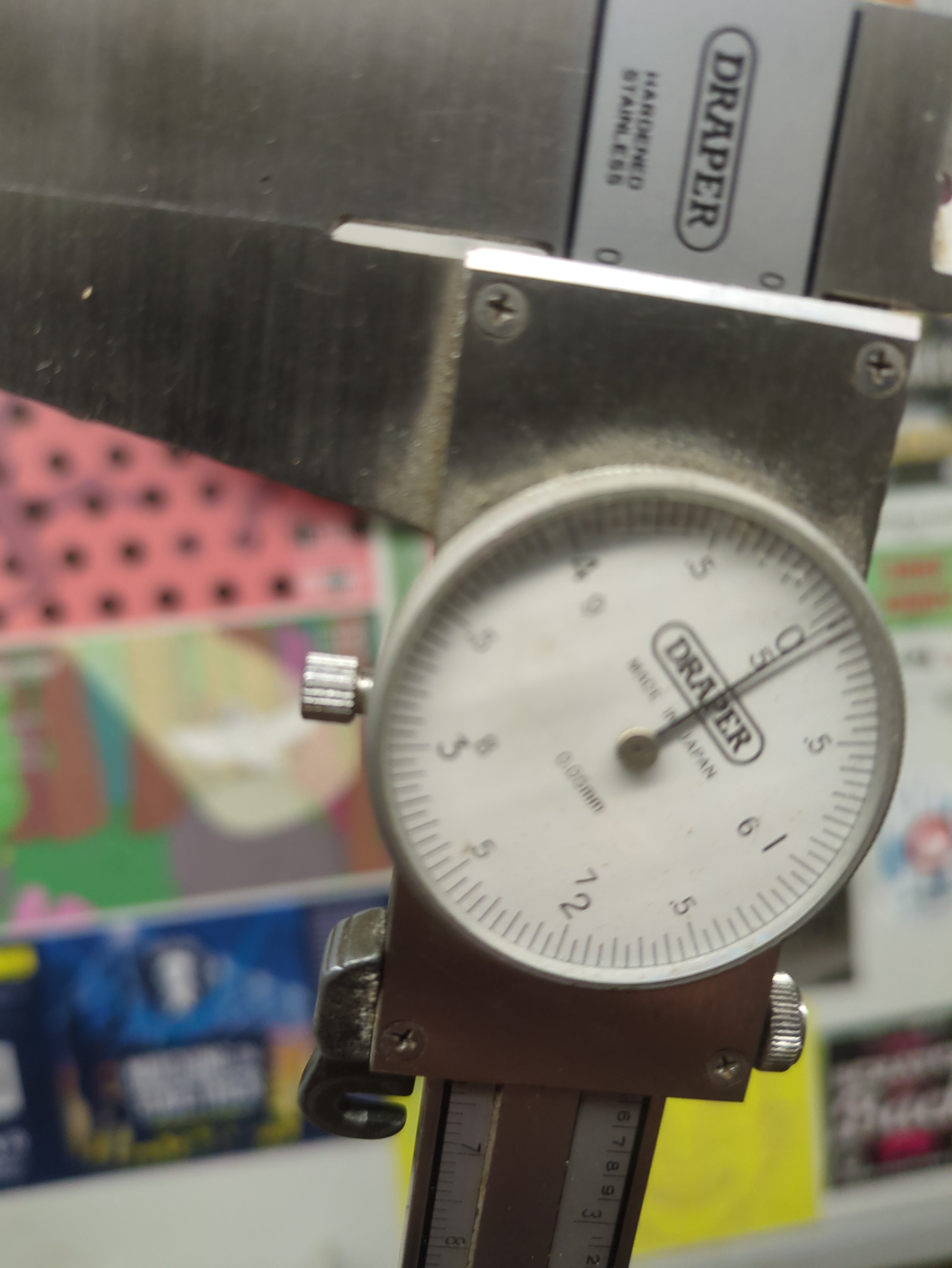

Worth buying one of them measuring caliper tools to keep an eye on them. Mine was a middle of Lidl special.

Get a "G" type calliper, not the "F" type. If there is a lip on the edge of the disc, an F type will be unable to measure the wear area. G type ones avoid the lip.

You can measure very well with a standard caliper, but you have to add 2 shims of known thickness, for my part I use 2 small neodymium magnets, you will of course have to deduct the thickness of the 2 magnets to get the real value.. 🍻
I've never heard of "G" type Vs. "F" type rotors. My magnet is mounted on the rotor, but can be transferred between rotors as the magnet mount is just held in place by the centerlock.
What is a "G" type, what is an "F" type and is there a place in the product description that identifies these as such? I've just never heard of this distinction, is all.

Regardless of which measuring tool you use (G or F type calliper) , do an initial measurement for your tool and for personal reference. A slight angle deviation of whichever tool you use can make a difference.
I start off with a clean finger-thumb-pinch-n-drag method over the rotor wear surface. Any ridge over the thickness of your finger nail …then I measure.
G-type.
F type.
Look at your own hand to see the cave-man type. 😉

This is simply to measure the thickness of the brake disc in the center, avoiding the outer edge 🍻

BTW you can use ordinary measuring calipers on the discs as there is a recess that clears the lip.

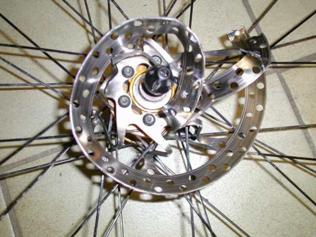

My main concern is not popping the pistons out, but having a catastrophic failure of the rotor worn to thin under heavy breaking. For me it’s not worth the small saving.
