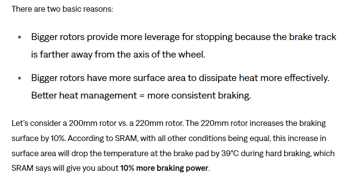

An interesting article on this - Are 220mm Rotors Worth it? Why Bigger Brakes Are (Almost) Always Better
Below is a good shortened example.

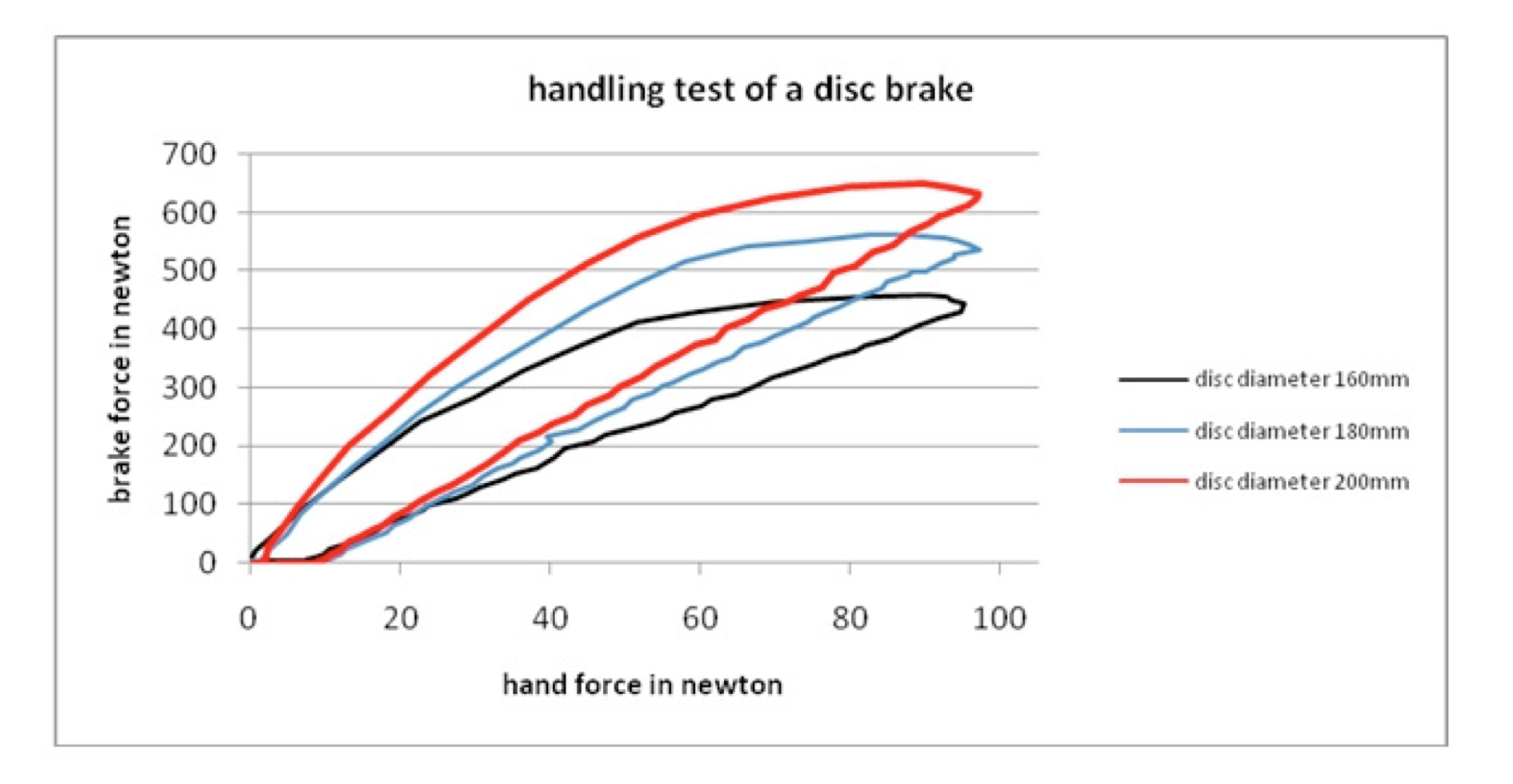

Found a white paper. For a given hand force, brake force in Nm is higher with a larger disc diameter.
Again, not disagreeing with that. A larger disc has a greater leverage force on the hub. However, that won't cause you to stop in a shorter distance. It just means you need to squeeze less hard for the same braking force (Which could even cause you to lock the wheel accidentally, in the extreme.)
A perfect graph to depict leverage ratio.
It's not that it feels like you're applying less pressure to get the same force it's that you're factually applying less pressure to get the same force. If you applied the same force on the leaver of 200mm and then 220mm you'd get more stopping power from 220mm and thus better braking performance.

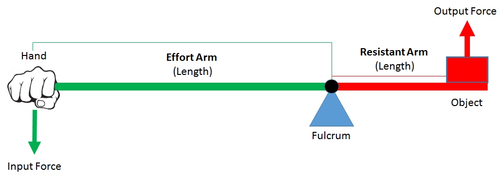

Another way to look at this, imagine trying to undo a wheel nut with a 10 inch bar and 50nm of force then doing the same with a 50in bar, it's 5x the leverage ratio which basic maths will tell you more leverage equals more force output.
Again, not disagreeing with this. But applying less force at the lever does not mean you'll stop faster. For the same amount of force at the lever you will stop faster, but threshold braking with either brake will stop you just as quickly. The only way to stop faster is to increase the threshold before grip is lost... Which means gripper tyres.
If you're out there regularly overheating your brakes then absolutely you should get bigger/thicker rotors. You can also change the pads for ones that resist heat better or find a solution to cool them better.
If you're regularly getting sore hands from braking, then absolutely try larger diameter rotors as this will increase the leverage on the hub and reduce the effort required by your hands.
If you find you're overshooting corners or just want to stop in a shorter distance for whatever reason, then upgrade your tyres.

On big rotors:
You'll have higher leverage (bigger diameter) - less pulling force at lever require to desacellarate the EB
Bigger area in each rotation - less heat in the disk for same length you're braking
Would love to try HOPE V4 with vented disks - although I'm really happy (and surprised) with stock brakes on the Underdog.

That's kind of the point though. Performance cars always have bigger brakes, not because they need to stop faster in a straight line (a child could run out in front of any car) but because they're designed to be used on track days or autobahn blasts, so they need brakes that can resist fade better.
As such, everyone's assumption is that bigger brakes = faster stopping, which is completely false. If both sets of brakes have enough power to lock up the wheels then it's tyre traction that is limiting the braking distance.
Are bigger brakes "better" than smaller ones... It's not as easy as just saying yes.
Do they resist fade better? Yes.
Do they require less force on the lever/brake pedal for the same amount of slowing? Yes.
Do they stop the vehicle in a shorter distance (not taking brake fade into account, as we already addressed that)? No.
Do they add unsprung weight to the vehicle? Yes. Is that good? No.
So it's a case of choosing the appropriate brake for your use. You could get out the welder and adapt your bike to take a motorcycle brake. The disc is bigger and thicker and the caliper and pads are much larger. But you'd likely take longer to stop than a 160mm MTB brake because of all the additional weight and additional rotating mass. The suspension feel would also be awful because of all that unsprung weight.
Sure, that's a crazy extreme, but the point is that bigger is not always better, which is why not all bikes have 220mm rotors all around by default. If you're not overheating your brakes then getting bigger rotors because you believe they will stop you faster is going to lead to disappointment and no real gain.
If you want bigger rotors to ensure that you never get brake fade even if you go on bike park days in summer or on a trip to the mountains then by all means. Just don't expect them to shorten your braking distances under normal use.
And this is coming from someone with big red Brembos on all four corners of his car, so I'm well aware of the benefits, but I know my car wouldn't stop any quicker than an identical car with the smaller brakes from a lower model. On a track day the car with the smaller brakes would likely cook them in a lap or two though and I'd still be OK.

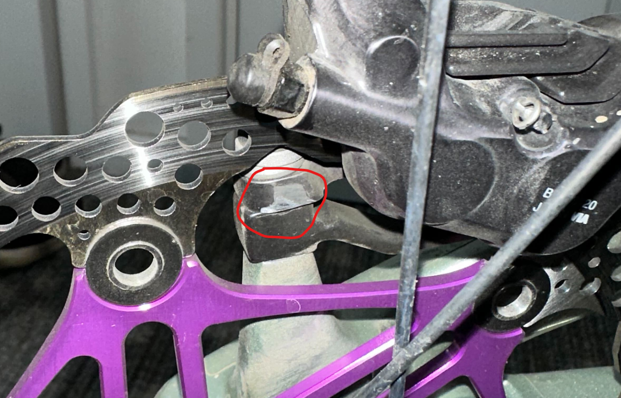

So do they fit on the back without modifications? Cause I'm confused while those Hope rotors are laying in my shopping basket :)
Btw, have you tried 200 or 203mm at the back?
They do fit yes but the Hope rotor rivets rub on Shimano brake a known issue for years. Excuse my dutty bike but the photo shows it actually hits the calliper where it mounts to the adapter:
I did 220mm front and 203mm rear as direct replacements for OEM then you don't need new adapters as comes with Shimano 203mm on the rear.

The limiting factor will always be tire grip. Although there are ways to have better grip with the same tire. ex: better suspension tune / design. Nevertheless at the end of the day, its tire grip that will be the limitinh factor.
On rotor sizes, I believe that by using less lever force on bigger rotors, riders are lead to think it brakes better.
Like braided hoses, that expand much less, and will require less force, because the hidraulic pressure is efficiently use to push the piston, and not expanding the hose.
In terms os sizing, you have MX or Enduro Moto, with "small" diameter compared with SM/Road bikes, and that is to limit brake skid/lock.
On dirt you won't use the full power of dual brakes, or evem 320mm disks.
What is required on Dirt is power and control.
Saying this would a 240mm disk brake be excessive? I don't think so, but presently I'm ok with 220/200! Like I was with 200/180... and back in time 180/160!

Exactly. If a tyre had infinite grip and never slipped, then a larger rotor would stop you faster due to the extra leverage, but in reality that's never the case and all brakes can lock the bike's wheel up. Adding power won't stop it any faster, it'll just lock the wheel with less force and that's not a positive thing! If you fitted 160mm rotors to a Strive:On and rode it next to a Strive:On with 220mm rotors at the same speed and with the same tyres, then both jammed on the brakes at the same time, right up to the threshold of grip, they would both stop at exactly the same time. Maybe the 160mm bike would stop a barely measurable fraction sooner due to reduced weight, but you'd need perfect lab conditions to notice it due to how small the weight difference is.
Sure, after numerous back-to-back stopping the 160mm rotors would start to suffer from heat induced brake fade, and if you kept going long enough the 220mm rotors would eventually suffer also, but I said from the start that the benefit of larger rotors was increased resistance to brake fade.
It's the equivalent of having a bolt torqued up to 2Nm and easily undoing it with a 9 inch long wrench. Buying a 10 inch long wrench will mean you can use less force to undo that same bolt, but it won't undo it any quicker.
That said, all of this sounds like I'm saying bigger brakes are worse, which isn't the case at all. These ebikes are fairly heavy so will introduce more heat into the brakes to stop. They also tend to travel faster, which again means reigning them in from higher speeds which also puts more heat into the brakes.
My point was just that they won't stop you more quickly. If you're looking to stop more quickly, get softer compound tyres or reduce your tyre pressures to increase your braking grip.
I'm surprised that people go through rear pads several times faster than front pads though. With the weight of the bike shifting forwards on deceleration I'd have expected front pads to wear out first as they do on cars. The bike manufacturers seem to think the same way, as they often tend to fit larger brakes up front, as with our bikes.
