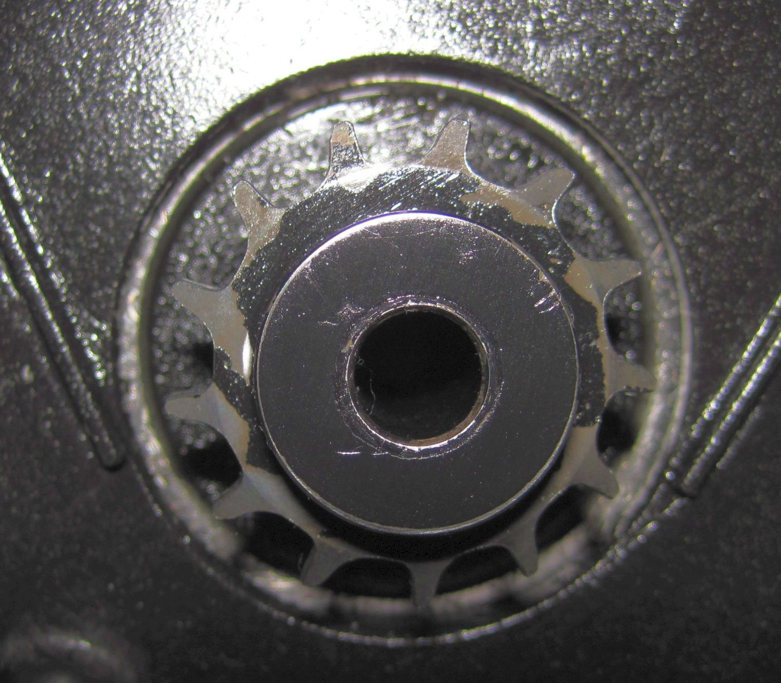

Bought this week a #25 chain and checked the length. Checked my 5430km chain against the new one. 0,3 mm longer across 23 chain links.
In other words ~ 0,2 %. Unfortunately the motor cog looks quite worn, but still no noise or any other shortcomings.
I wonder how a new cog looks like...

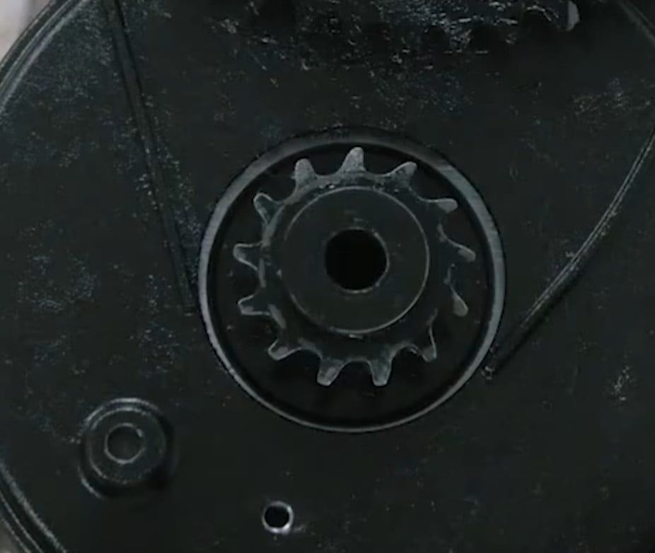

Interesting: the transfer chain replacement video
That motor used for this tutorial looked brandnew. Still the motor cog looks like this:
Hahaha, indeed. Could be that's how it is supposed to be. Doesn't seem correct though when one considers every other roller chain/sprocket set up. Maybe it's some new Canadian secret black magic technical innovation spooky engineering. I'll open up my new one and check when I get a chance.

Right. Even if the cog is very endurant, it will be worn some day. It must be serviceable without changing the motor or any other action that cannot be done in a reasonable equipped workshop. With all my consideration for the very nice performance, this is very bad. Would not have bought this bike if I knew this.
I can only hope to be wrong.

So the good news is the cog looks that way from new. This confirms my suspicions about Canadian black magic :LOL:
I sent photos etc to the shop and was provided a replacement unit so who knows? I remember comments about a firmware upgrade last year that my 2019 bike didn't have. This new unit and controller feels like it gives more support over a wider cadence to the original. Could all be in my head though, just seemed to be rocking up the hill today with fewer shifts.

It is a trick of the camera. I was a bit scared when this posting was issued and looked from different perspectives. The "bent teeth" changed position when I was moving my perspective. That weird tooth profile is causing this effect. Looks like a Shimano 11t that was mounted the wrong way...
But: the wear of the #25 chain was alomost neglectable, my confidence was largely restored.
If (!) the normal replacement criteria of 3% chain elongation applies, I will theoretically need the next chain at 80000km (?!).
Probably this is wrong, as I grow older the ECO Mode will be used less.
Of course I will also not risk damaging the cog and replace sooner. But even at 1% this means 25000km, if the wear keeps at this pace.
Still I cannot see the cog on any spare parts list, and I dislike the idea of shipping the bike for service reasons :mad:. Even if this is in quite a distant future. Not having dozens of plastic gears and lots of bearings less than other brands did attact my attention to RM....
