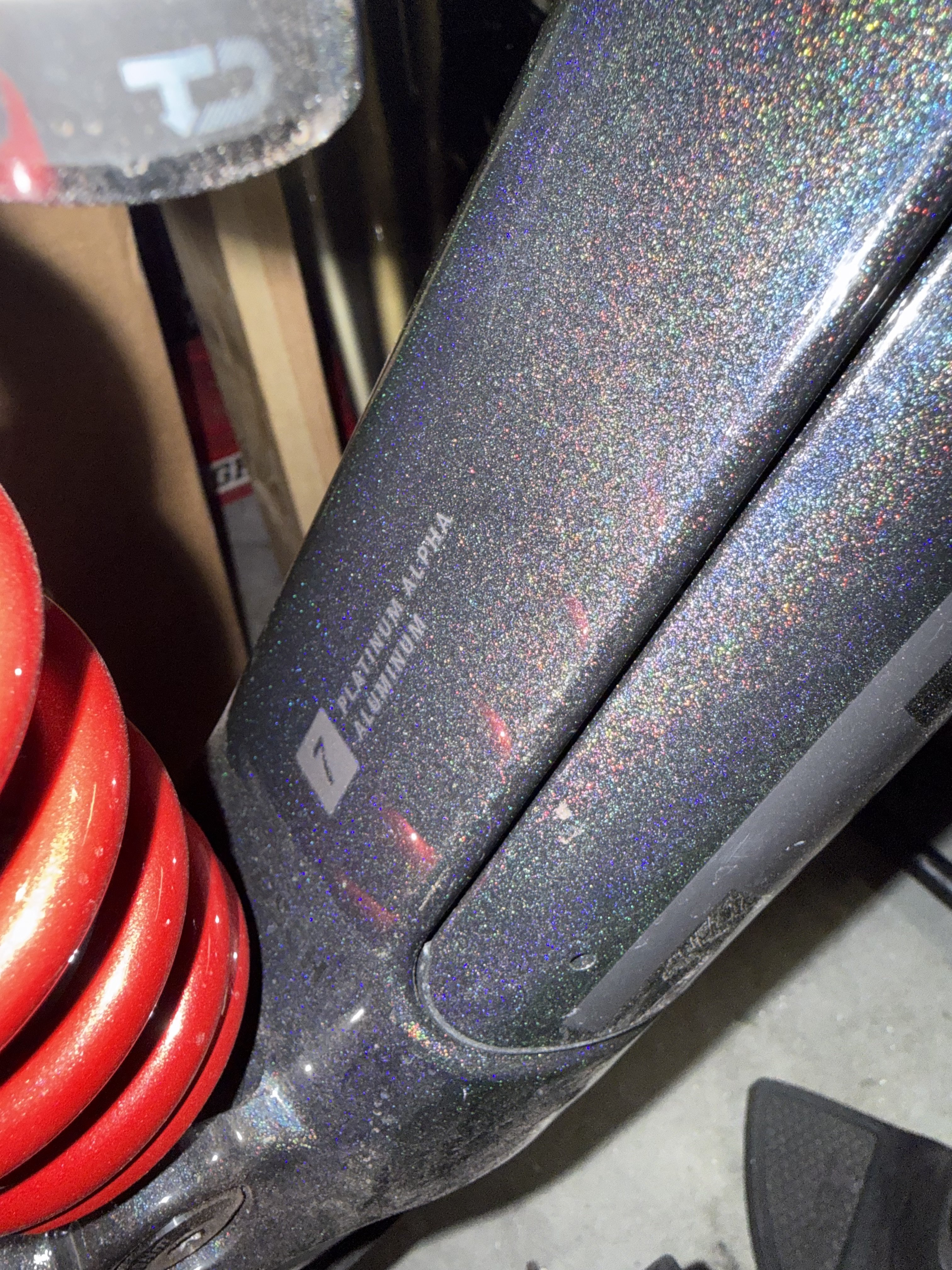

Carbon or aluminum Rail? I have a Vivid R2C coil on a Nomad, and it and the air version seem to have a decently large piggyback which can be a problem on some Rails.

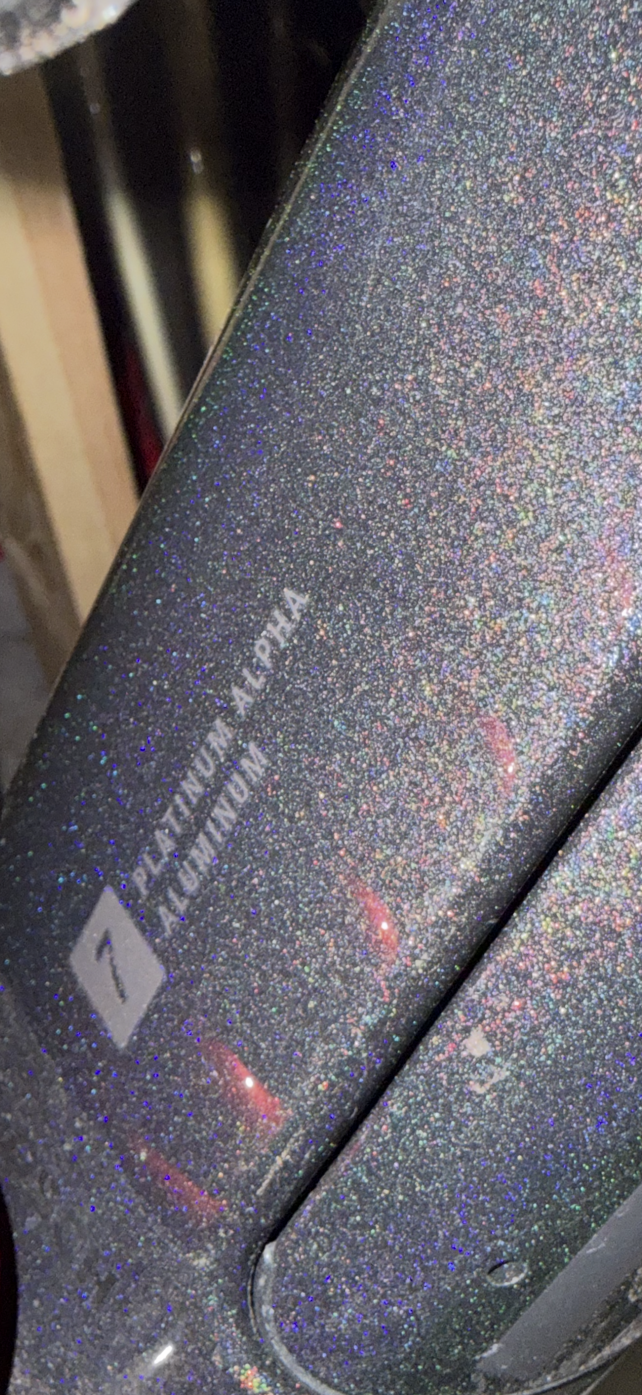

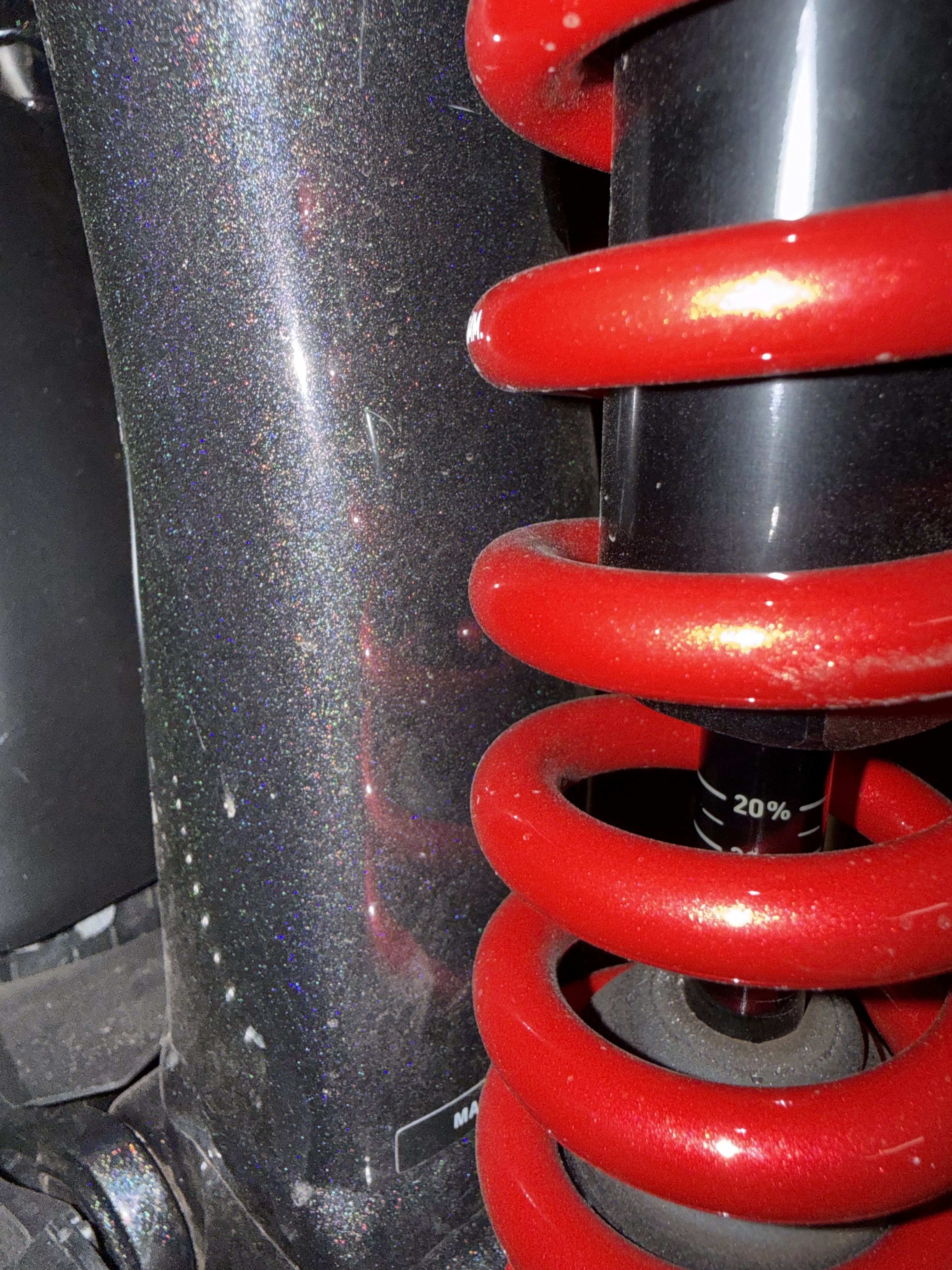

I 3D printed a very close approximation of a vivid 230x57.5 and it doesn’t come close to fitting on a 2022 medium 9.7 rail. The piggyback makes contact when you compress. The trunnion mount with an adapter might be possible as it will raise up the piggy back but I haven’t gotten around to modeling and testing that yet.

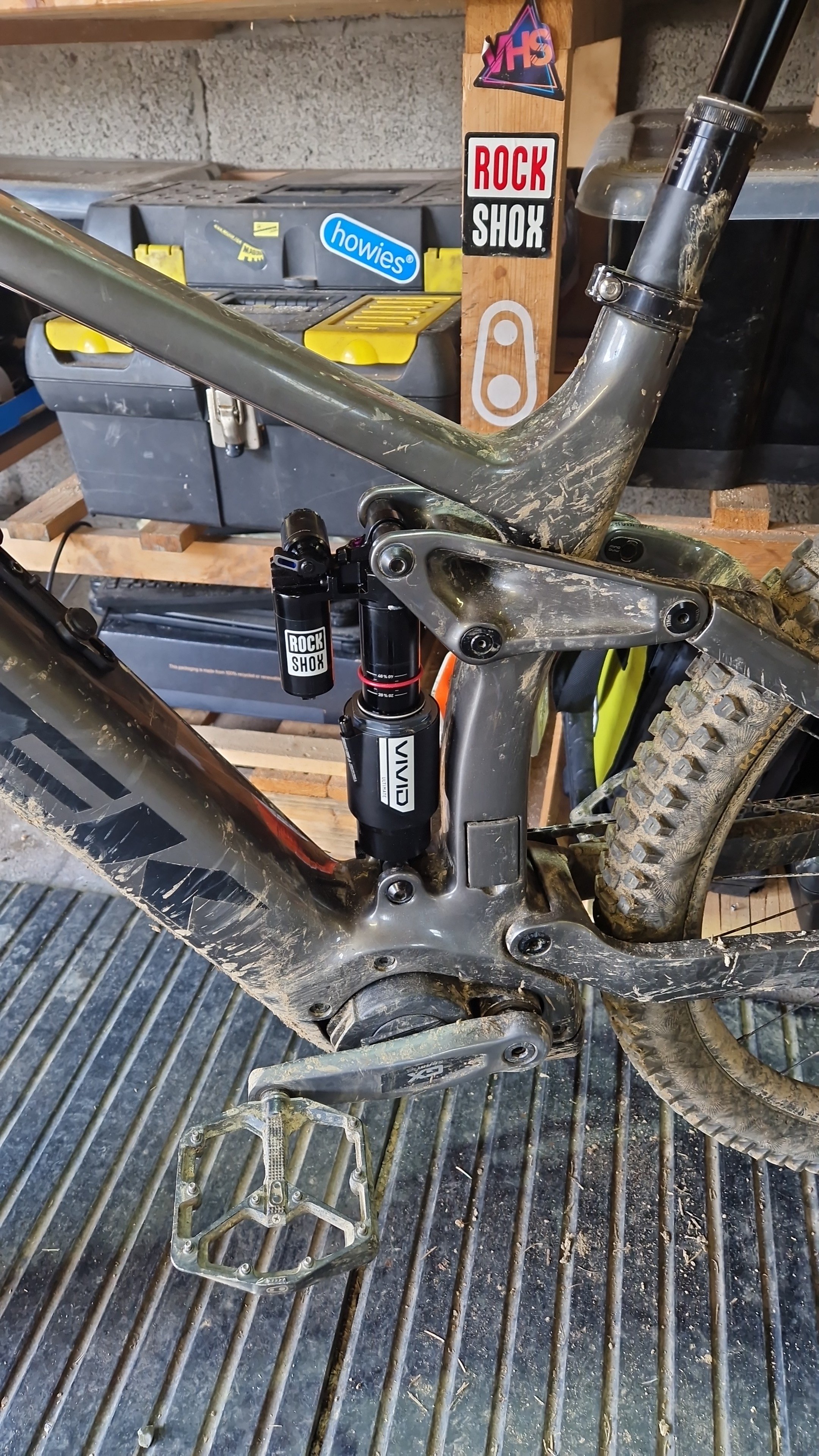

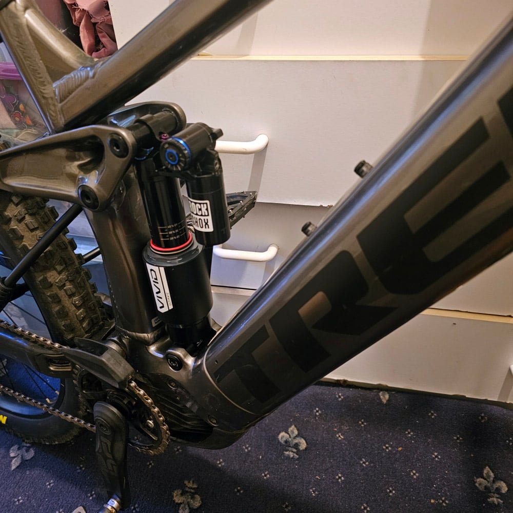

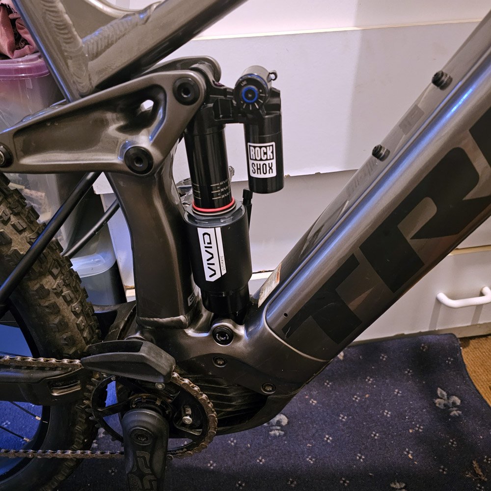

Just fit a Vivid 230x60 to my Rail 5 Gen 3 Large frame , it's almost touching the seat tube at rest but luckily the shock pivots forward under compression. The removable hexkey wont fit in the rebound adjuster so i'll have to find something else to adjust that and not much room left for a water bottle. First impressions are good though
