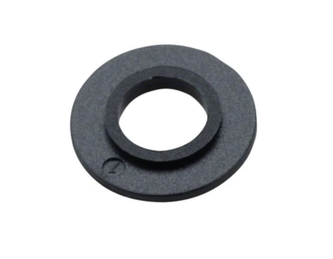

That's not the correct part. I already have some of those. The Lyrik fork uses a flanged plastic washer with integrated crush washer.
I’m in the states and even over across the pond you can’t find that flange washer in bulk only in a rebuild kit. That 8mm washer is sold in bulk here too and that is what I use with no problems. Hope this helps.
Cheers
Sram have told me that the flanged crush washer can be reused and should seal until it's replaced at the 200hr service. If it doesn't I'll use the standard crush washers as you suggested - thanks👍

They aren’t the same thing. I have seen using the standard crush washers can leak.

Mentioned this to my suspension guy the other day. His view is you don't need to change them, the sealing comes from the damper & air shaft rods pushed into the lower legs & that their actual purpose is to stop contact between the bolt & the lower leg base. Do what Bones says & wrap a bit of PTFE around if it still bothers you.

The picture is the crush washer for the right (damper) side, which seems impossible to order. The crush washer for the spring side is just a simple 8mm plastic washer and these are easy to order in bulk. I’ve also used a copper washer which is standard on motorbikes for anyway when an oil seal is needed. I’ve posted elsewhere how incredibly helpful I have found SRAM support. After making a mistake in the part number for a service kit, I was sent on (for free) from Germany. Like others, I want to service my forks myself. In Switzerland it is a minimum of £200 to send them away. It’s also a hassle and one is without the bike for a while. I also wrote to Fox about doing a 50 hour service on a rear shock and got this reply “The 50-hour service is absolutely something many home and shop mechanics are capable of doing. I am sorry to hear your local shop was not equipt for this job. You could always call other shops in your area to see if they are able to service your shock.”
The fact is that no shop seems interested in doing any work on suspension, which seems odd as the 50 hour service is quite easy and quick. Moreover, this is a maintenance task which needs to be done quite often and so would give shops more work. I suspect a lot of folk ride for years without anything been done to their forks and don’t realise how performance is gradually falling off.

Yes I know they are fairly impossible to find as I was looking for them. I’ve now ordered a bulk bag of 50 arriving in the next few days, maybe Friday they will arrive.
I’ve got a bag of the standard ones already. But I’m not going to use them when I’ve read they leak on the damper side.
I agree with SRAM support being great, except for their choice to not sell these washers officially (maybe available just to service centres). Which is why I’m just about to swap out my XT8100 brakes for SRAM Code Stealths. Then I’ll get rid of the XT 12s drivetrain, Shimano has no support, only via distributors and they can’t give sufficient technical information when I’ve tried, or 2 weeks for a simple answer.

I am fairly confident that a generic nylon stepped washer could be obtained quite easily from a decent online hardware supplier. This isn't a critical part, it's just to prevent, at the most, a very low pressure oil leak. I'm happy to look for one if someone can provide all the dimensions.
