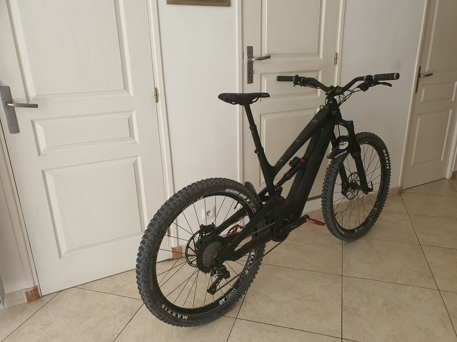

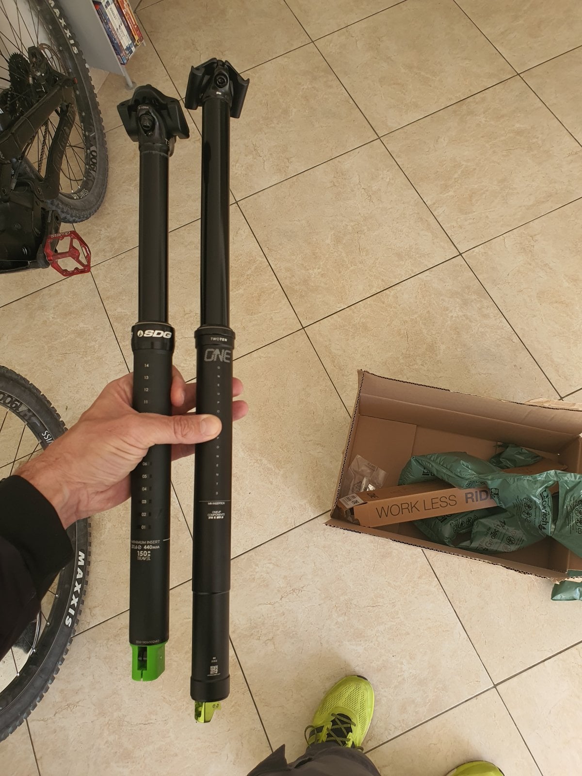

One up in 210 is the best for me !

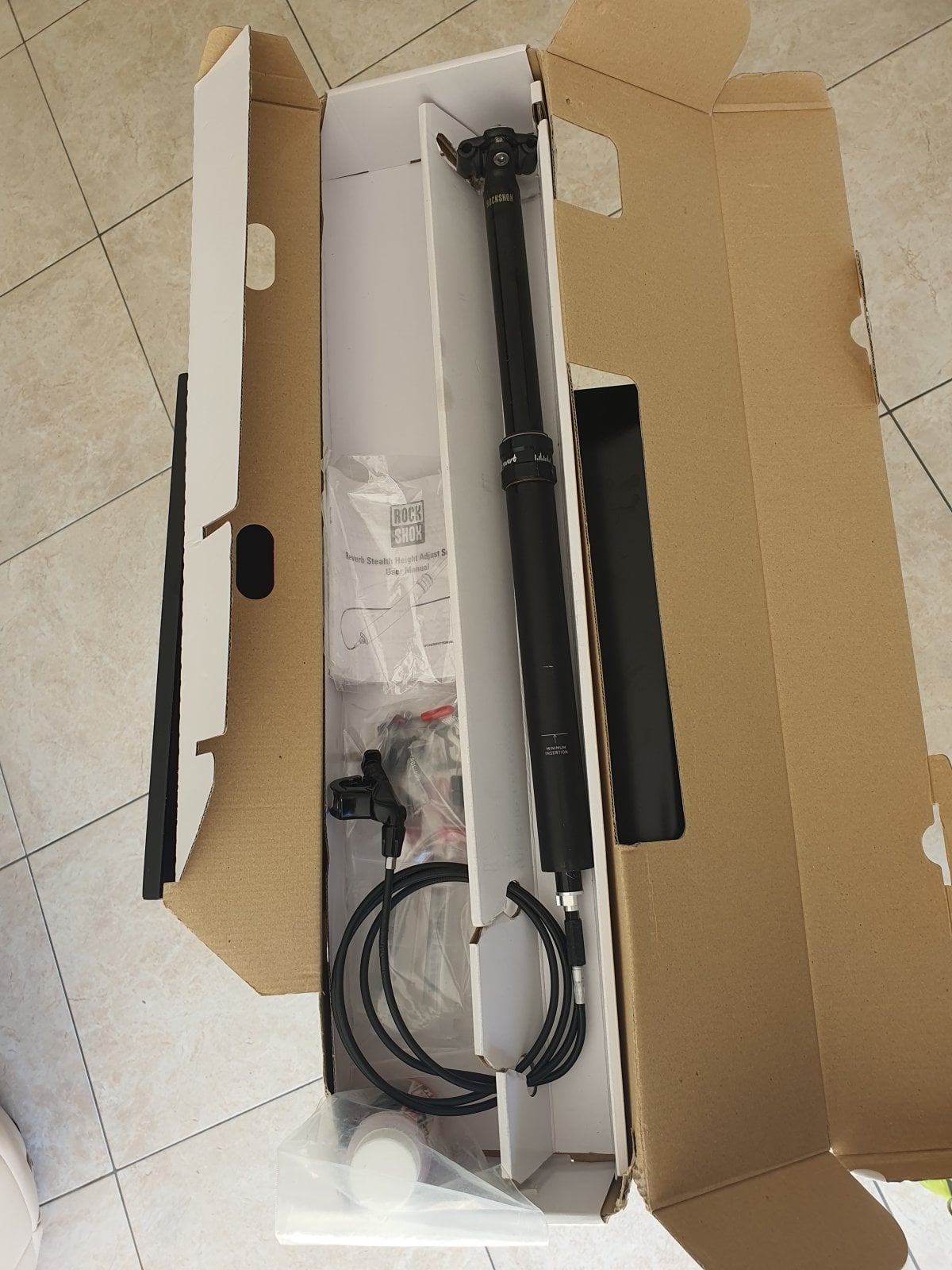

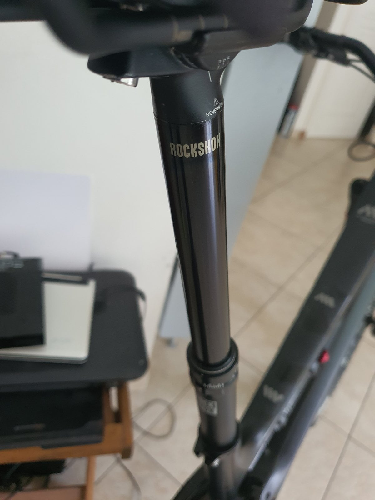

the cable of the control of the sdg passes to the millimetre within the tunnel provided for, I am not able to put that of the rockshox which is a slightly wider hydraulic hose. I had to drop the engine to install the rockshox reverb in 170mm, it dismantles very easily.. the one up in 210 is better for me my frame is in XL and I am 1m92

How much of a pain to install? Did you need to drop the motor?
I did, but I think it’s possible to do without touching the motor. My bike has a lip in the inner seat tube the the cable housing was catching on, and I couldn’t find anything that would work to pull it away and up from the inner wall.
