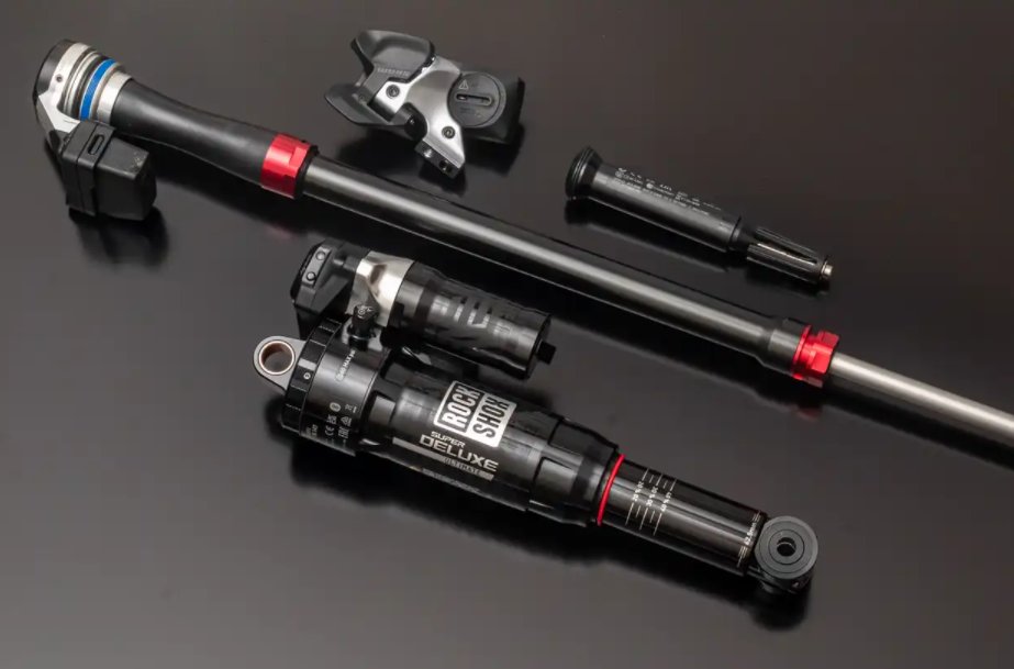

When you see pictures like this, it does make you wonder if they won't offer it down the line as a damper replacement.

At present, the Flight Attendant is based on the RCT3 cartridge, equipped with a three-position lock as well as low-speed compression adjustment. However, it was impossible to adapt the Flight Attendant to an existing fork or shock absorber: the cartridges were partially rebuilt to accommodate the electronics and the engine. The internal components are the same but the Flight Attendant is not just a “plug” which turns the dial in place of the pilot.
For the Pike and Lyrik, it's simple, everything is new apart from the cartridge. The two forks indeed have a completely revised chassis and announced as lighter, without any data to support this statement. Visually, they are less rounded, more angular than the old ones and are in line with that of the Zeb launched last year.

Inside, there are three evolutions. The first concerns the Charger Flight Attendant cartridge, which we have already discussed above. As we wrote, it is based on a Charger 2.1 RCT3 but its level of blocking in firm mode has been slightly revised: the Flight Attendant version is harder than a classic RCT3, without however reaching the firmness of the XC forks and Charger Race Day cartridge.
