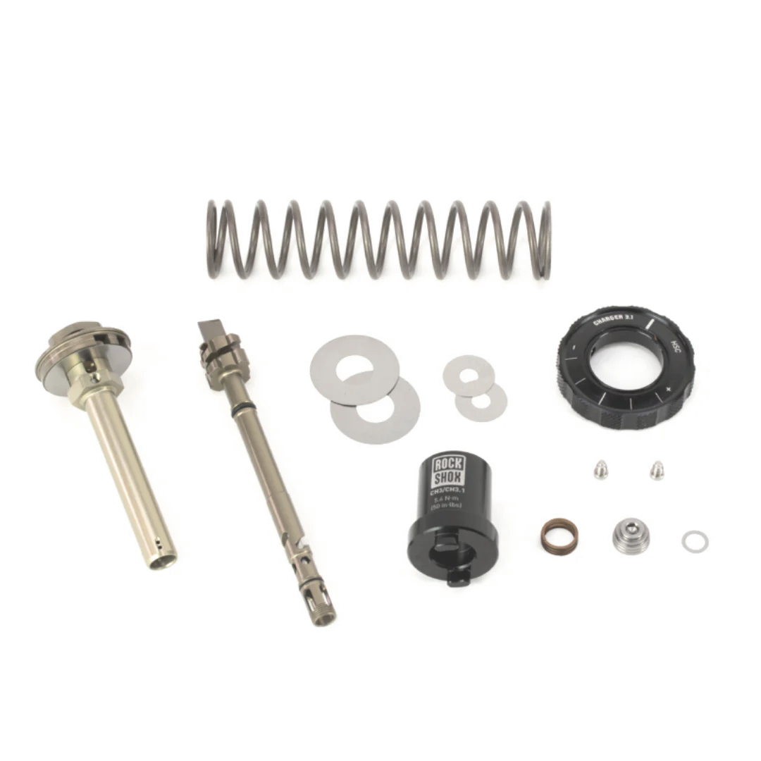

I fancy that 3.1 upgrade that Rockshox just released the £75 kit
but In 3 minds wether to try to fit it myself as a 200hr upgrade
send it off to get done professionally or to sell the charger that’s in my Zeb ultimates and buy the full replacement at £350ish
my thinking is doing it myself but unsure
Anyone done a 200 hr service was was it ok to do and special tools needed as in Rockshox vids they use special vice clamps to shock
thanks

I was keen on doing the same until I watched the rockshox video. For me, the risk is too high that I'll get air somewhere it's not meant to be when bleeding it, and it'll end up worse than when I started!
Maybe if I treat the Zeb to a 200hr service at a shop, I'll ask that they install the 3.1 upgrade as well.
Shame it's not easier to do, as I think this would play nicely with the TruTune in my 190mm Zeb.
PS just for clarity, this is the upgrade kit, link here:

I think I’ll give it a go watched a full video the other day didn’t seem too difficult
but…….. add in some new tools crowfoot ect and it adds up
i have contacted jtech about upgrading but there waiting on parts
think I might just wait too read some real world reviews on it see if it makes it better
