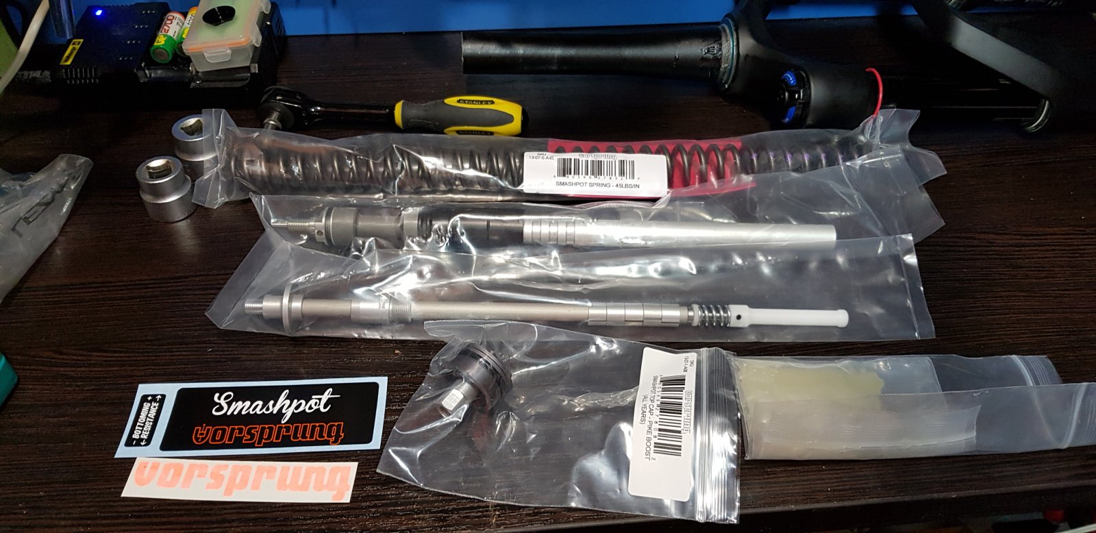

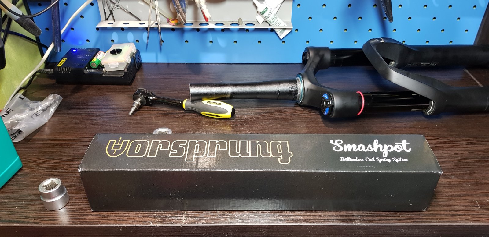

Here it is. Assembled it already and prepared for installing. Tomorrow I will do the swap and will test it during weekend.
