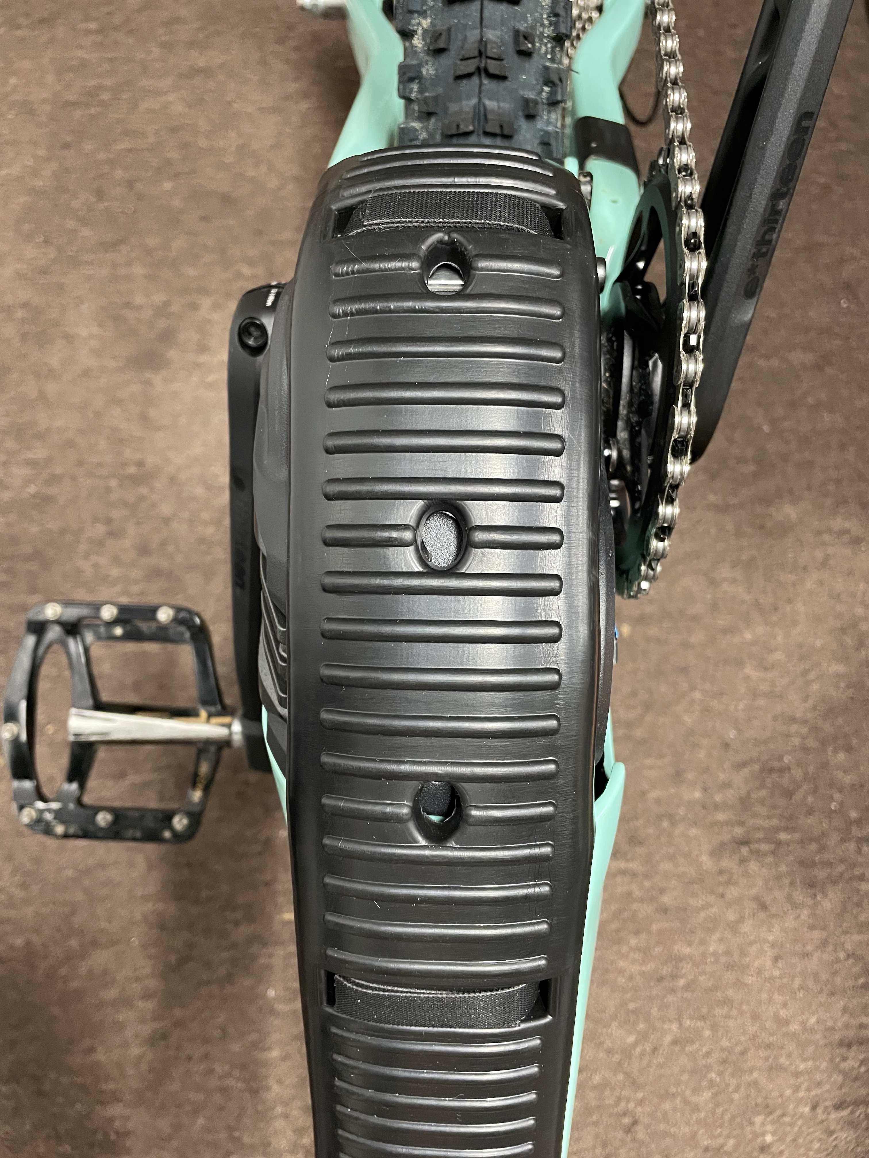

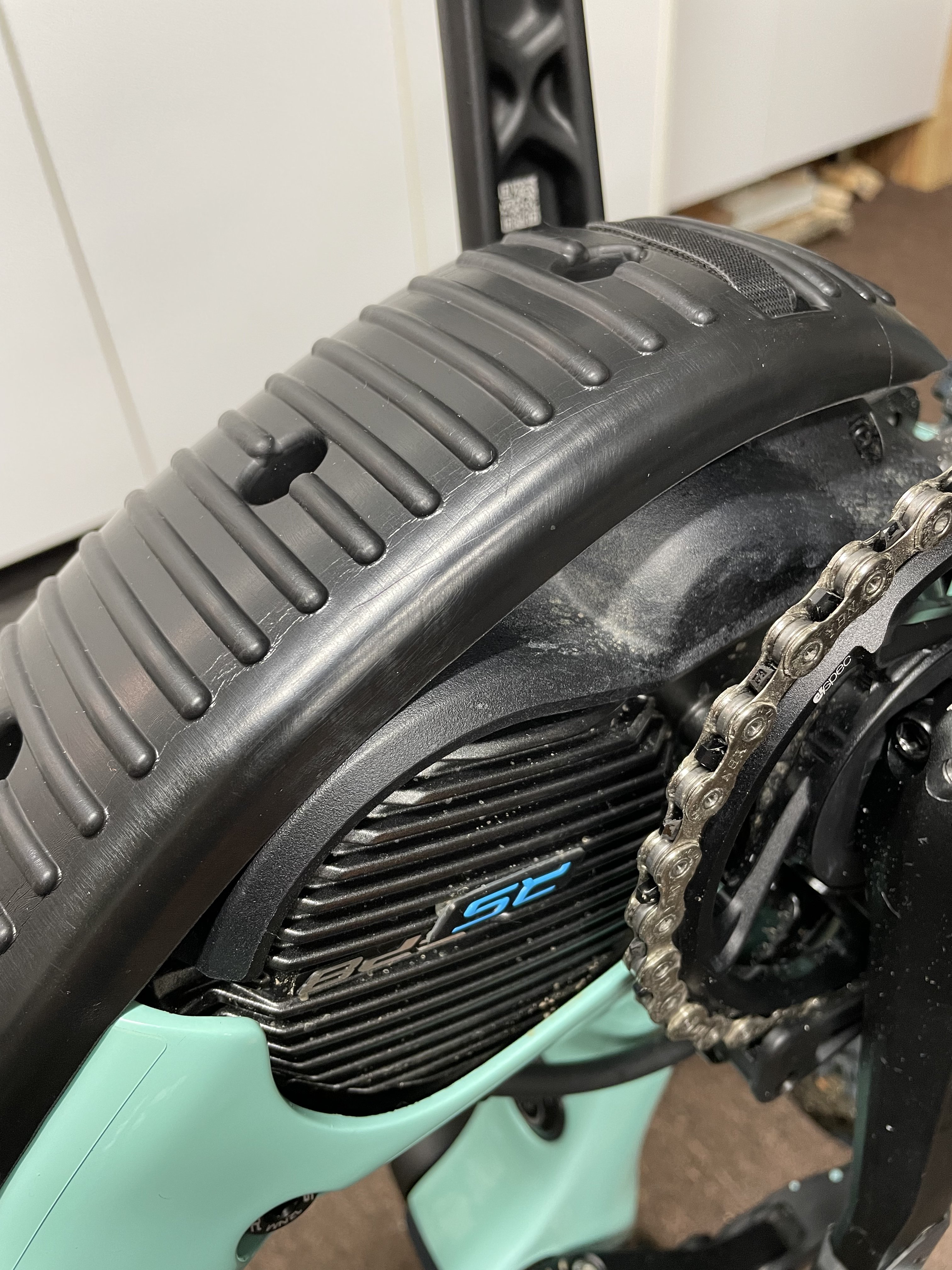

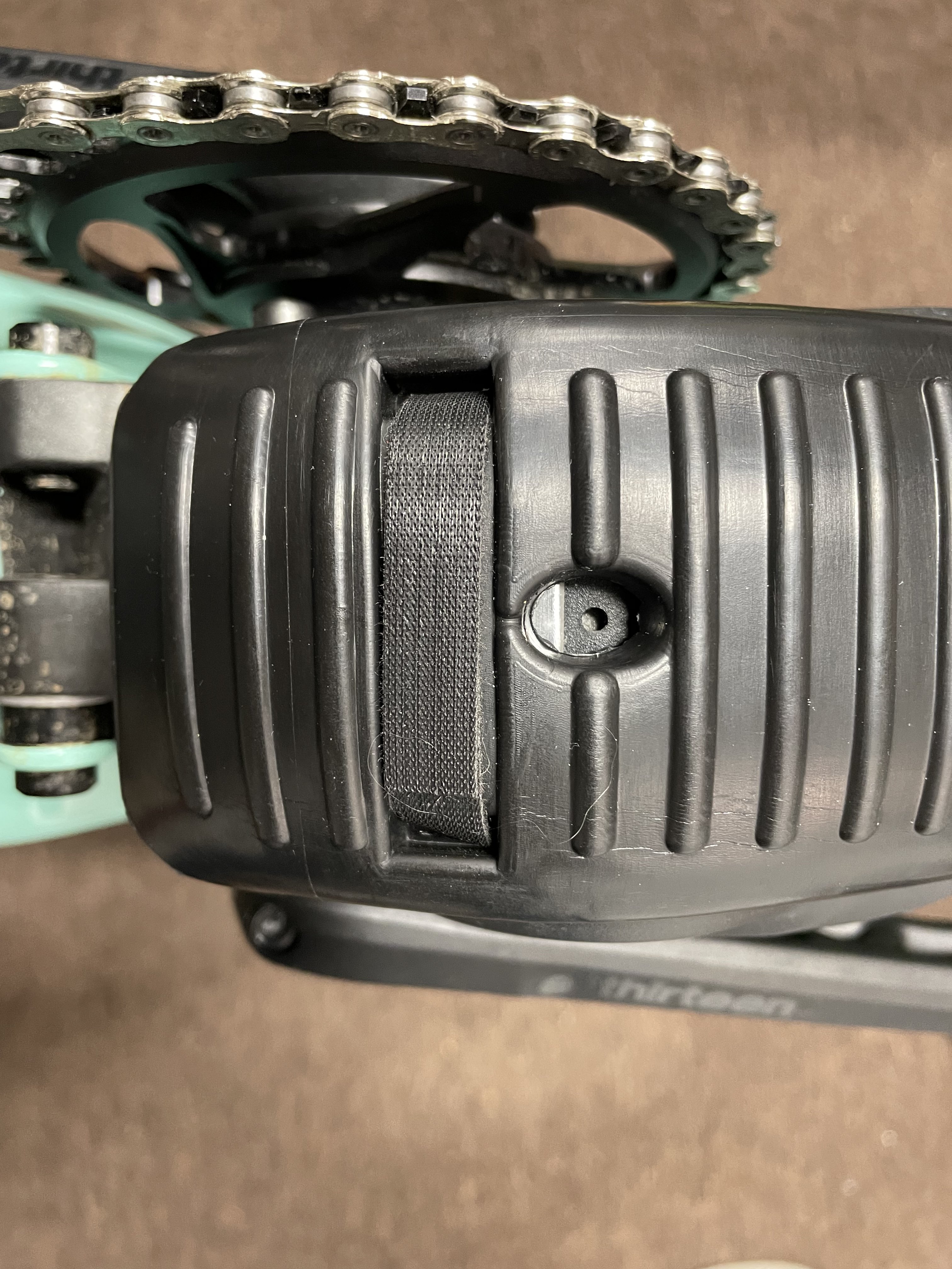

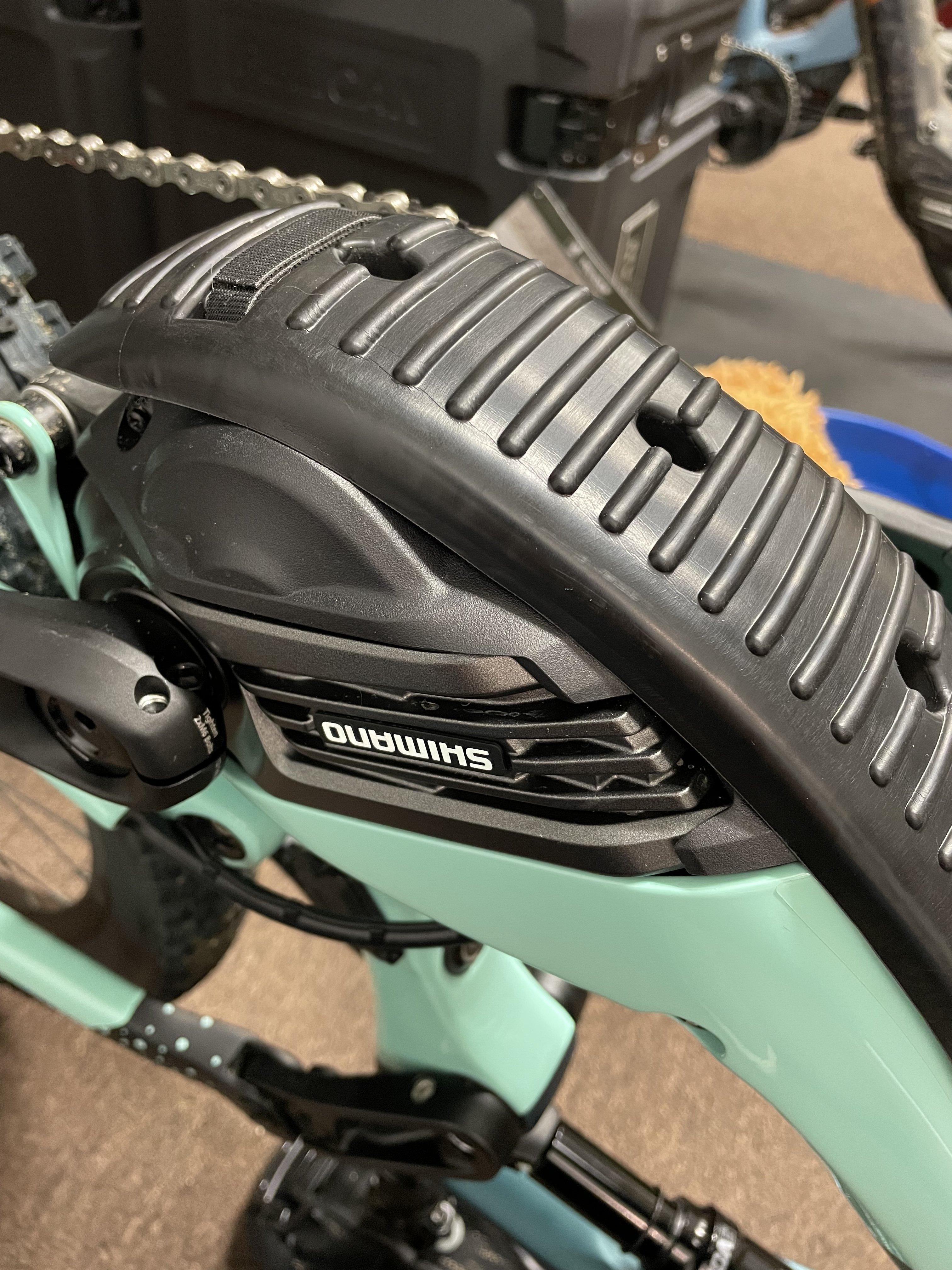

>> Whoops, just noticed the OP was asking about Rockguardz, not RockStop. I agree that the photos on the Rockguardz website are not very helpful to understand how it fits. If you are just interested in stopping water from getting in between the gap where the downtube meets the motor cover, I'd honestly just run a small strip of helicopter tape over that gap and be done with it. Anyway, if interested in how the RockStop works, read on....<<
Attached are some photos of how the RockStop covers the area around the motor. You do have a fair amount of flexibility to adjust the position fore/aft or laterally before you decide where to stick the attachment pads down. As you can see, I lined up one of the drain holes on the RockStop with one of the drain holes on the motor cover. There is a fair amount of space between the RockStop and the motor cover, so I'm not at all concerned about it holding water in, and of course it would help to serve as a splash shield to keep some water away of the leading edge of the gap between the frame and the motor cover. I actually don't care about that functionality at all, it's generally pretty dry where I ride. I have it mainly for protection from rock strikes on the carbon downtube. I have one on both my Rise and my wife's (pictured here).

Looks like a nice bit of protection. Not, that I'm finding the BB height to be obscenely low on the Rise H 2022 as it is. There's plenty of clearance on my bike, and I'm not planning on hucking over any trials type features unintentionally. But, looks like a nice protector for trail kick-up towards the underside of the lower frame.
On the odd time I do need to huck up on a rock, do you reckon the slide/bash guard above, is sticky? As in would it not slide on rocks, if it needed to? On the odd chance that happens, would the guard maybe get ripped off and leave a big smear of glue on the downtube? It doesn't seems to clamp the frame anywhere, but rather, is Pritt-Padded onto frame only.
Has anyone tried the above, for more than six months? Is it okay?
I bought one anyways, because it does look like it will do a reasonable job, for what it's made out of.
