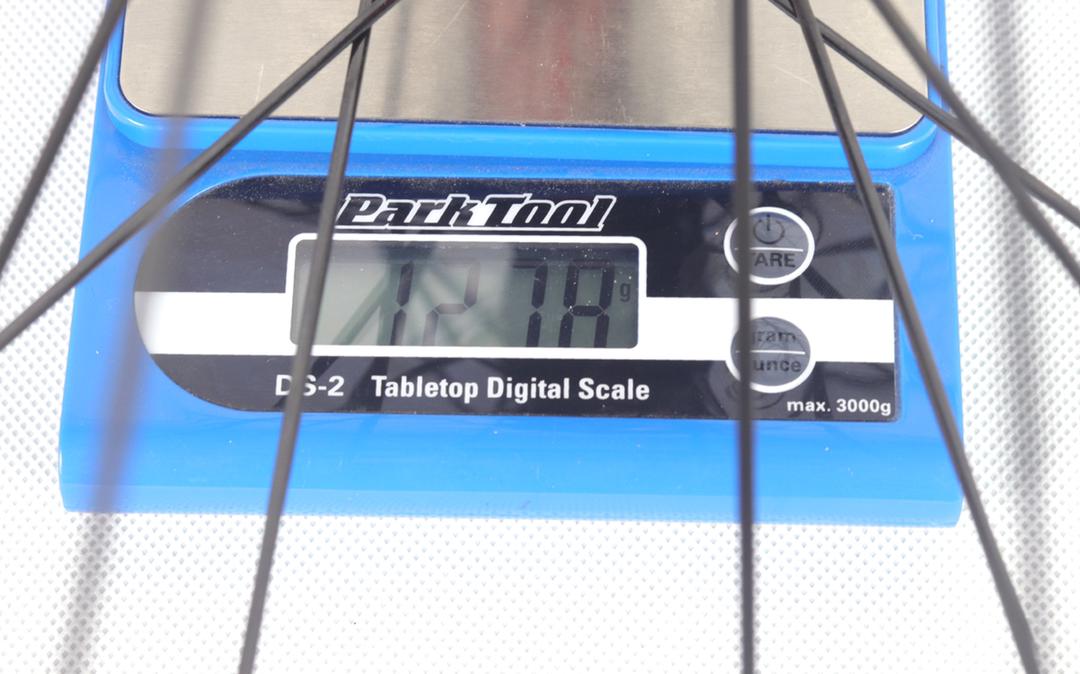

Ive bought a 29” 1278 gram carbon 30mm internal set from EIECarbon for my Rise M20. Made a really big difference in ride feel and performance. Costed me ~£890

Sub 1300g sounds dubious looked at their website even 360g rims with CX Ray spokes & DT240 hubs just under 1400g… my old light bicycle rims are 400g & were 27mm internal
