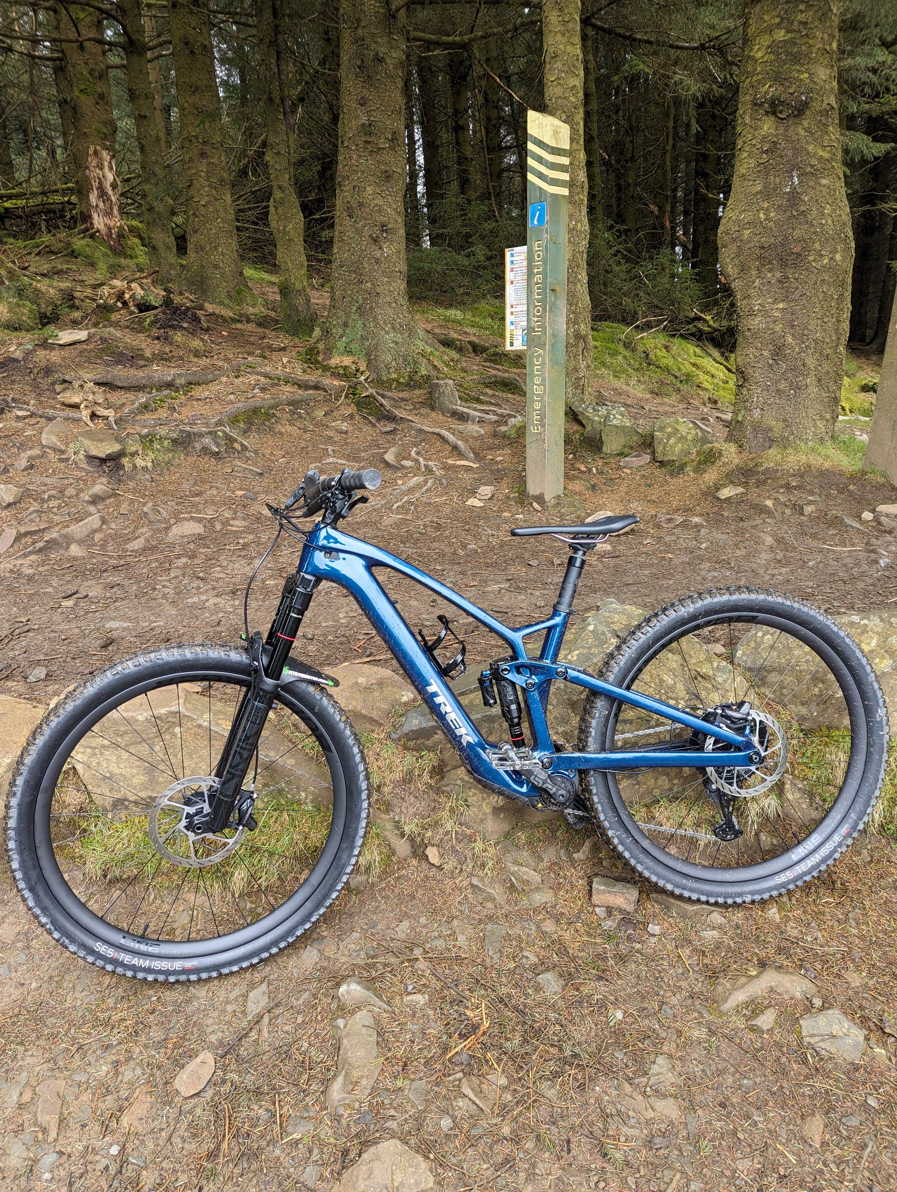

On the bright side, I fell off my new bike at Ae yesterday on the green/blue trail about 400m from the car park after completing all the red/shredder etc. my front wheel washed out on a gravelly root 😩. I broke my seat, derailleur hanger and am black and blue and sore.😂
