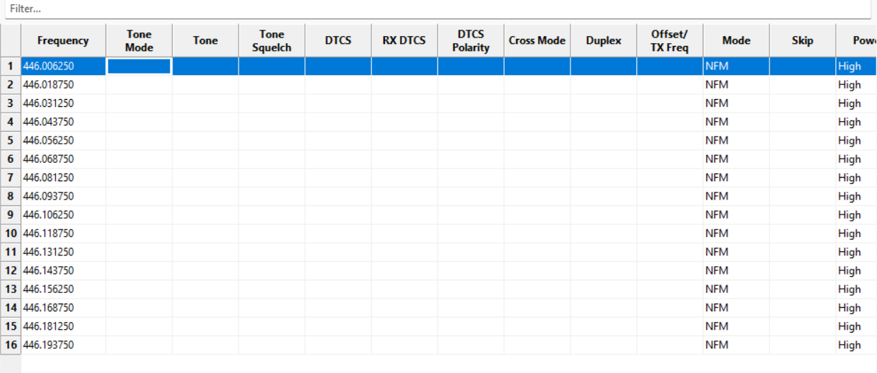

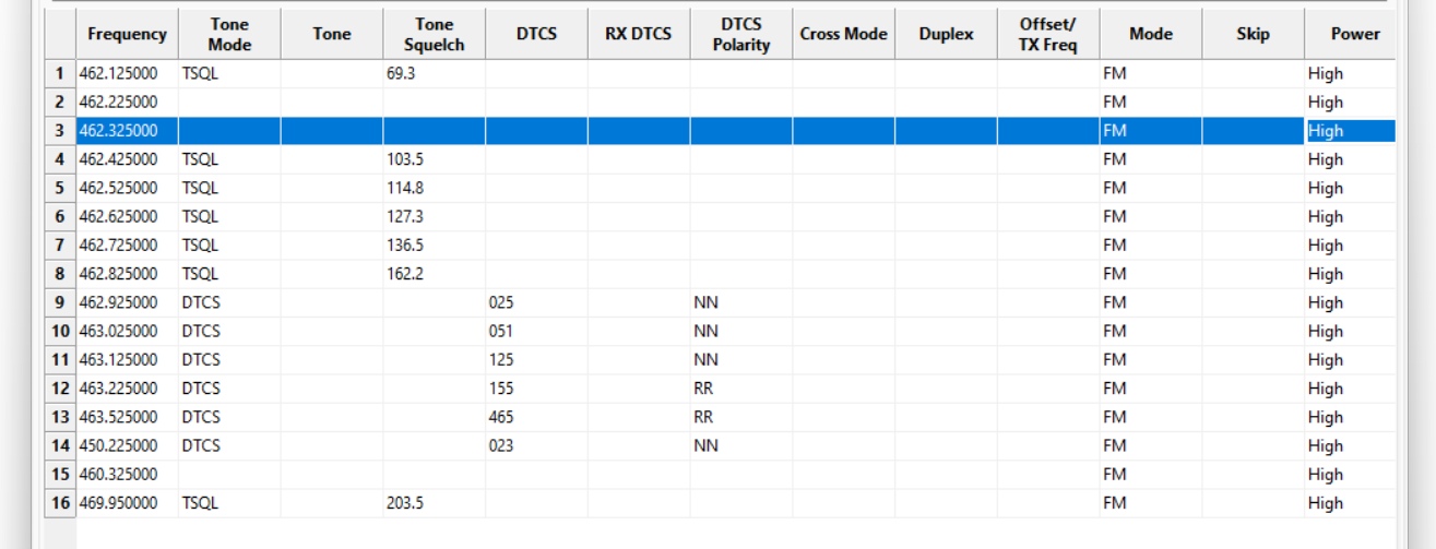

I've added a second file which contains the CHIRP config files for an English/UK config and a English/French config file. They're .img files so had to be zipped. So you'll need to unzip them, then you can open them in Chirp and download them to your walkie talkies to set the correct Frequencies. I've mainly included these because it was so freekin boring entering the info and no one should have to go through that.
UK config :
French Config :
UK config :
French Config :
