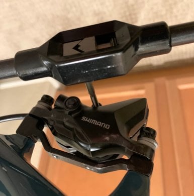

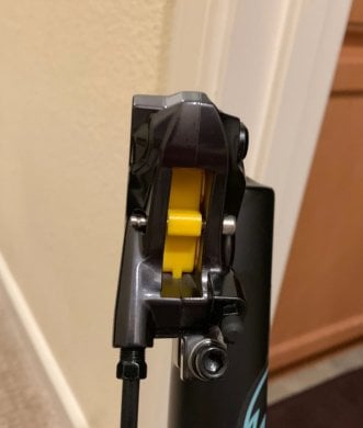

I have never used a Banjo adapter. I suggest replacing the rear brake hose if you ever do decide to go with a XT caliper. I mention the banjo adapter because I do not know your mechanical ability with regards to replacing a brake hose on the Rise, or access to a bike shop to replace the brake hose. Sometimes you have to adapt and overcome....See what I did there...
