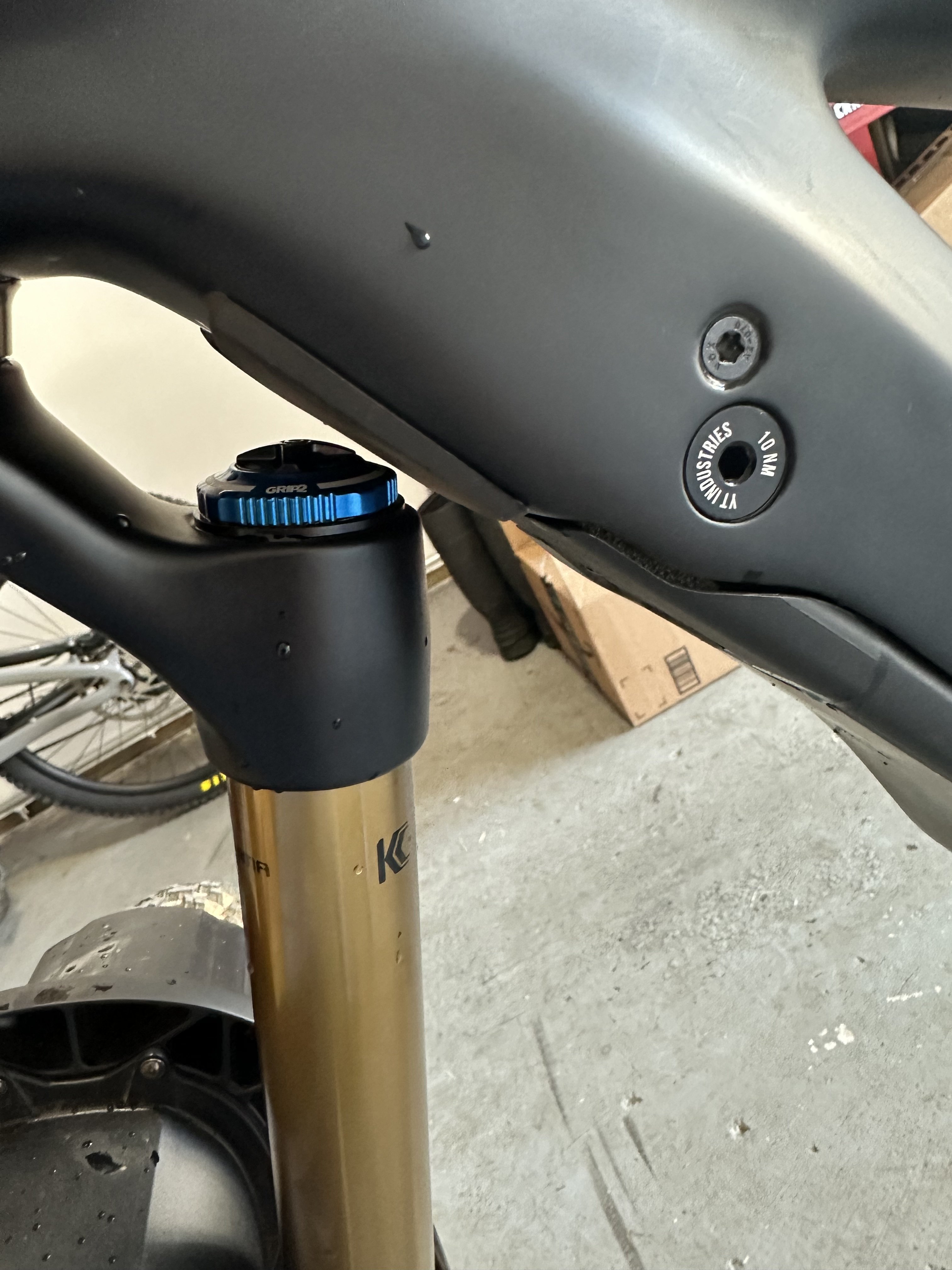

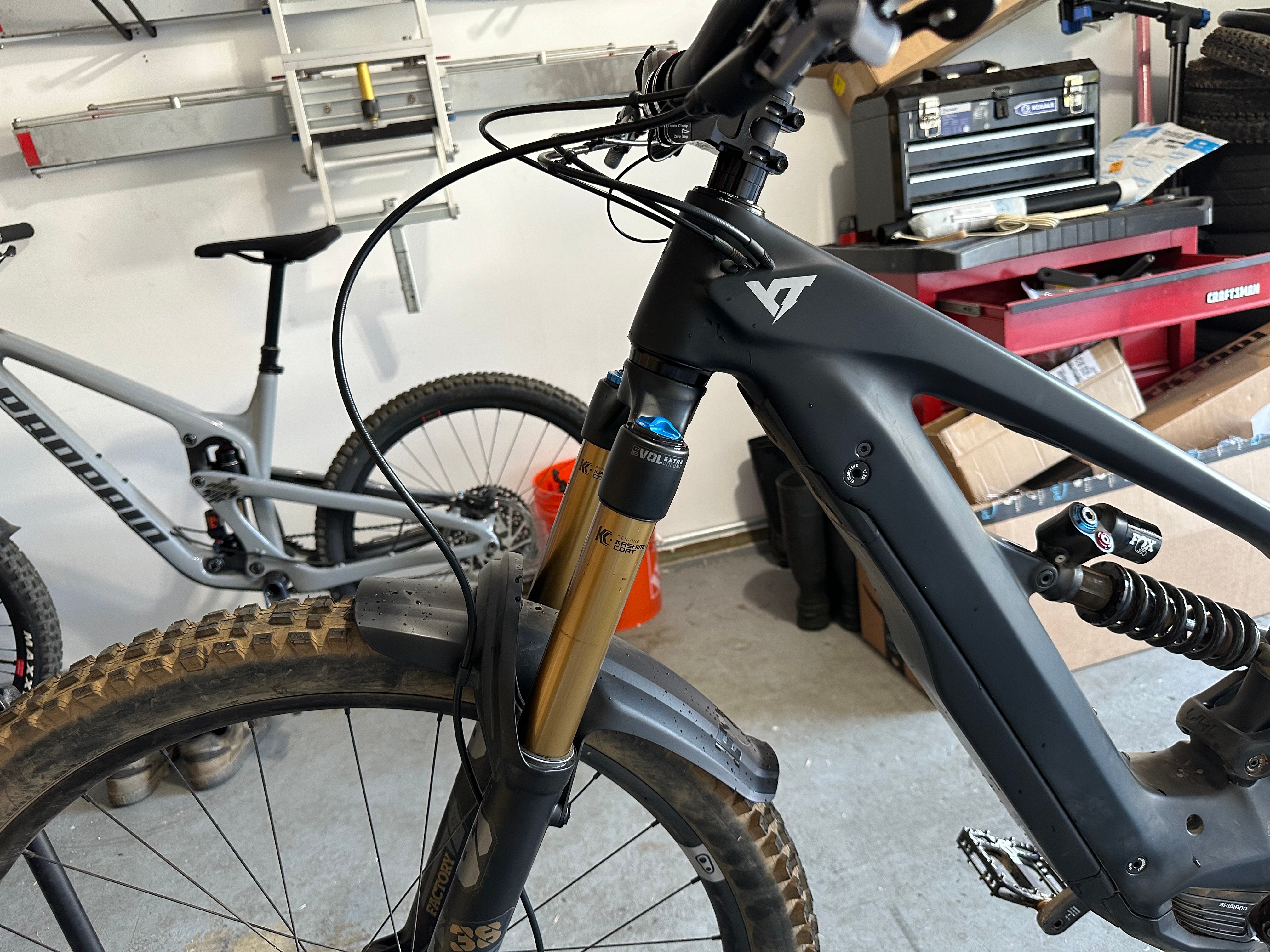

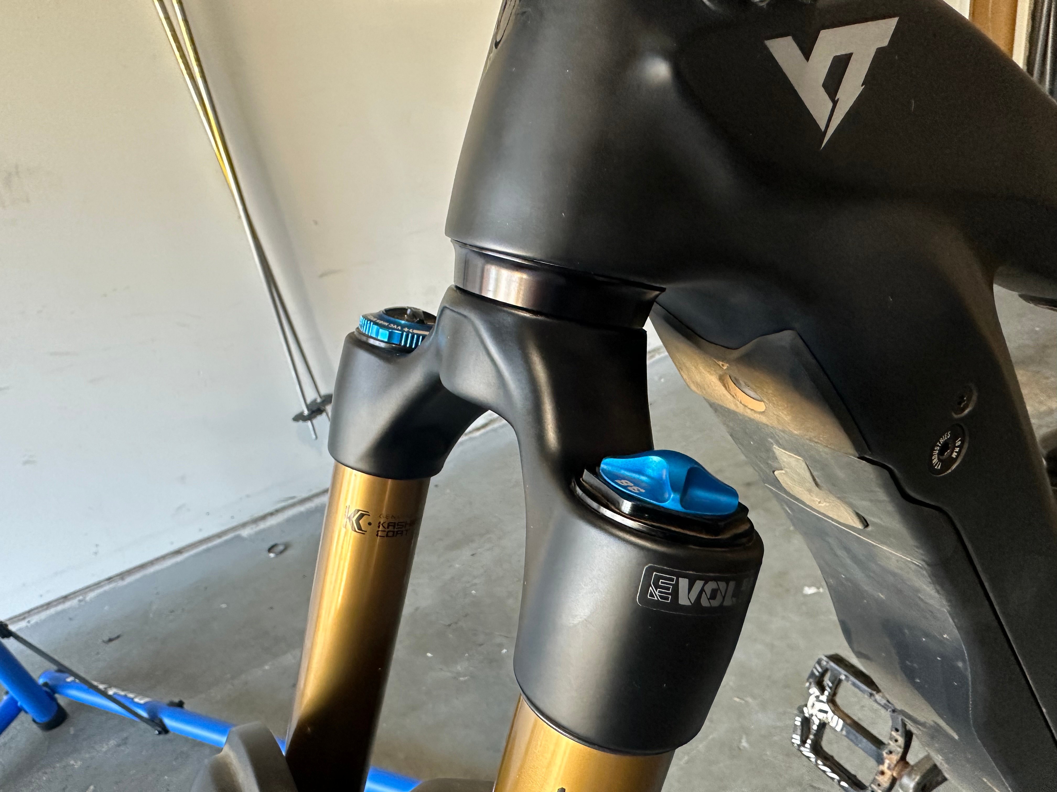

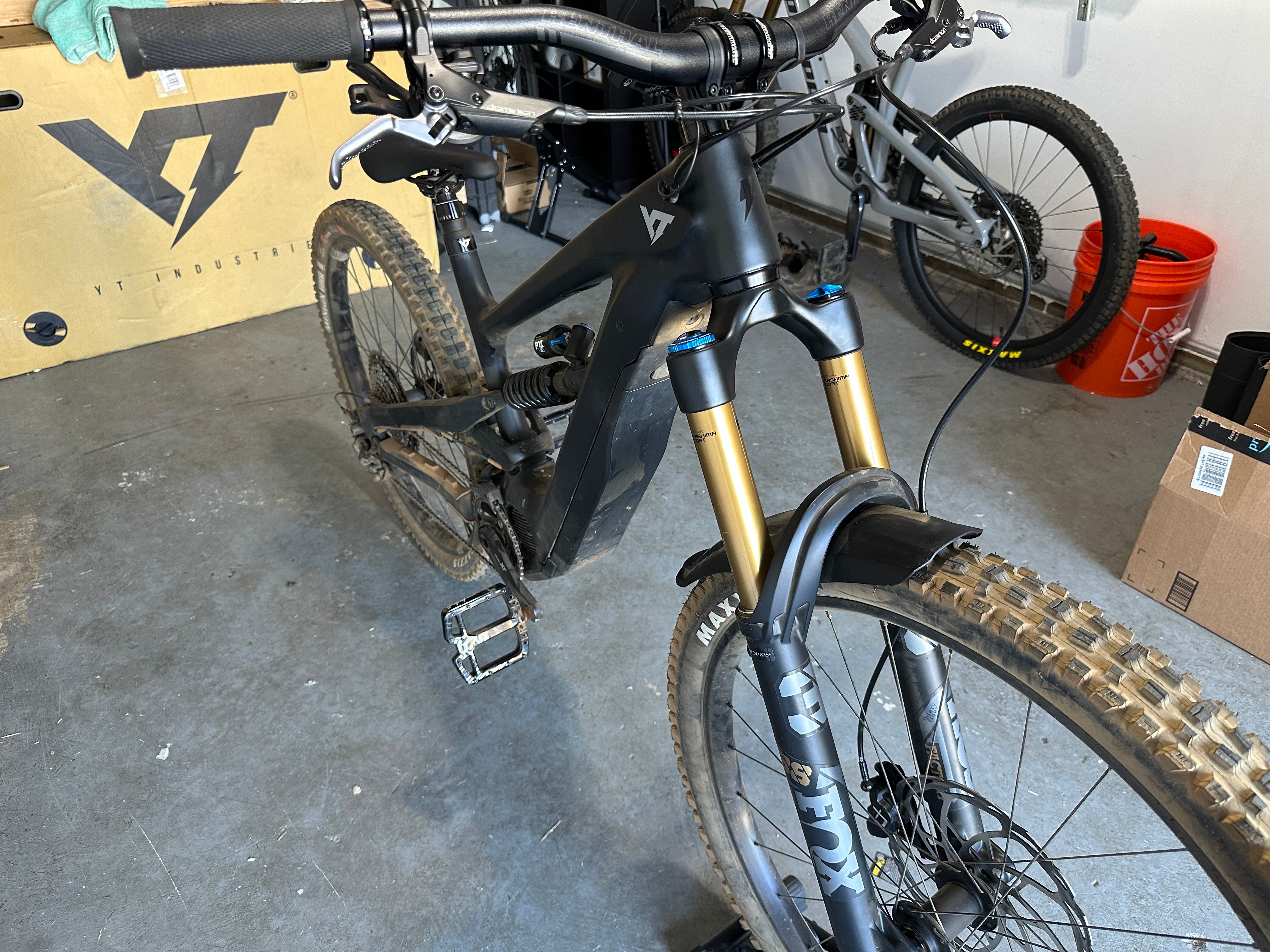

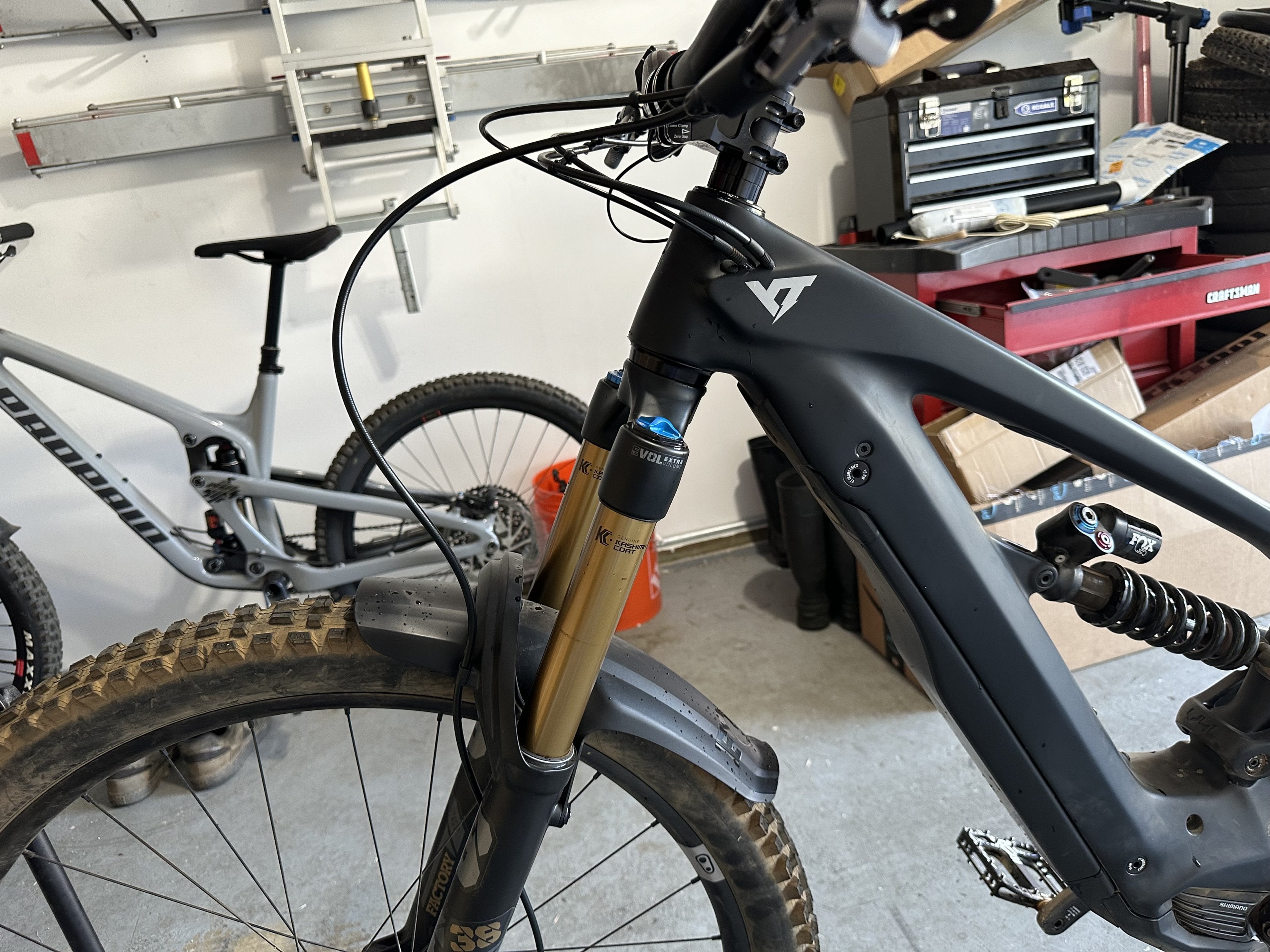

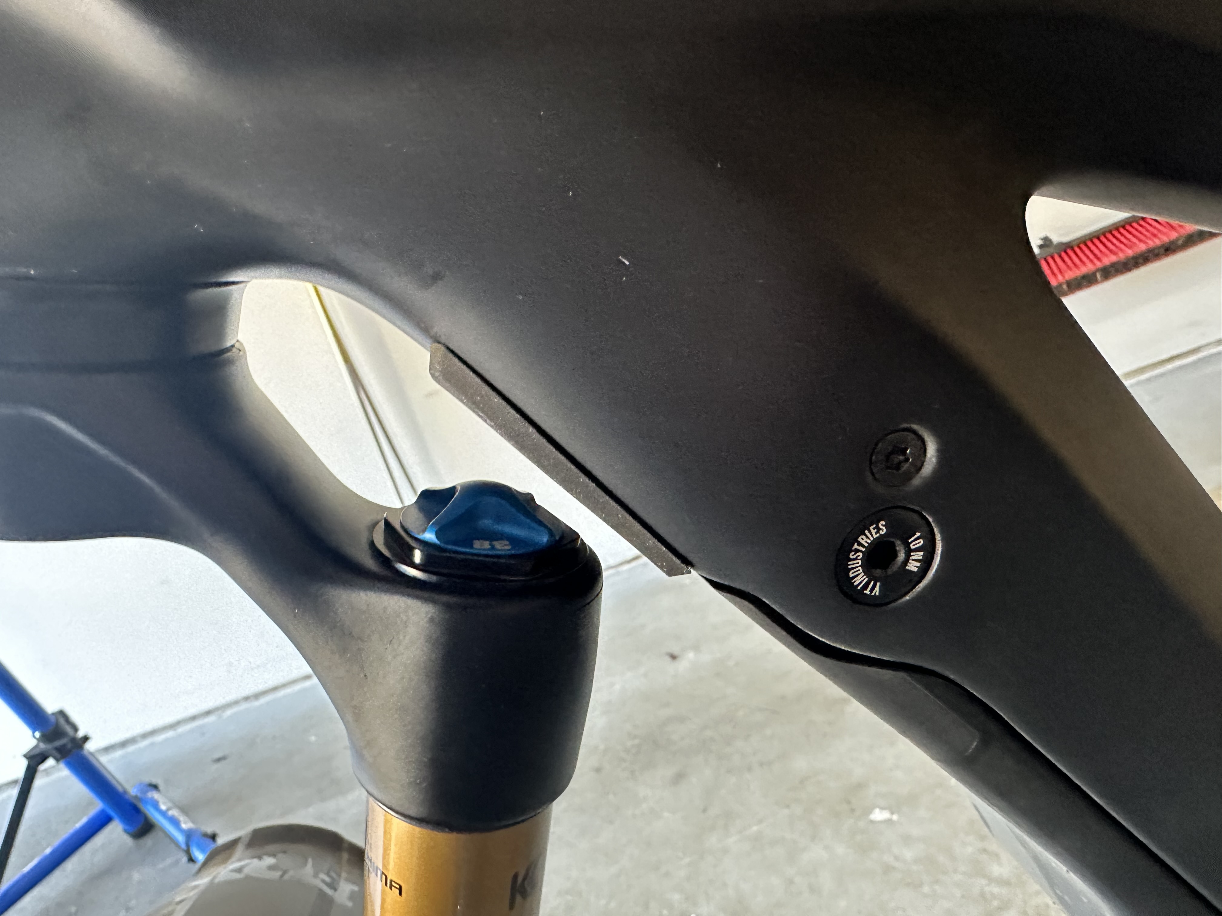

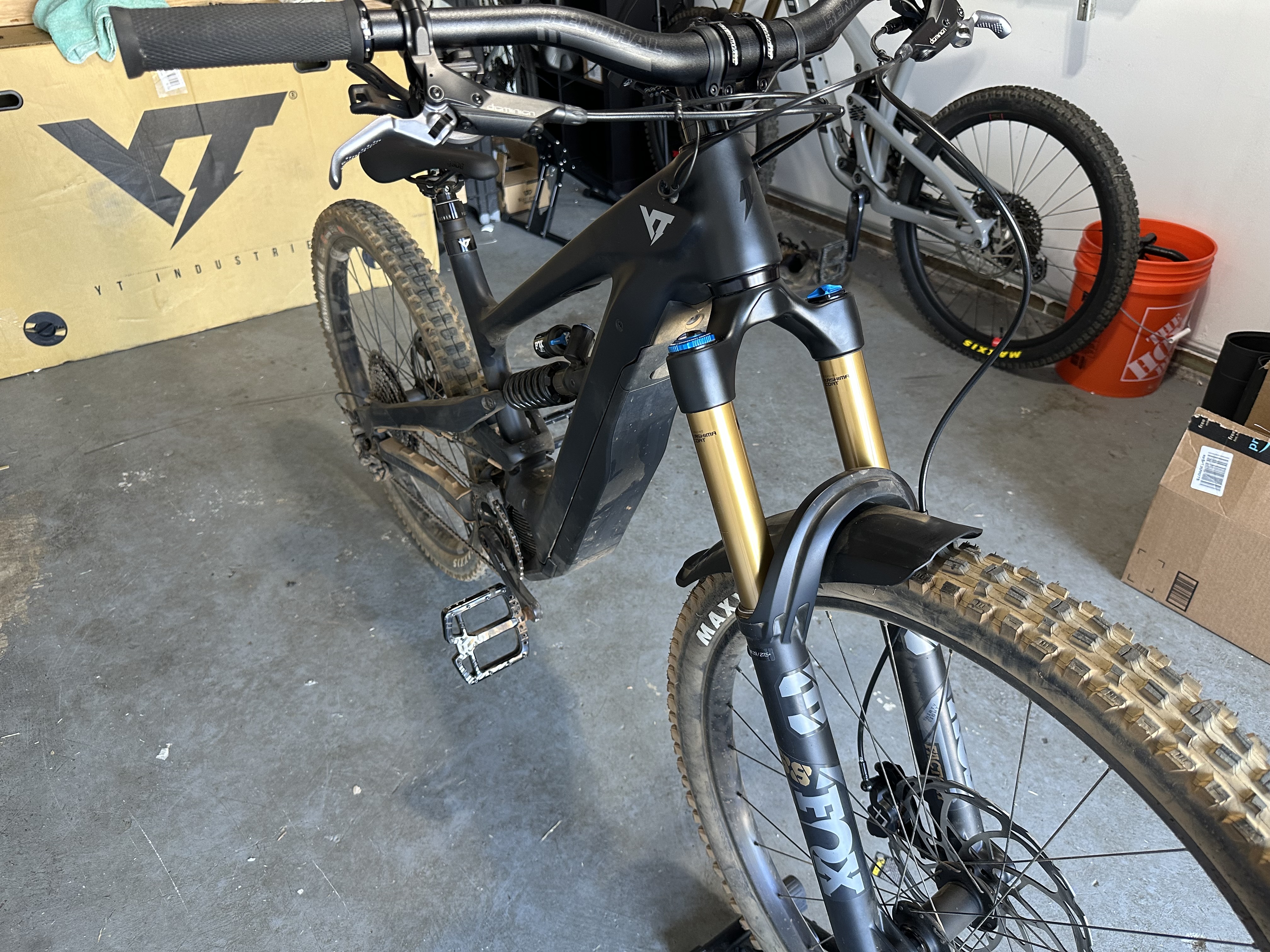

Hey all, just did the swap on my Medium Mx Core 4. The block lock crown race is an absolute PAIN to remove. Other than that the swap is very easy. I installed the wolf tooth 10mm lower, and a wolf tooth performance upper headset. The new headset looks great, feels super smooth, clears the frame on both the damper and air side on my Fox 38, and no more noise! Definitely worth the upgrade. I’ll include pictures below!
John_likes_bikes
Jul 17, 2024
22
25
california
View attachment 144148 View attachment 144149 View attachment 144150 View attachment 144151 View attachment 144152
Is this an OE fork or did you upgrade? There's still a lot of steer tube left for the stack height. Looks to me that if it was factory cut that 10mm from the bottom wouldn't leave that much steer tube left up top.
as123
Jun 17, 2024
11
8
Portland
Hey this is not an oe fork. I bought a core 4, but immediately upon receiving it swapped the Ohlins to Fox (38 and dhx2) and sold the Ohlins stuff.
Fortunately I like a long steerer, so I usually cut my forks with 3 10mm spacers under the stem. As you can see, adding the extended cup took away one 10mm spacer off the top. This Fork is cut right at 7 1/8 inch for reference , so it’s 0.625 inch longer than the stock 6 1/2 inch steerer that comes on a medium frame. 0.625 of an inch is roughly 15mm, so using the oe fork would work I think, just could only fit maybe a 5mm spacer under the stem. You could always swap out a stem with a low stack height (dmr defy for example) and gain some back though.
