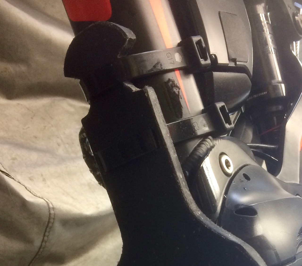

I posted this somewhere else. I took my cracked plate and layered it up with a carbon-fiber, kevlar weave using epoxy. It's been bulletproof ever since. There are some layer lines that I could have avoided since the weave was extremely malleable after it got wet with epoxy. I might someday put on another "finish" layer.
