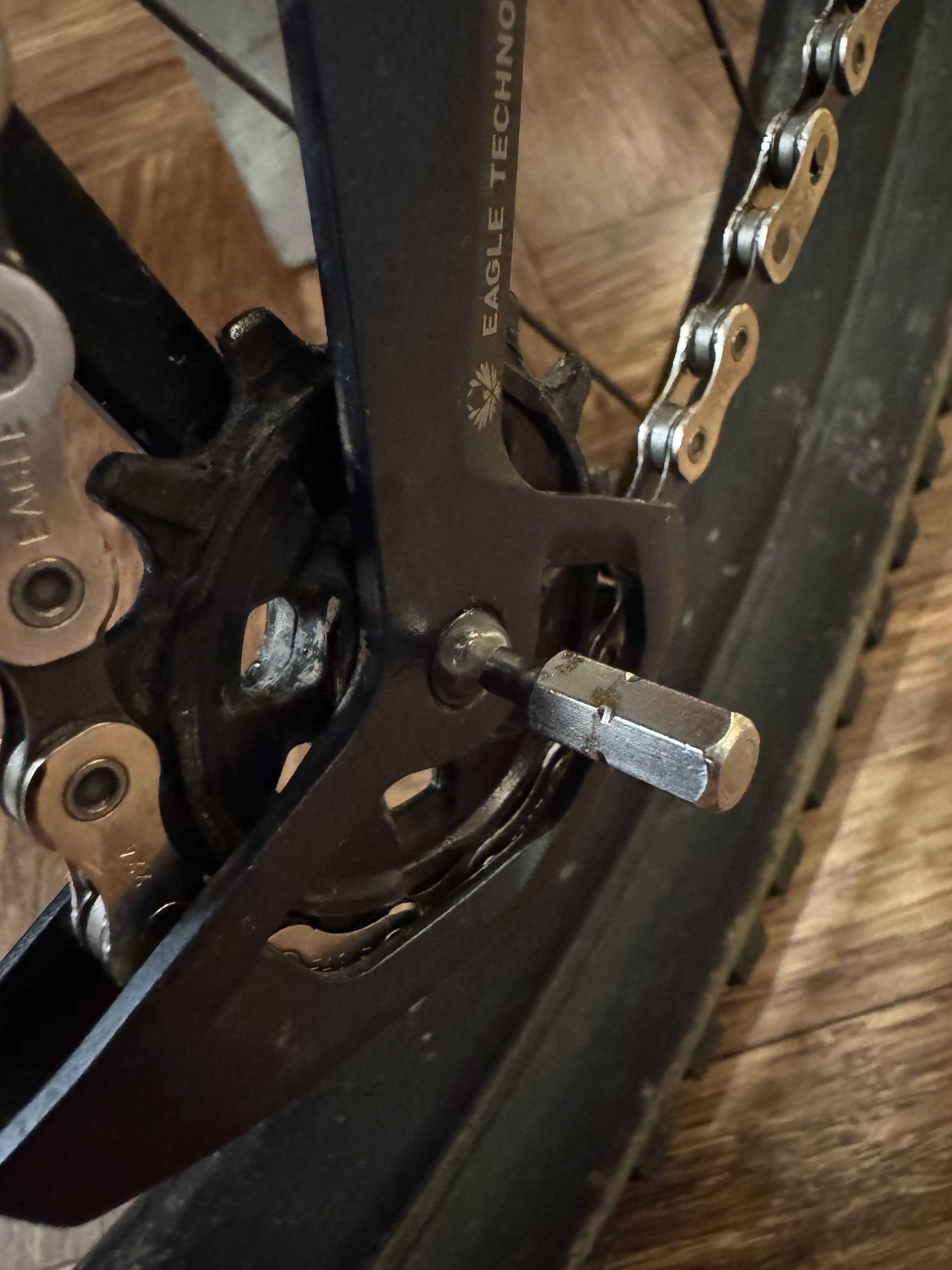

Hello - I am trying to get the bolt out from the lower pulley wheel, and it's stripped (I didn't change it last time, my FLBS did)
Anyway, I tried a load of methods, nothing worked, so I am going to epoxy an Allen key into it, which will get it out, but then I have no bolt to go back in.
I haven't got a replacement bolt 'cos I bought non SRAM wheels this time and they don;t come with one.
Any suggestions very welcomed

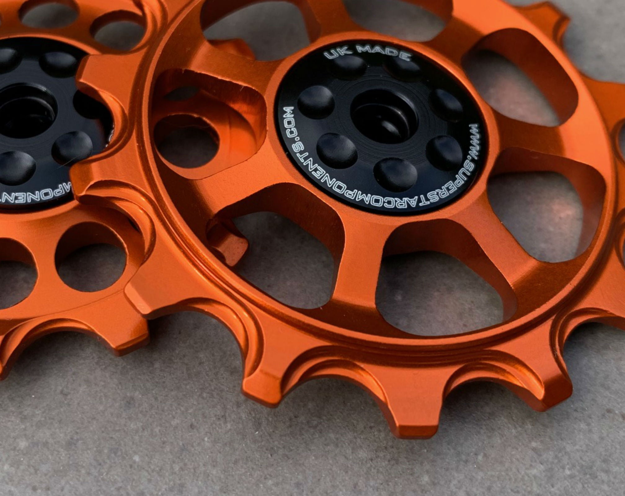

that is great huge thanks - however it's US site and the shipping to the UK brings it up to £24 and at that point I might as well buy a whole kit from SRAM!

it's their jockey wheels I am trying to fit!
They do not come with bolts so you have to supply your own or use the ones that came out :)

hmm...
I tried googling SRAM jockey wheel screw.
There's some cheaper ones on ebay etc.
or
1 x M5 x 13mm (upper) and 1 x M5 x 14.5 (lower) countersunk bolts
Perhaps you can find an M5 x 14.5 countersunk screw
Those Uberbike ones will do even if they are mad priced cheers - I did see a load on ebay but they all looked like cheap direct shipped Chinese crap, and a 14 day delivery time from mainland china!

Well. This better work….
