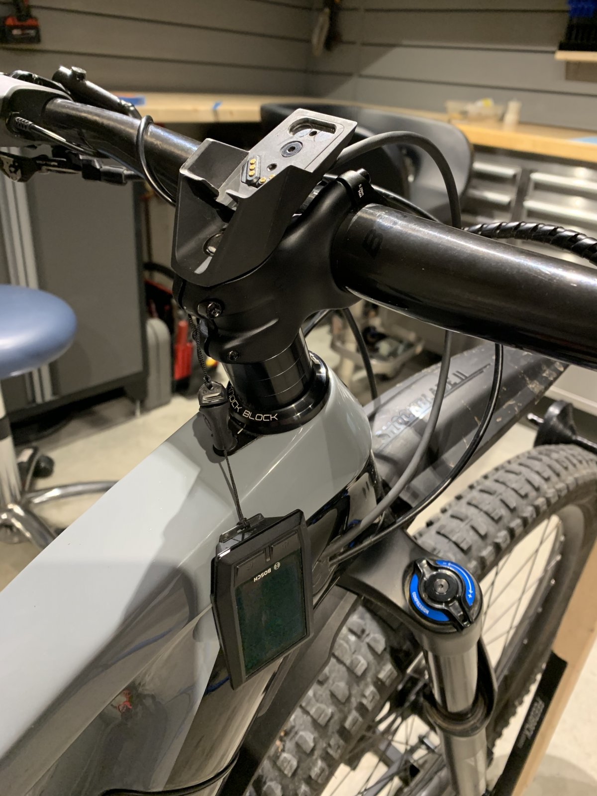

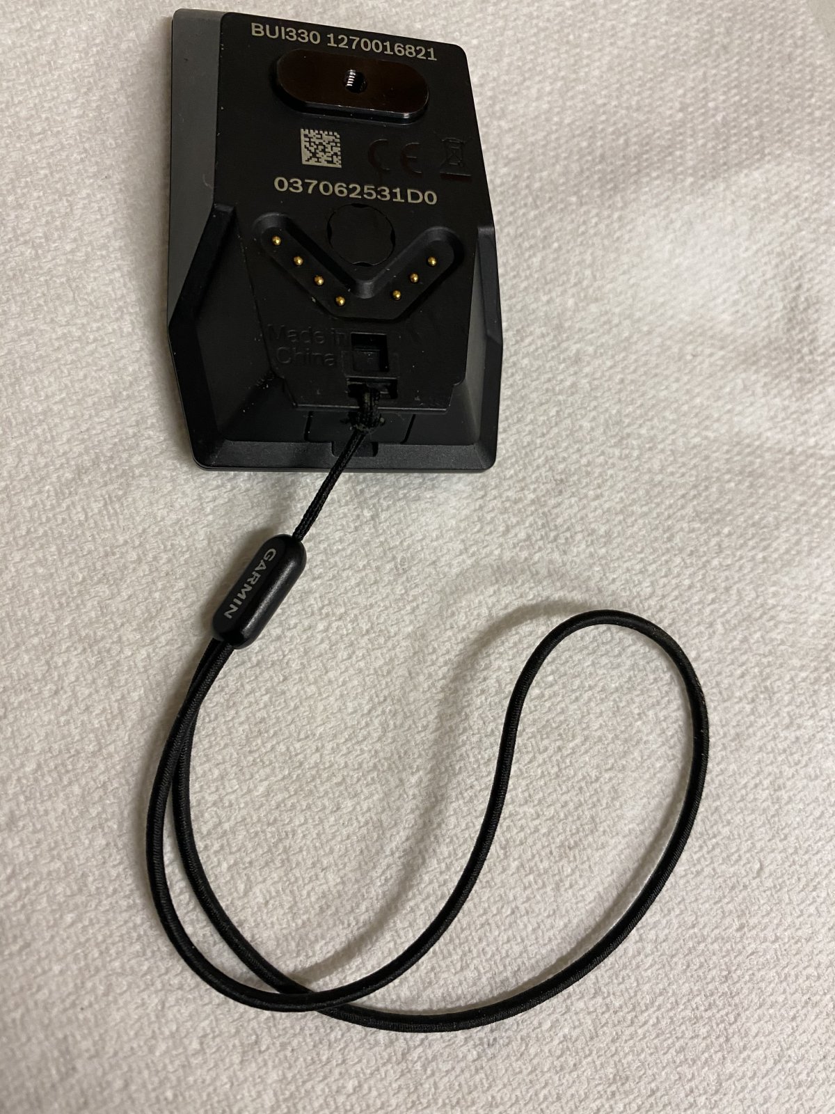

Lost mine second time out, fortunately managed to find after 20 minutes of searching in nettles.
Since the I’ve secured to the bike each time with an old garmin lanyard. D035A345-7F70-42D5-B02F-F4F6926B04CA.jpeg

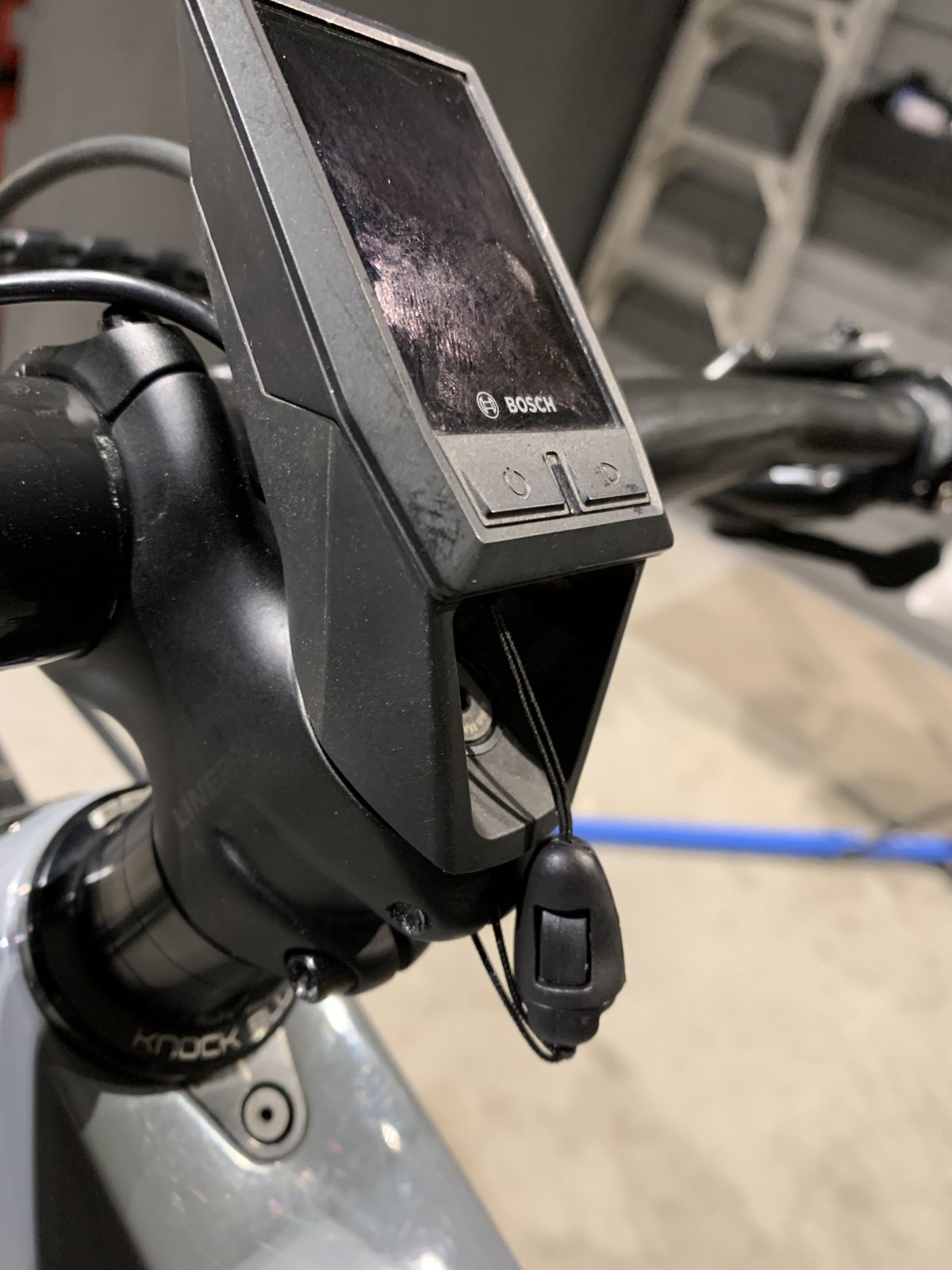

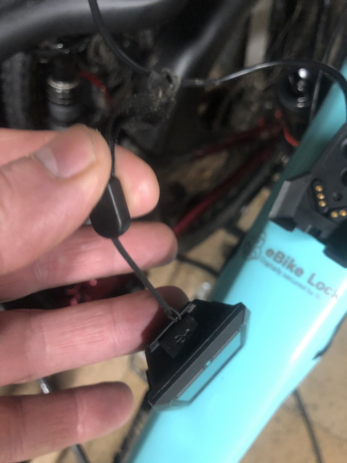

My Kiox flew off a few times. I like position of a stem mount and the magnets do their job during a crash. A simple tether or lanyard attached to the stem bolts and Kiox helps prevents the loss and ruining your day.
A plastic clip allows you to completely remove the Kiox.
No animals were hurt or holes drilled.
Since the I’ve secured to the bike each time with an old garmin lanyard. View attachment 43833 View attachment 43834
Thanks for the tip. Ordered a camera strap as soon as I saw this. Sure enough, out on a night ride, hit a big root and slid sideways. Managed to keep from going down, but started to pedal again and no power. Didn't even stop, just hooked the Kiox back up, put it in EMTB mode and kept on going. Brilliant idea that made my night....

Can’t you just put a screw/bolt in to fix it.
I could put a screw/bolt in to fix it but when I crash there could be a chance of the mount breaking. The Kiox can attach to the mount with the help of magnets. It can be removed easily or disconnects easily when knocked. A lanyard or tether helps keep the Kiox with the bike. A plastic clip or disconnect method allows the Kiox to be completely removed when I want.
I haven’t seen a commercial lanyard and clip, but for 99cents I can save $$$ for a replacement Kiox or a bad day.

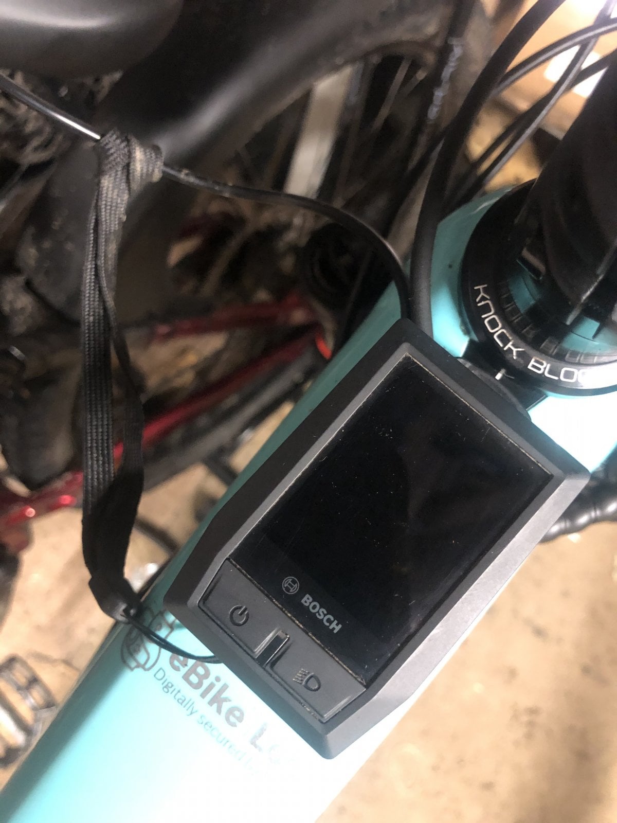

A lanyard is essential. Before I had one I lost mine in mud and leaves it was buried and took me over an hour to find it by re-tracing my route.
It flew off again yesterday but saved by the lanyard. I have it secured with a removable clip for security and downloads.

These are what you need...https://amzn.eu/d/0RO5eMp also one for each bike !
The bolt is secure but how to you plug it into your computer to download ? ...and the mounts do break..

Yeah, something like that. I took mine from a USB memory stick. There was a clip attached which allowed for complete removal of the Kiox whenever I needed to do that.
