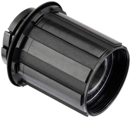

Looks like this. Came standard on the bike.

That's an HG freehub. If you can find one, a SRAM NX 12 speed cassette will fit.

That's HG. Not many 12-speed choices there that I know of if you don't want to stick with SunRace and don't want to change freehubs.
Garbaruk makes a 12-speed HG casssette that's supposed to be pretty good, but it's likely more than you're keen to spend.

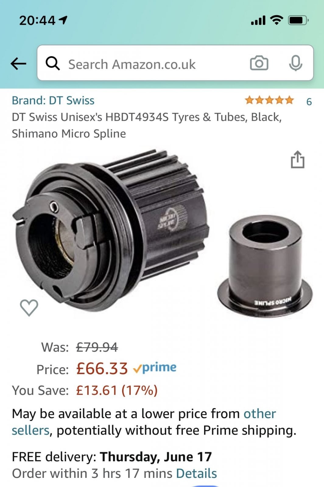

Ok, next issue is getting one? Let’s just say that I change to Shimano and change my Freehub. What one do I need? Is it this? Do I need a different end cap for boost wheels as is says 142mm ?

I'd suggest getting in touch with DT to make sure you're getting the right part number for your application. Amazon should be your last stop after you know the part number.

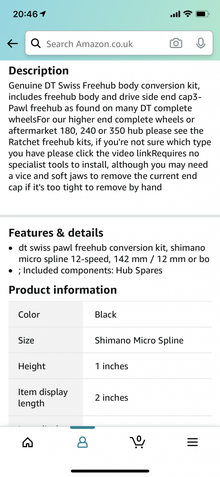

the description says 142/12mm OR Boost ( albeit most of the word boost is cut off).
Thanks. Why would Amazon be the last stop if they are selling the correct part at a cheaper price?
I wouldn't consider them a primary source for DT part numbers and information by a longshot. That said, if you're sure that's the correct part number for your application, then go for it.

you will see exactly the same description as the one you saw on Amazon, same picture etc on ebay and online bike shops. It is a DT Swiss kit. You will see on other ads it is described as suitable for 142 or boost which suggests the kit contains more than end cap.
It’s says boost or 142, but I take it the boost is what I need?

None of the listings I have seen offer a selection of either 142 or boost so I can only assume the kit comes with both end cap options....which is the only difference between 142 and 148 boost as far as the freehub is concerned.
I’ve ordered it twice and it comes with only one, which from previous comments must come with boost as it fits perfectly, and is not quick release ??‍♂️
