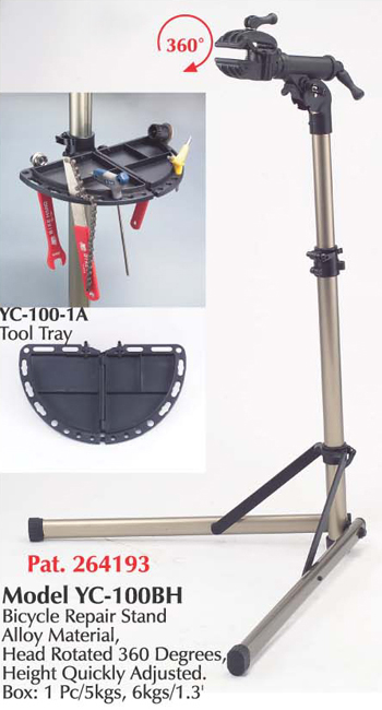

Maybe a Bike Repair Stand would make your life easier. Attached is a pic of the one I use. Park makes a similar one that's a little more expensive and a little nicer.
I'm sure it would and I have a Park stand but I would want something more portable for taking to the trail centre. I have to take the front wheel off in order to get the bike in the back of the car. It doesn't leave much room for such items.
