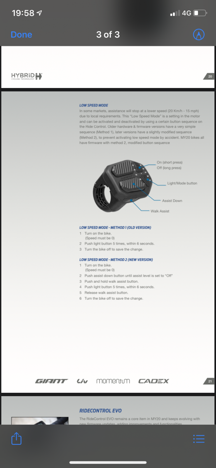

I think I may have missed something that was meant to be obvious, but...
The instructions show how to turn the Low Speed Mode - ON. So that would set the motor assist limit to 20kph (15mph) correct?
But how do you turn the Low Speed Mode - OFF, to remove the low speed restriction?
Assume it just alternates between the two ?‍♂️

Cubie
Feb 19, 2020
52
82
Fife, Scotland
From what I understand after playing around when I had my giant the number of times you press dictates what setting it goes into. 5 presses turns it off but for example 2 presses may make it a different location/speed.
