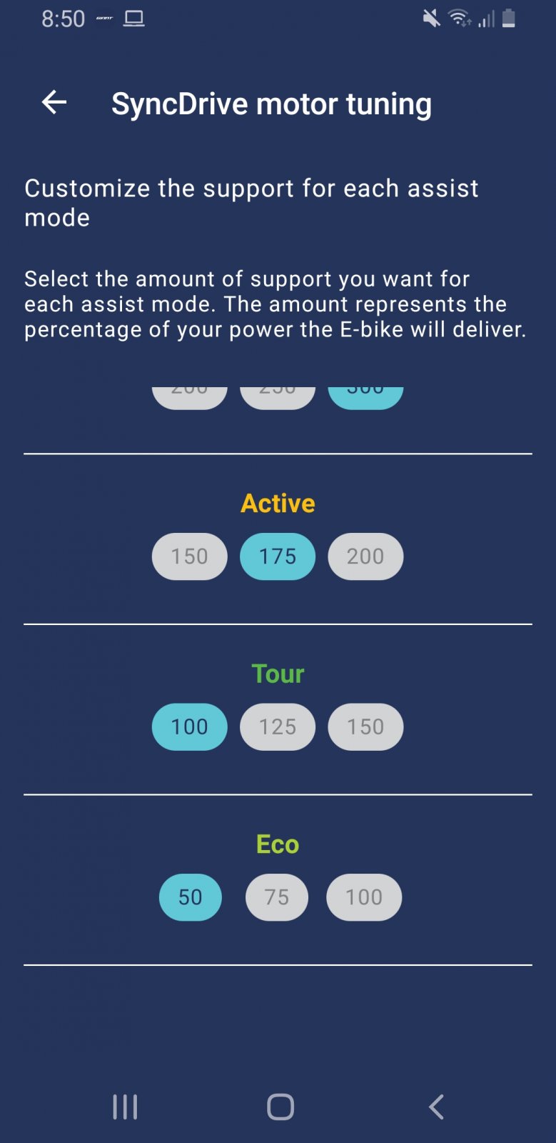

What do you mean by "tune the motor"?
De-restricting it to run it over 25km/h?
You know that Giant has an App and what's possible to control with it?
If you're not happy with it you better buy a Shimano
Thank you kindly for your considered response

I've read elsewhere that sometimes you need to turn off the bike after you changed otor settings.
I haven't faced it myself on any of my Giant bikes. What Software Version is installed on your bike?

i do like the idea of monitoring the battery. is there anything else you use it for? do you alter the power settings or are the 5 standard settings adequate for how you ride? what else does the app do?
Every now and then I'm checking if there are software updates available and check the stats of the bike. That's it.
99% of the time I leave it at the default settings. Only if I need to save battery as much as possible, I turn down level 1 and 2 one level.
Diagnostics, recording the ride....have a look at Giabts website or the app store to see the list of full features.
I've switched the bottom three power settings to minimum, left the fourth as it is, and boosted the top setting to max power.
Logic is that I'll never use the top setting unless I'm trying to accomplish something ridiculous and that I'm otherwise mainly using the bike to self-shuttle, so don't mind pedalling a bit longer at higher cadences in order to get more DH runs in per ride.
