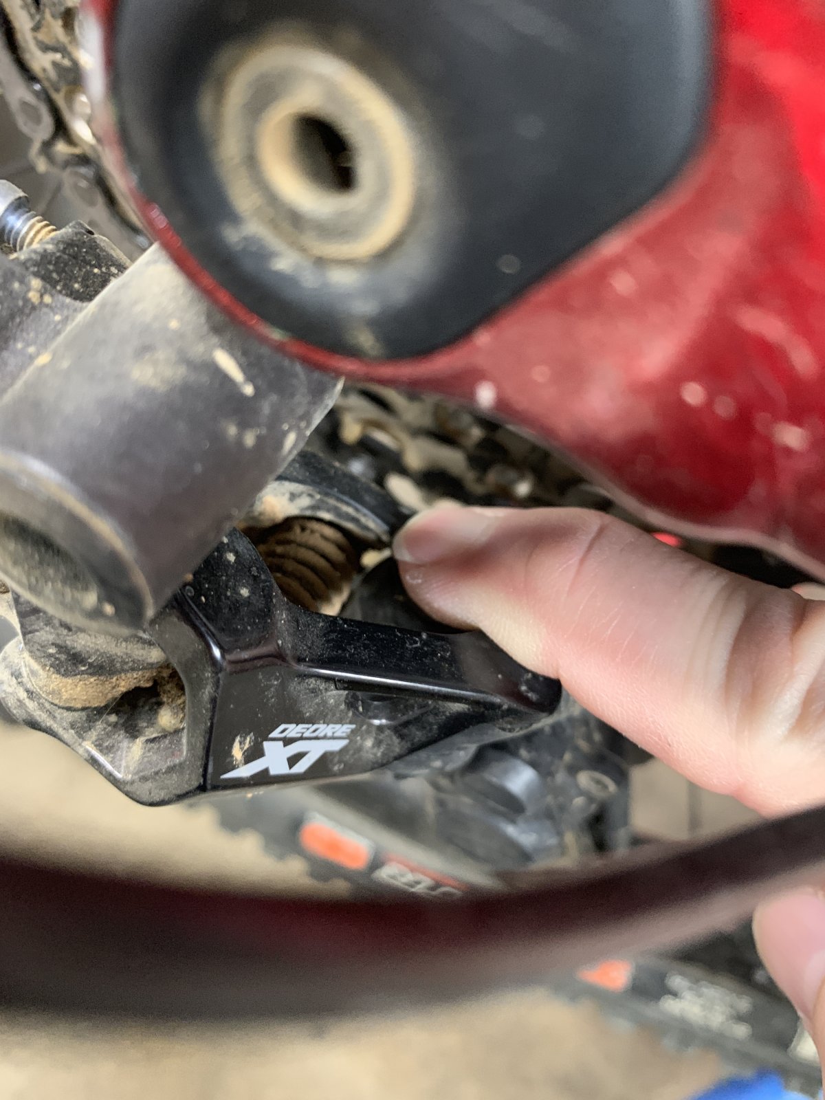

My kids just reminded me that when we first got our Reign, at about 100 miles, the derailleur had a crack in it and would flex and suddenly would not shift and would skip on the small gears. Giant replaced it under warranty and it has been great since. It was cracked where I’m pointing in the picture. And it wasn’t from impact damage.
