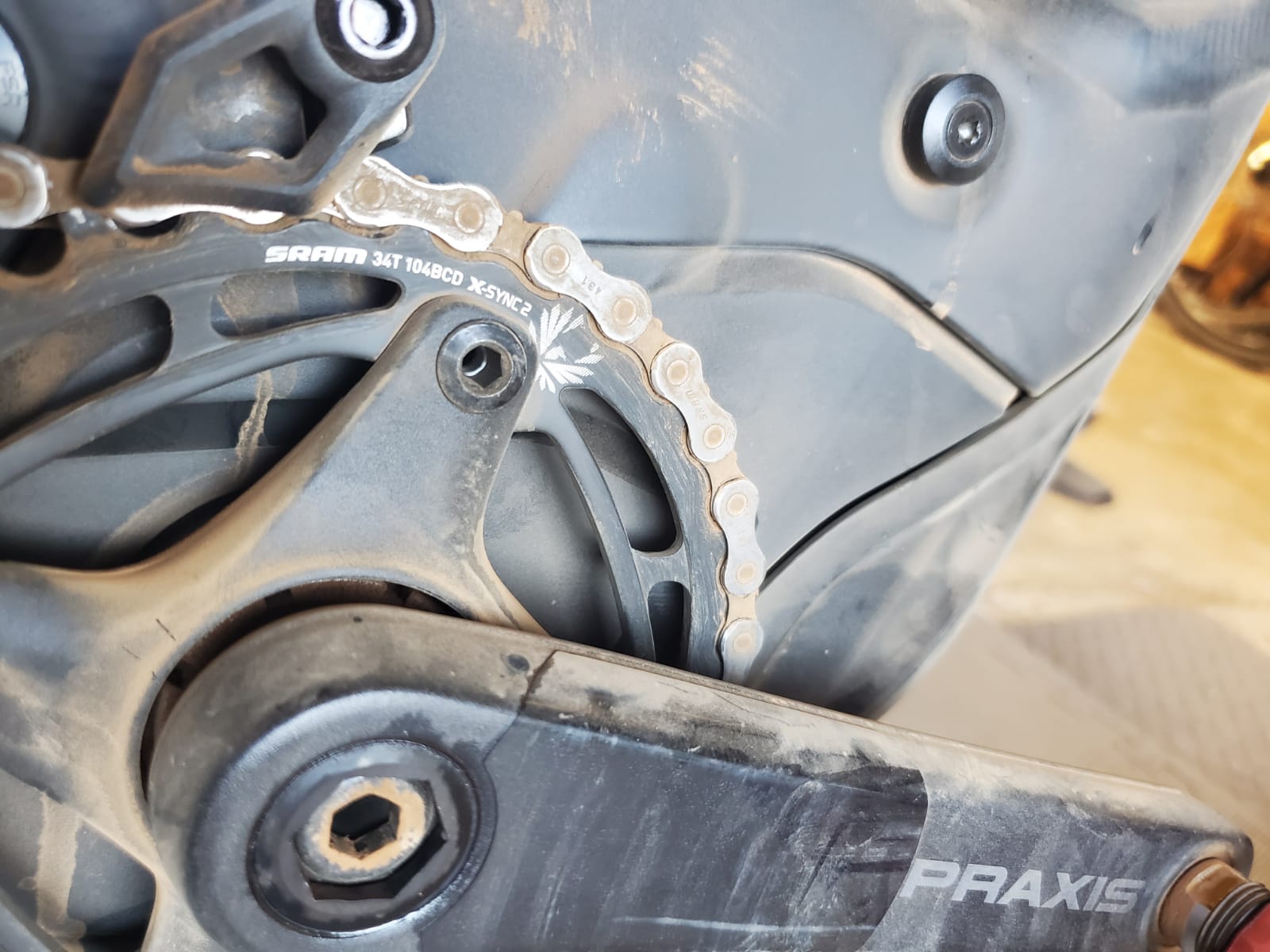

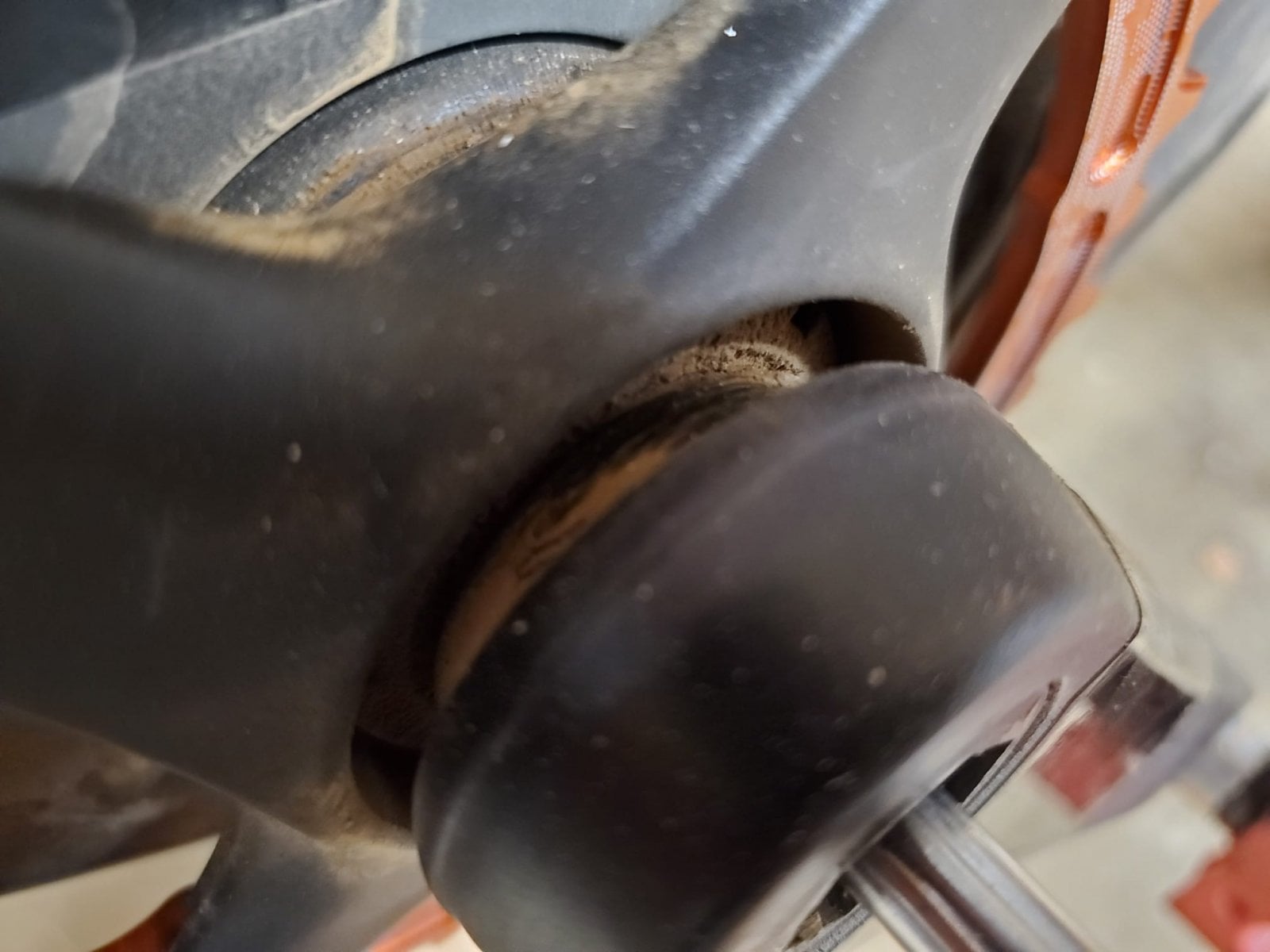

My bike looks like this after every ride:
Okay, this is more like three rides worth of dust. I bought some WD40 degreaser but it seems excessive for regular use. I also don't have much experience needing to clean drivetrains, I must confess on my regular hardtail I rarely bothered. Something about laying down $5+ grand makes you want to take care of your things better.
Can anyone with similar terrain and dust buildup tell me how they would do routine cleaning of the drivetrain? Most of the online videos seem to have more to do with mud buildup in wet climates.

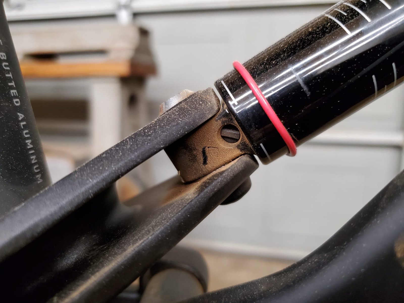

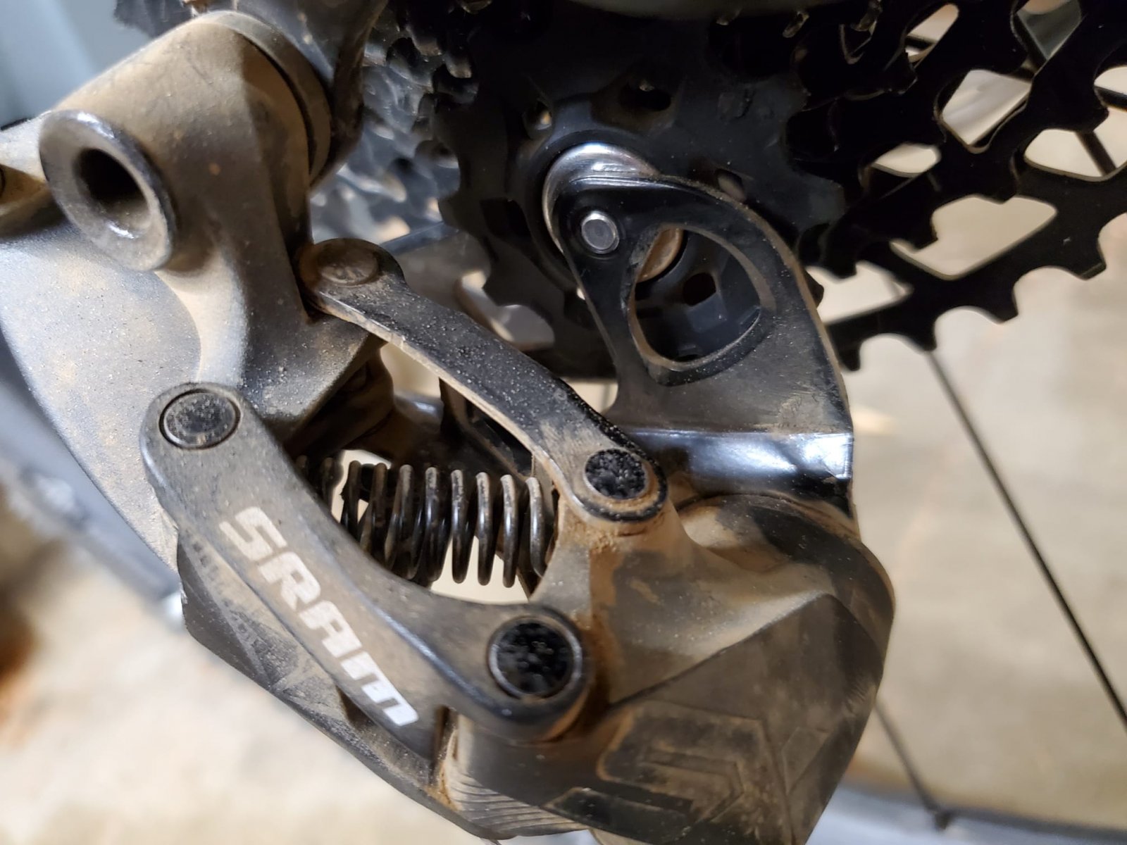

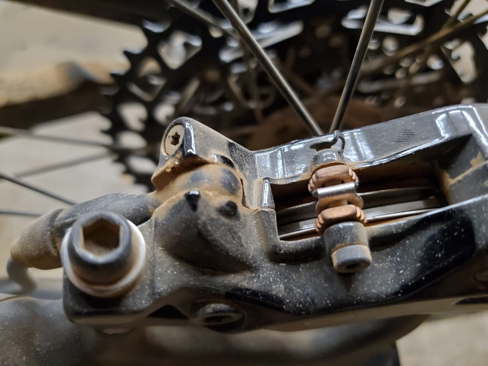

Alright I have a follow up question - some of you said you wouldn't bother cleaning the rest of the bike (aside from drivetrain and shocks) - so do you just ignore dust buildup in, say, all the odd nooks and crannies. For example today I changed my chainring and there's plenty of dust sort of sitting at the interface of the crank arm and the chainring. Same with all the pivot points for the suspension. Just let it be? Rely on the seals?
Every once in a while I use a couple of damp microfiber cloths, an old toothbrush, yellow muc-off degreaser, silicone oil spray and a 3 liter bucket of water.
The area of the record pads I use record cleaning spray and kitchen paper.
I never grease the crankshaft/motor shaft.
Greetings.

Every once in a while I use a couple of damp microfiber cloths, an old toothbrush, yellow muc-off degreaser, silicone oil spray and a 3 liter bucket of water. The area of the record pads I use record cleaning spray and kitchen paper. I never grease the crankshaft/motor shaft. Greetings.
What is the silicone oil spray for?
Also, record pads? Brake pads?
