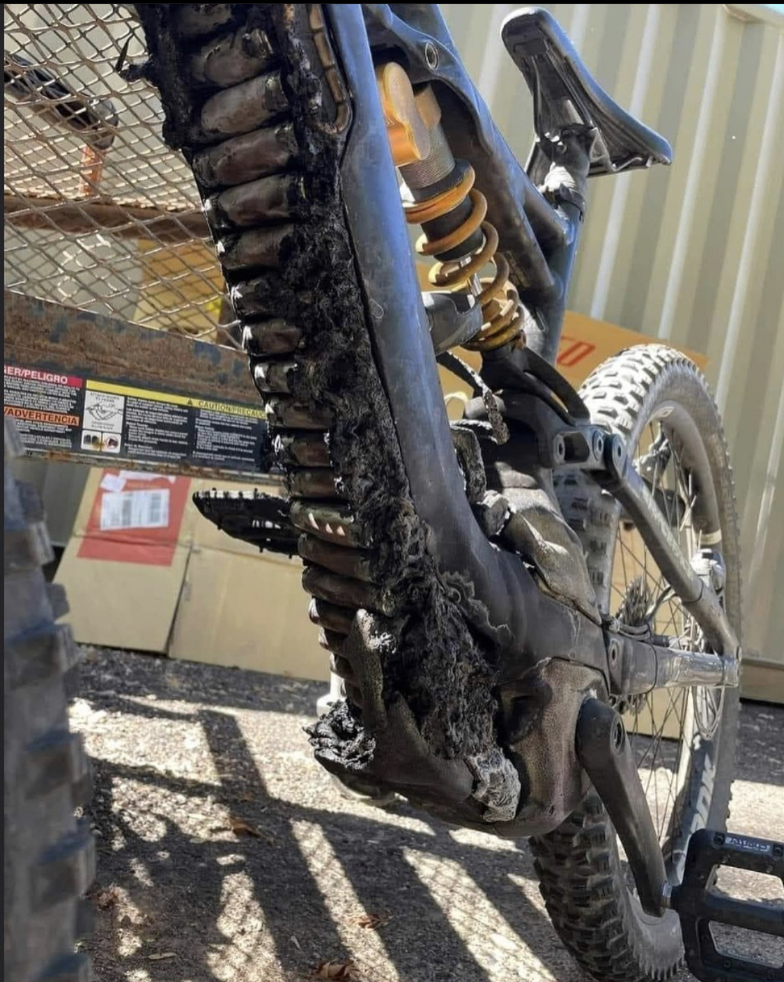

Hi @Manfred and thanks for the namecheck here. You are right - only some battery packs have been recalled. For the benefit of future readers of this post, please check our Safety Notices page as the source of truth - information to identify affected batteries and guide riders to next steps can be found there. Let me answer your specific question below...
Why are only certain battery packs recalled?
All our battery packs are custom designed and include a state-of-the-art and complex battery management system. For a thermal runaway event to occur, a number of specific conditions need to be present together (not just a loose control pad) making this a rare event. Those conditions could potentially be present in the battery packs included in this recall. If your battery pack does not fall within those parameters, it does not need to be repaired.
.... however
your examples clearly show batteries where the glue around the control pad has failed and are outside of the recall scope.
What if I have a battery that is not within the scope of this recall but has a control pad that does not appear fully sealed?
This should not cause concern, only the batteries listed at our Safety Notices page are at risk. However it makes good sense to seal any battery pack with a loose control pad. Contact your nearest authorized Specialized Turbo retailer - they will be able to check and seal it for you if necessary without cost.
So the the answer to your question is "NO, we're not missing battery PN or date codes" - only those battery packs at risk have been recalled.
