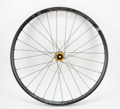

If rebuilding the wheel an FR560 would be an excellent choice however it has 32 spokes where your wheel has 28.
Not sure any of the bontrager wheels have a great reputation, so if purchasing a built wheel I would look at other brands.
These would be good built rear wheels...

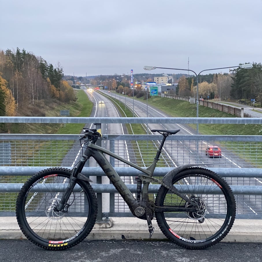

Just bought a new wheelset for Rail 5. The FR560 seems to be the hardest aluminium rim from DT Swiss.
  • DT Swiss FR 560 29" rims 32 spokes
  • DT Swiss rear 240s 148x12 boost hub, shimano 8-11 speed freehub. Star ratchet 36t system
  • DT Swiss front 350 110x15 boost hub
  • DT Swiss Competition black spokes
  • DT Swiss brass squorx black nipples
Price was 500€ + postage at Sklep internetowy

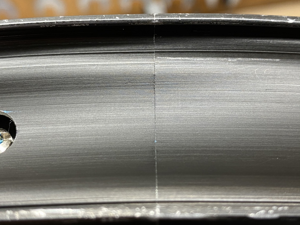

In Rail Alex MD35 the problem with rearwheel was that the rim is not welded AND I do ride off the roads.
