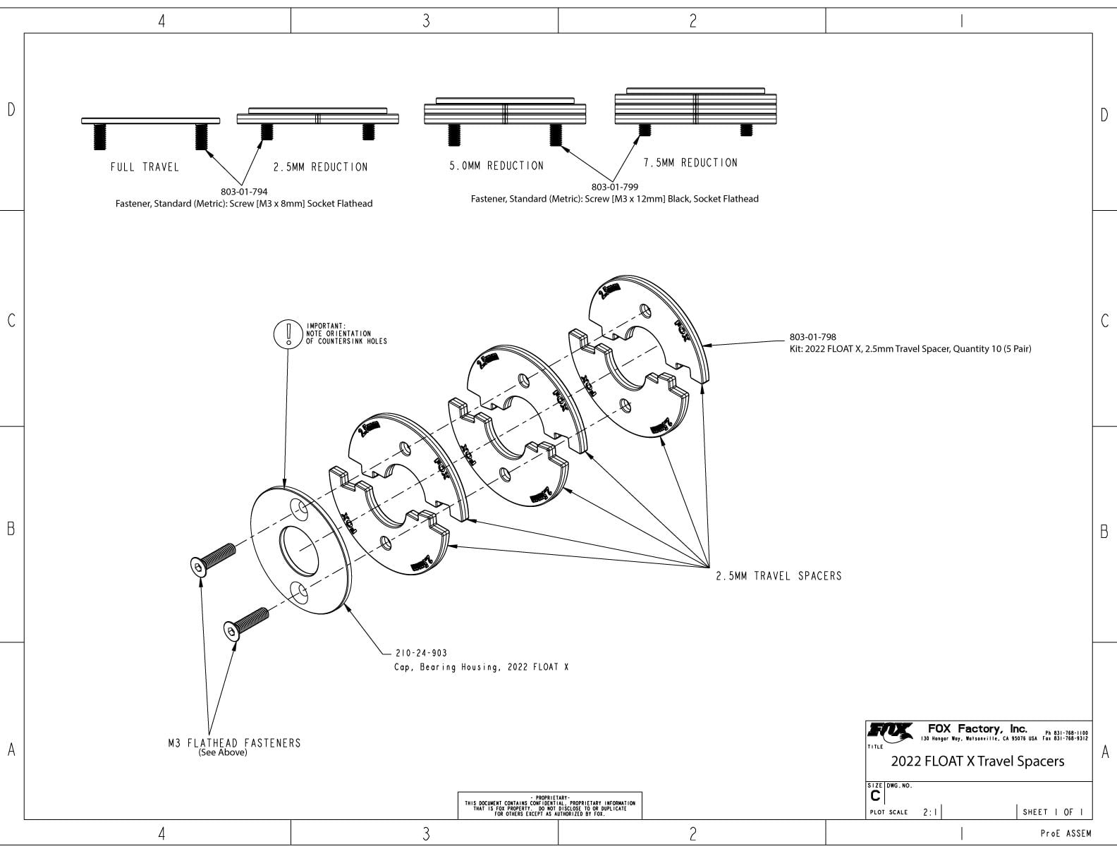

Sorted, Marzocchi Bomber Air and Fox Float X share the same stroke travel spacers. They are not the same as the 0.1" volume reducers found in the volume reducer kits. The correct ones are 2.5mm in thickness (like the 0.1" volume reducers) but are split and held in place by 2 M3 screws on the piston head (which also will need changing for longer M3 X 12 csk set screws as called for by Fox/Marzocchi in the tech diagram (last pic, call out at top of of diagram).
Available on eBay by the seller Trail Forge (a very helpful guy) and listed as... Fox Float X Travel Spacers 2.5mm - Set - MY2022-2025 - 803-01-798 - 233-00-444
Someone else might find this useful.
