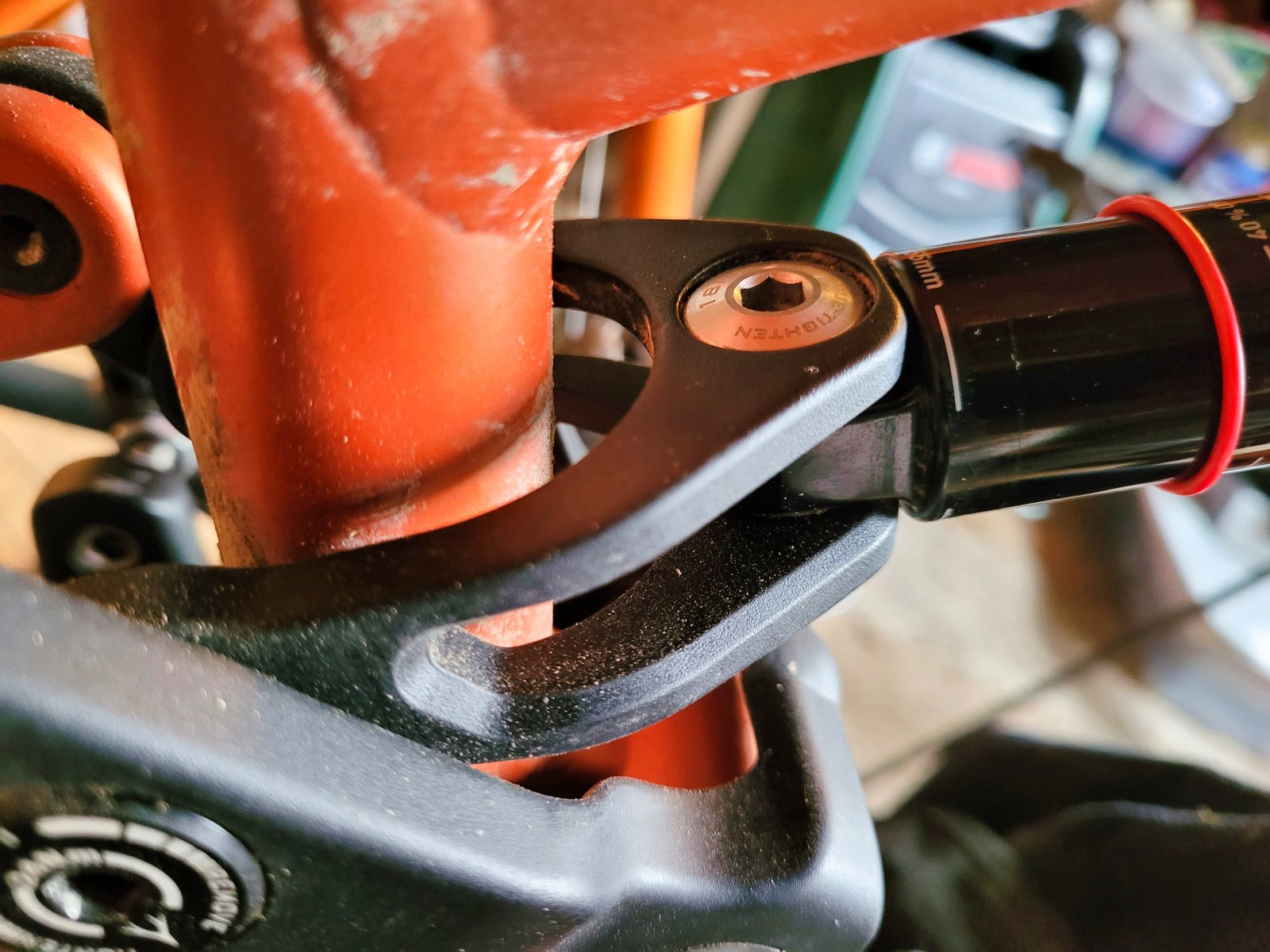

Time for a bit of TLC for my rear shock. Had a look last night, the rear shock mount doesn't have enough clearance for a wrench/socket. Does the yoke have to come off too or have I missed something 🤔

Ta. Yes, once the front is undone, it pivots down a bit. Still a bit tight for a torque wrench though when putting it back on. One downside of a shock extender I guess, dead easy on the other bikes.

Deflate the shock and compress it. Gives clearance to get a torque wrench in.
Easy to remove and refit yoke though, although getting the shock back into the yoke is a complete ball ache. There is a crappy little washer that goes under the shock that makes it hard to lineup the bolt.
