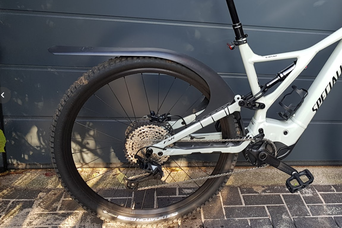

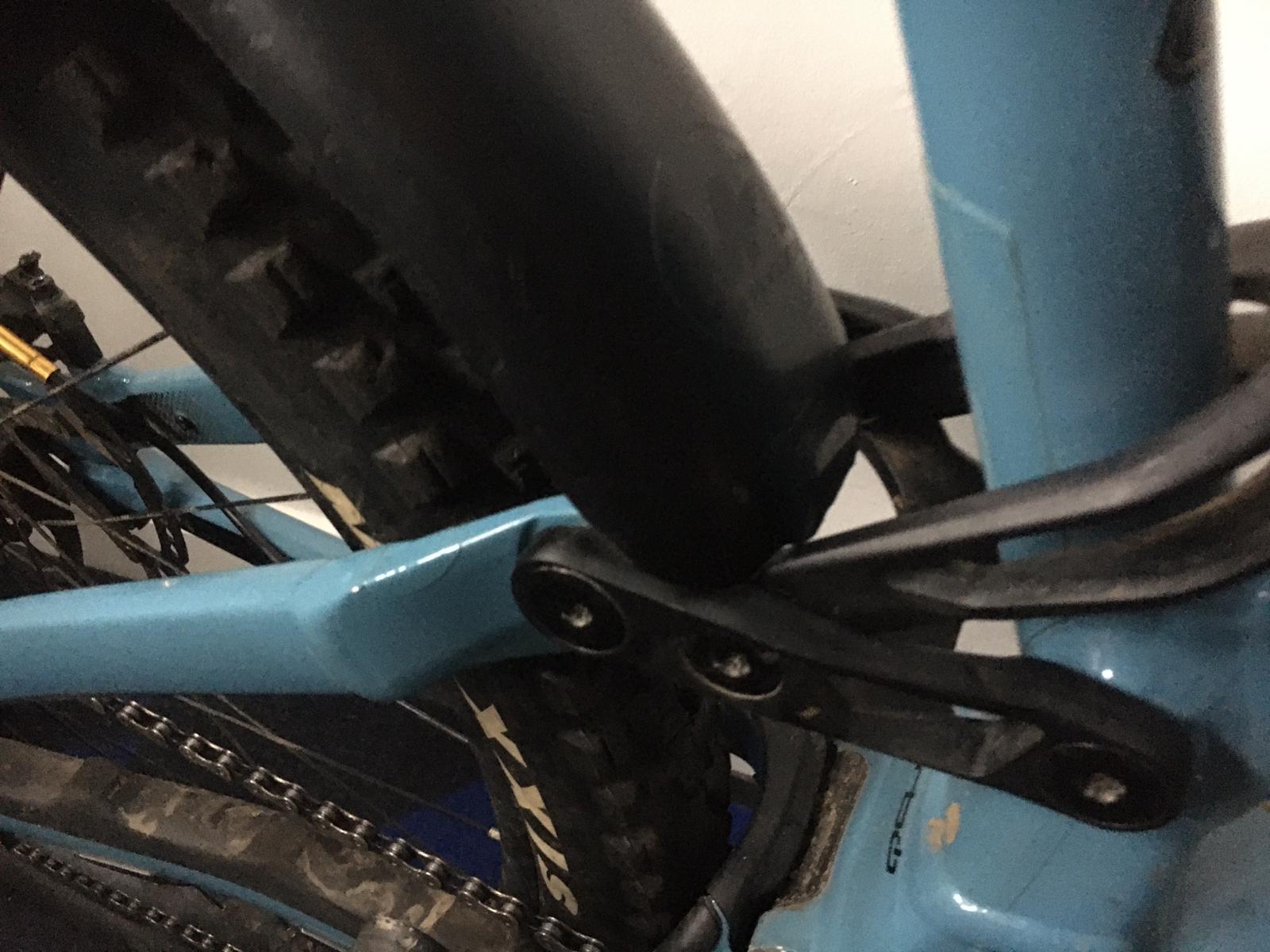

Check this website. I have one on my Levo 2020. Levo is not the easiest to fit a mud guard.
The sicomtb mud guard protects to a certain degree.

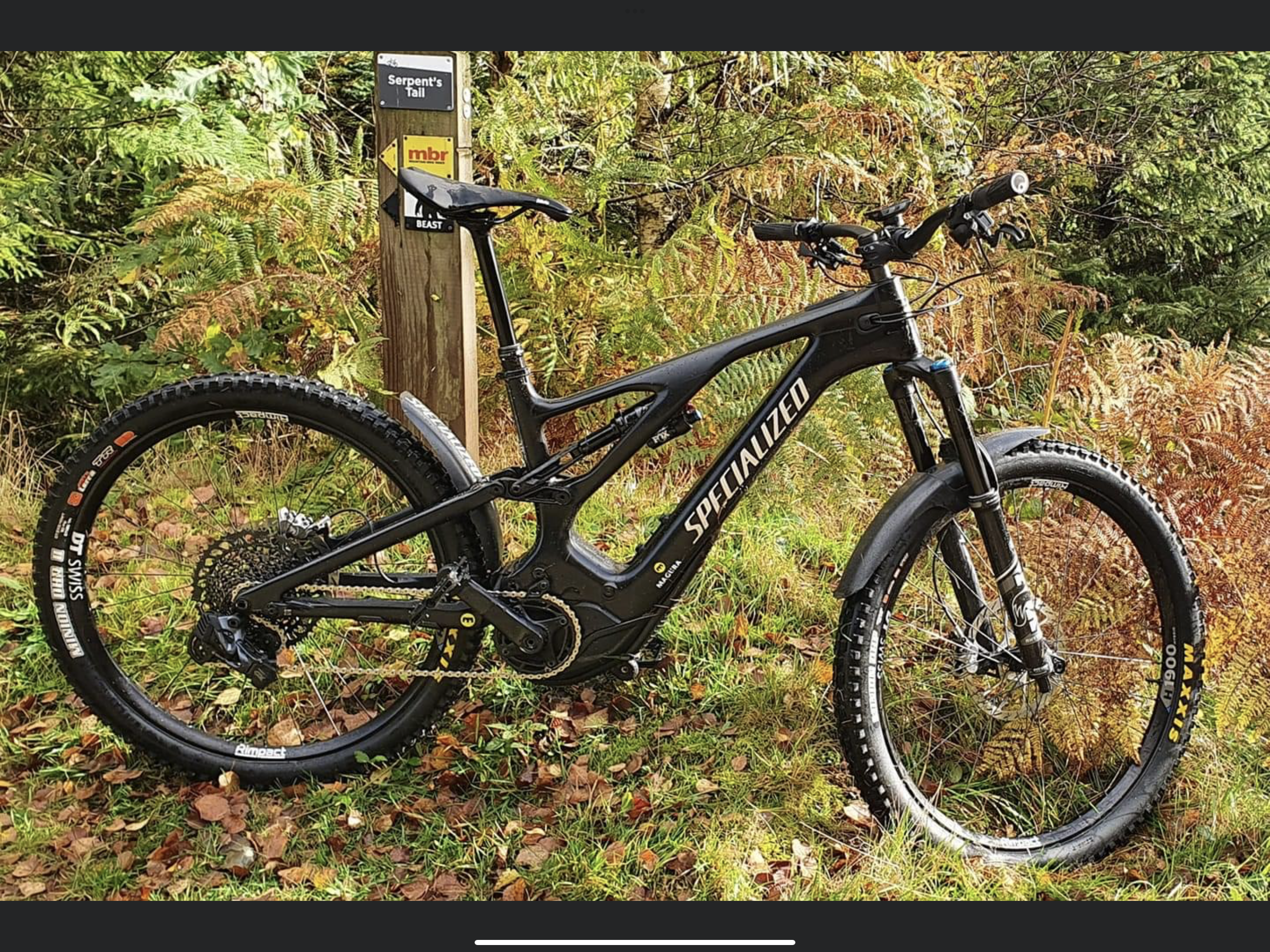

I've got the Sicomtb and mudhugger on mine (it gets bloody muddy around here). Some might say it's OTT, but it works fine for me.

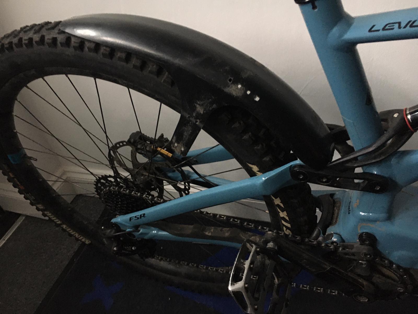

I may have offered this information before??

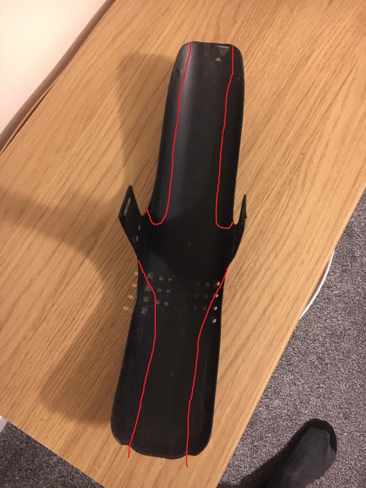

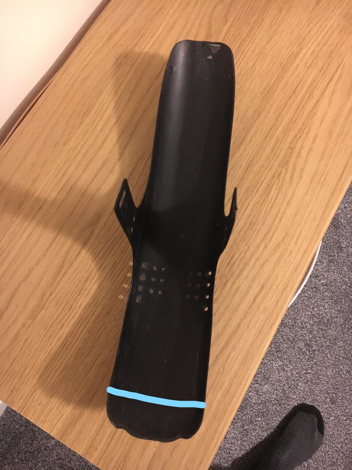

On my Levo I have the Mudhugger front mudguard fitted on the rear...plus the Mudhugger extension. Cost is c £30 for the mudguard plus extension piece. To fit it to the rear it just requires shortening slightly. Use some strong scissors to cut midway across the Mudhugger insignia. That end of the mudguard will then fit very close to the cross member between the chainstays.
The combo will protect the shock, pivot bearings, and dropper and prevent mud going down between the chainstay cross member and motor.
It will not totally protect your backside/back. For lockdown xc type rides I supplement it with a cheapo "Ass saver" just push fitted under the saddle.

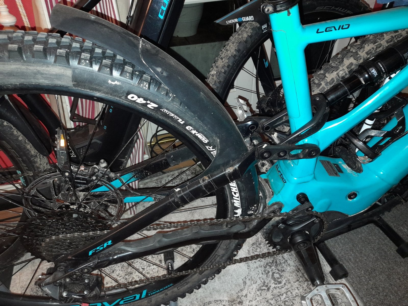

Topeak defender xc here ( with a perma fitted zippy on short mudguard rrp
DEFENDER™ XC1 / XC11
fyi - std 29 butcher tyres(so very limited clearance) and close fitting mudguards + the right (*or wrong) type of mud = wheel lock(*both wheels, totally and utterly)
luckily my previous ebike spare winter wheels fitted and were 27.5 / maxxis shorty, so I’m using them - no more mud lock ever

I bought a rear mudguard from central coast bikes. It's just enough to stop mud building up on the lower pivot area. It uses two existing bolts at the bottom of the motor housing. I have also added a mudhugger for the winter to prevent me getting caked in mud.

No. It is only cut to shorten it a little. The FRX has the mudhugger badge on one end. I cut that end so the mudguard finished directly in line with chainstay cross member. You can have it going down between that cross member and the tyre but I find that leaves too little clearance.
This video from the Mudhugger site shows you how.

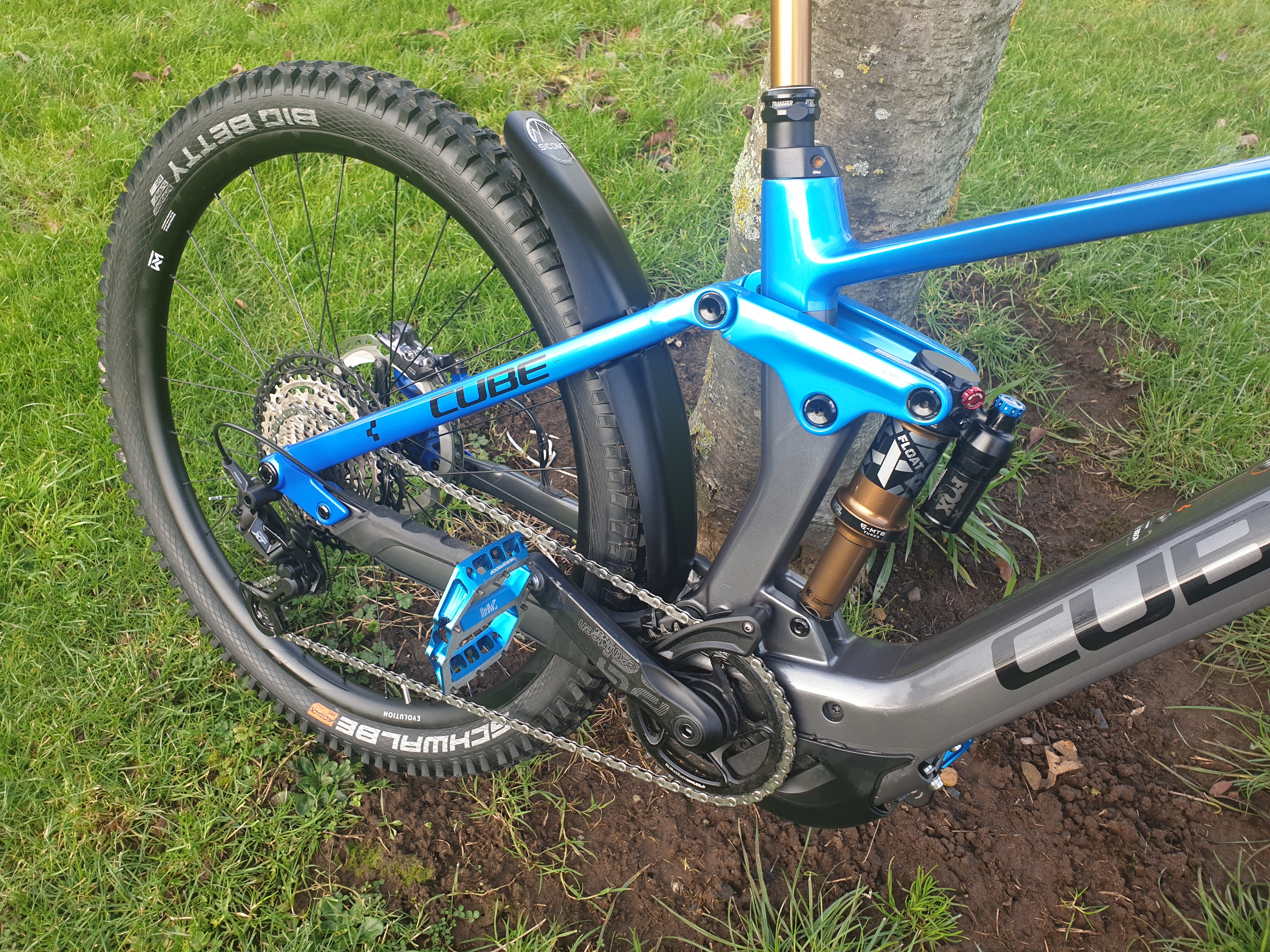

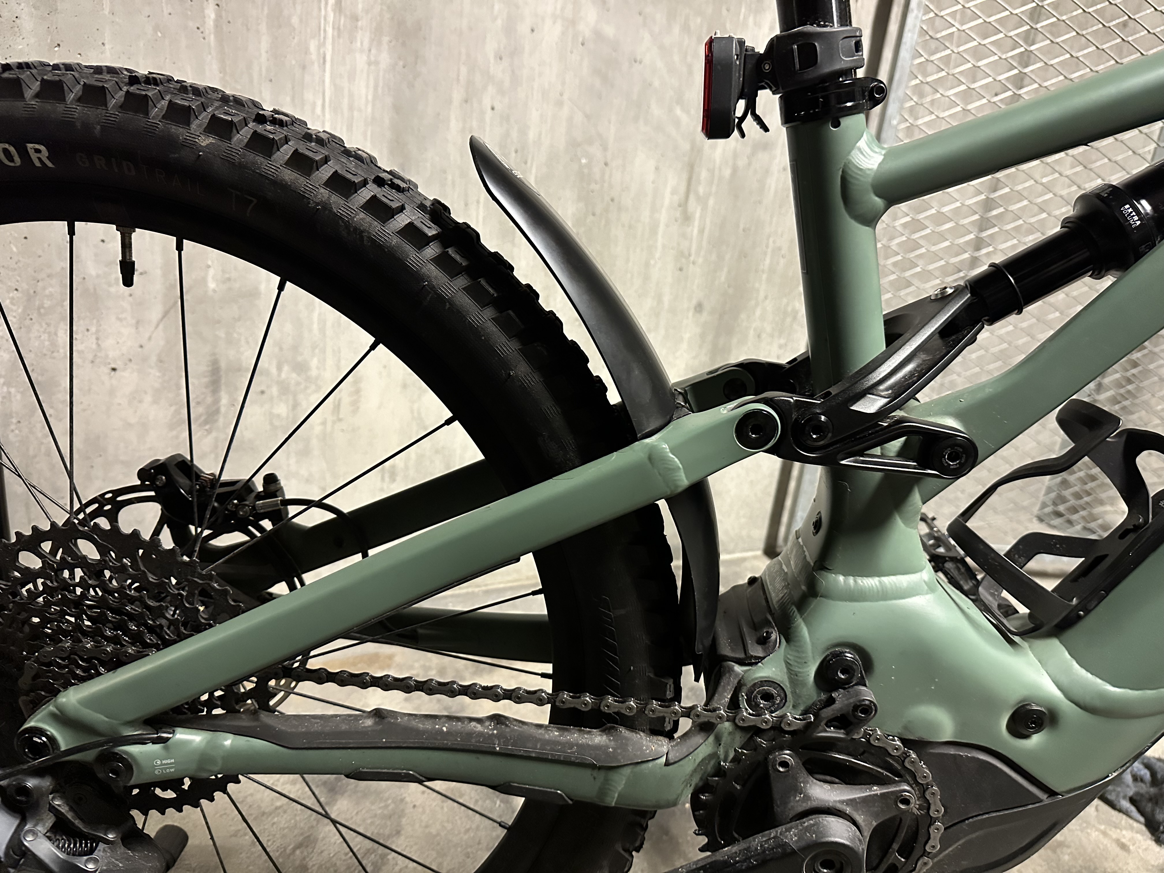

After reading this thread I have just bought a Sicomtbproducts rear mudguard for my 2022 Cube stereo hybrid and I'm over the moon with the fit as it goes right down to pivot point giving it protection
I did put some double sided tape onto the frame as it was rotating on the cable ties slightly but solid as a rock now

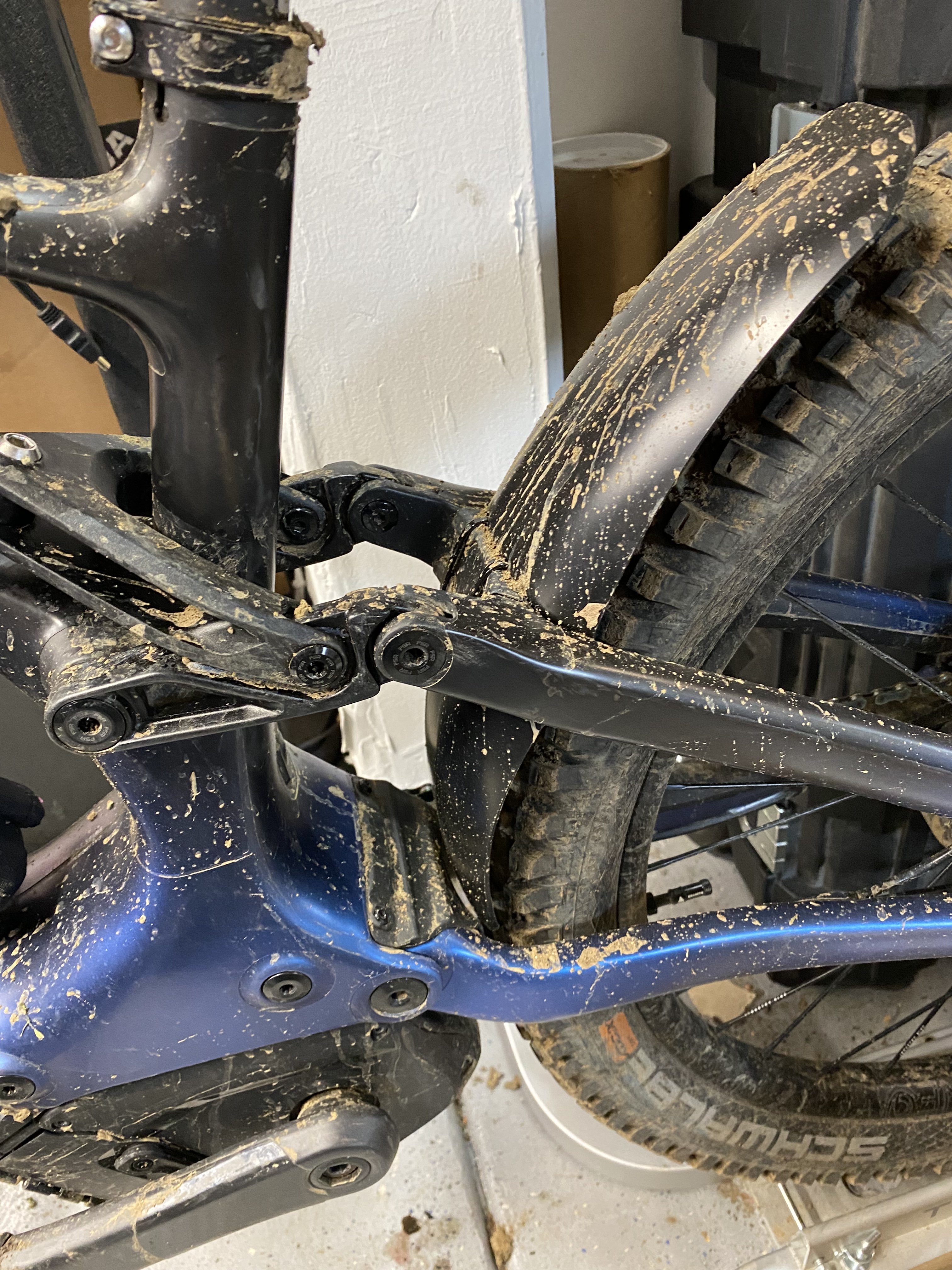

Just ordered one of these ^^^^^^ for my orbea rise, over the years I have only used a clamp on seat post mudguard to protect my back and never really appreciated why people bother faffing about trying to make something for down below.
After removing a kilogram of dried mud ( many rides) from the motor area and having to drink from a water bottle covered in shit enough is enough so I finally get it , hopefully I will be impressed (y)

you are happy with that?? The mud flying off the rear tyre does so mostly at the top of the wheel and that mudguard is too short......... so as you can see the mudguard is not providing any protection for .........anything really!

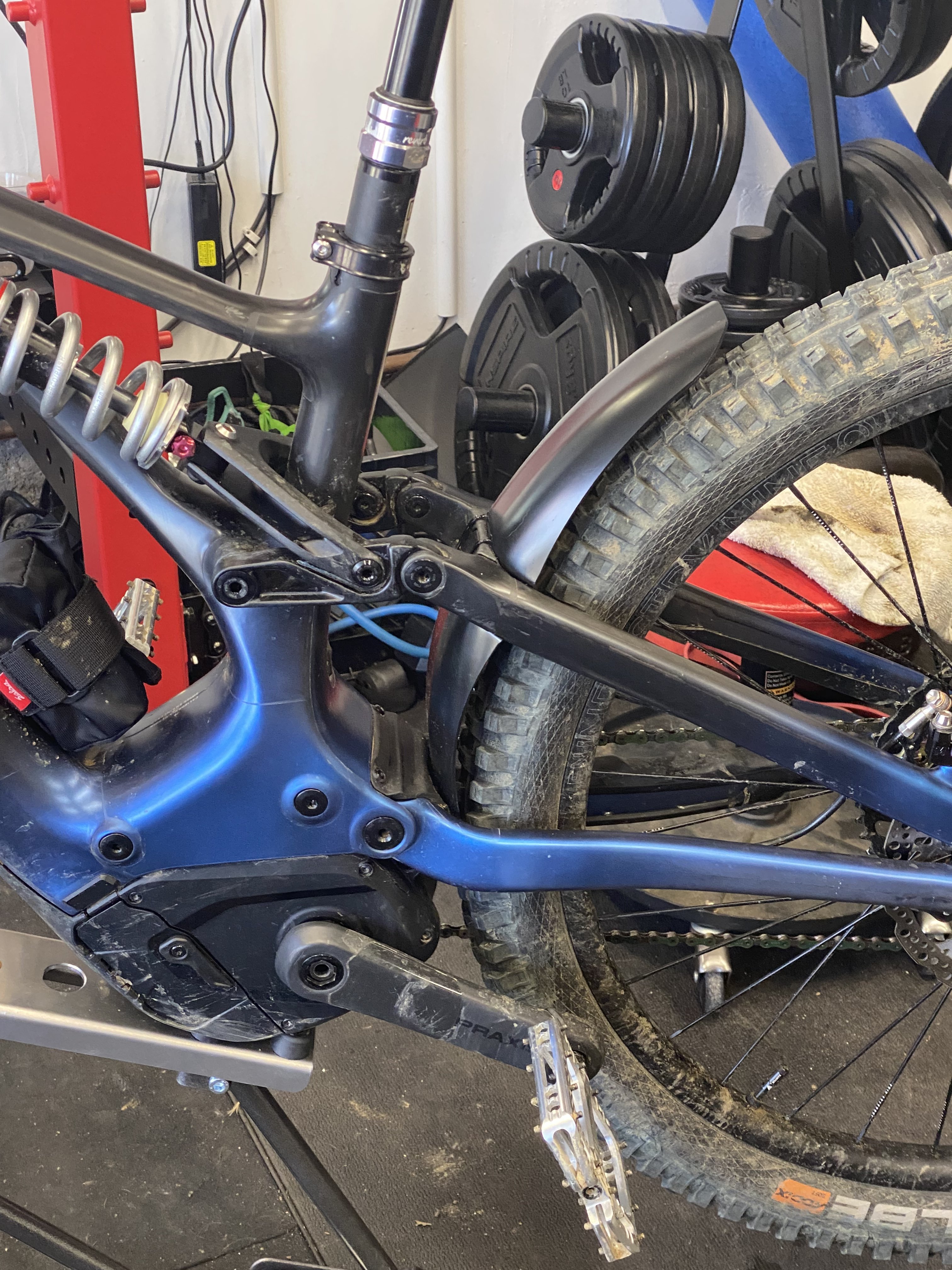

RM.SGO
Apr 25, 2020
61
57
Danville, CA
I won’t ride with a ridiculous looking thing hanging off the back. This prevented the mountain of mud that normally accumulated at the pivot point and reduced the amount tossed up onto my backside… so yes I am
