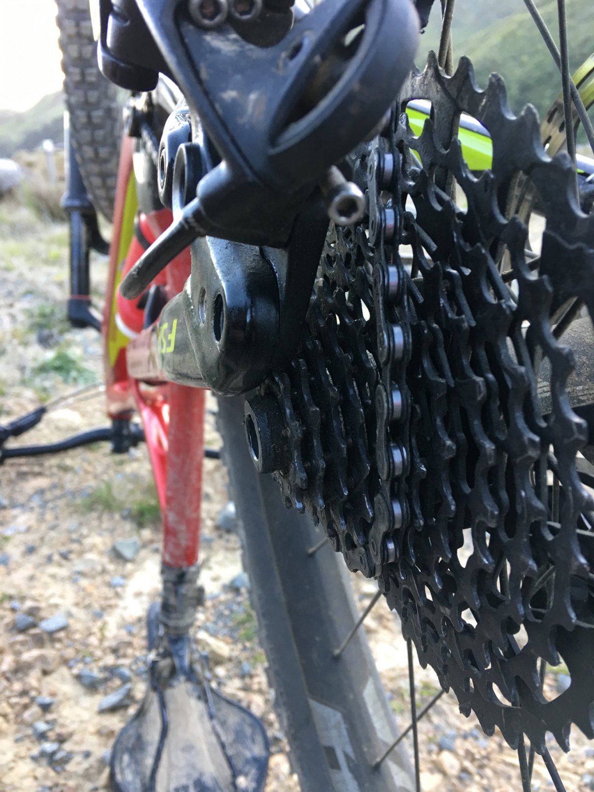

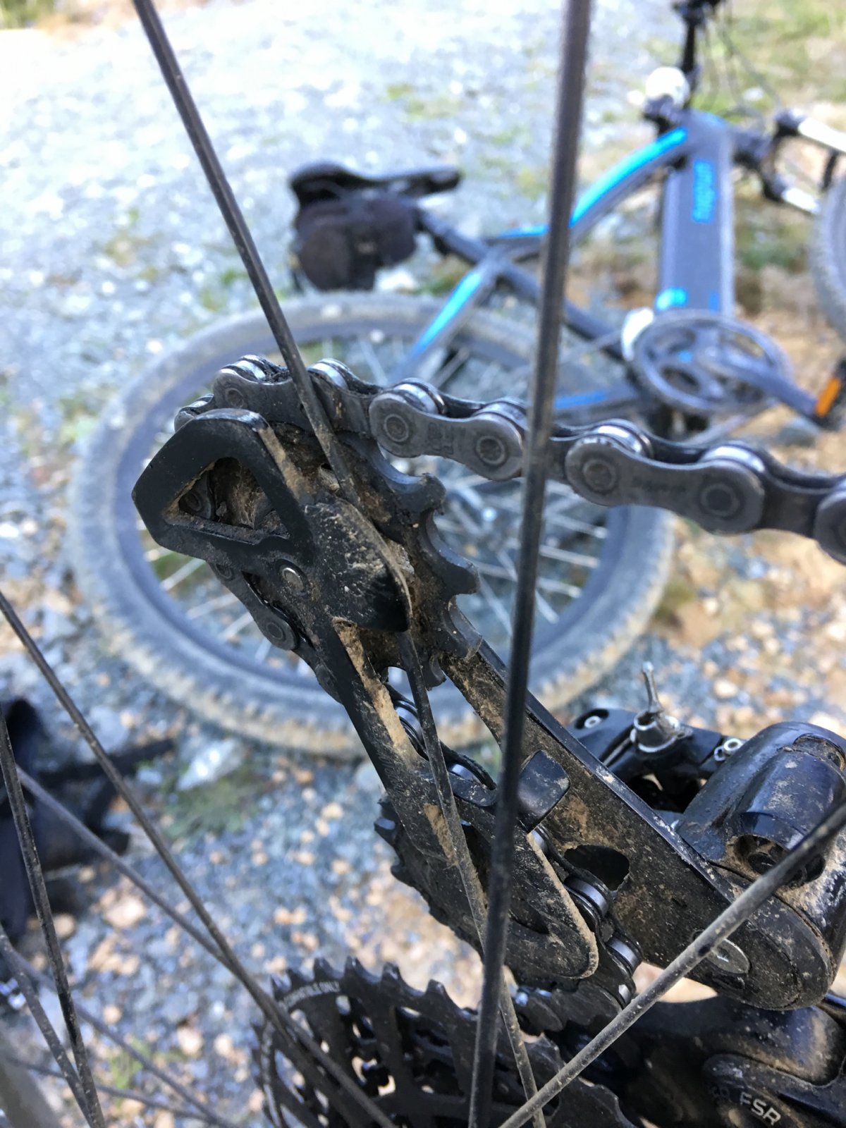

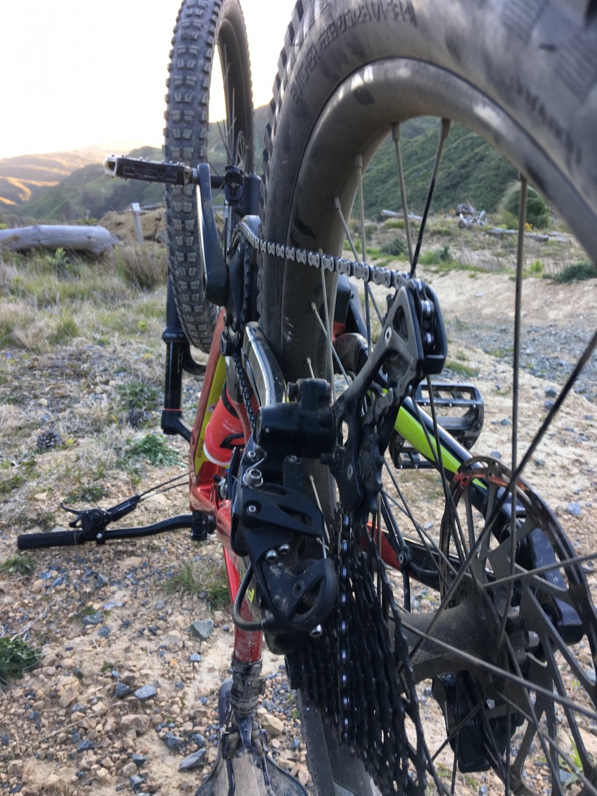

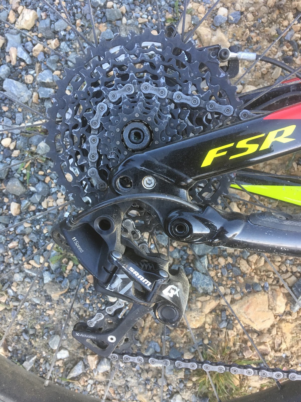

Has anyone had this happen before????
My rear axle somehow unwound itself as I was doing a downhill run last night. It was extremely lucky it happened where it did.....it locked up the rear as a spoke became wedged in the lower cog on the hanger, the axle became wedged on the angle, and the rear tire hit the frame!! The rear brake rotor was also wedged and now warped ???
The bike is not long back (4 rides)from having the sensor and cable replaced after that failed.

View attachment 6473 View attachment 6474 View attachment 6475 View attachment 6476

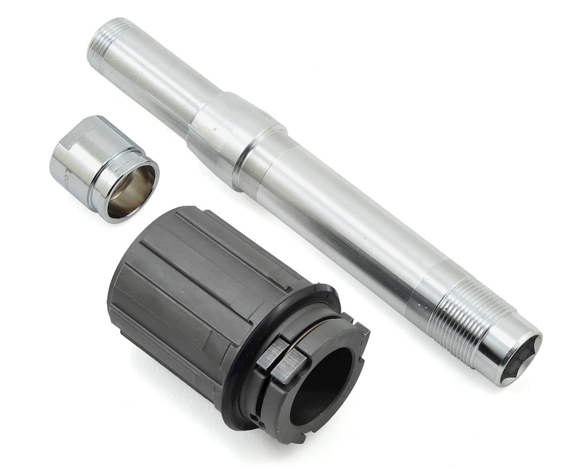

There's an axle loosening problem with some Specialized rear hubs (and a few other brand hubs as well), which is because these hubs have an internal left-handed thread that hold the 2 halves of the axle "sleeve" together. I have seen this same thing happen on at least 4 bikes recently (fortunately no one was hurt - although one guy lost all his freewheel internals halfway along a big ride).
The threaded connection holding the 2 axle sleeves together becomes loose over time (they should be tightened better in the factory), but you can't tell, and so when you tighten the axle it feels tight. During the ride the axle sleeve threads tighten up a little due to the forces around the rear wheel, and so the axle becomes looser. As you ride the axle now unwinds itself, and the bad stuff happens. Even if you re-tighten the axle, and you think it must be OK, the axle sleeve thread just moves again, and the axle comes loose - almost every ride !
On all 4 bikes I found the axle sleeves were loose, and when they were tightened properly (anti-clockwise, because the threads are left-handed) the axles never loosened again.

Apologies for any confusion - I am referring to the actual Axle, and not the "through-axle" (which is not really an axle - it just holds the wheel onto the bike).
This is a Specialized / Formula type Axle, and the thread on the freehub end (which is a left-handed thread) is the one that can loosen, making the through-axle impossible to tighten properly.

So we need to be clear what is coming loose or breaking. The main hub axle runs on 2 bearings and is secured with an adjuster nut and locking nut on the non drive side. The axle can only come loose if the lock nut moves or a bearing collapses. The silver left hand threaded nut on the drive side merely holds the free hub onto the axle that extends beyond the hub by applying minimal preload against 2 further cartridge bearings.

Theoretically Mikerb you are correct - nevertheless on all 4 bikes that had repeatedly loosening through-axles I found that the left-handed nut on the drive side of the main axle was loose (and one nut had come fully unscrewed), and tightening this nut completely solved the problem.
As to the cause, it could be that as the through axle is screwed in, friction between the through-axle and the inside of the main axle causes the main axle to turn relative to the frame. If the drive side nut was insufficiently tightened by the manufacturer, and it resists turning because it is being lightly pressed against the frame, the nut may loosen slightly (as the main axle is turning clockwise and the nut is stationary). Even though the through-axle is then tightened correctly, if the drive side nut re-tightens itself slightly during the ride, the through-axle will become loose - and unless the drive side nut is properly tightened, the problem will just repeat itself.
Apologies if these technical explanations are somewhat tedious - but it might just be worth checking that nut anyway.
