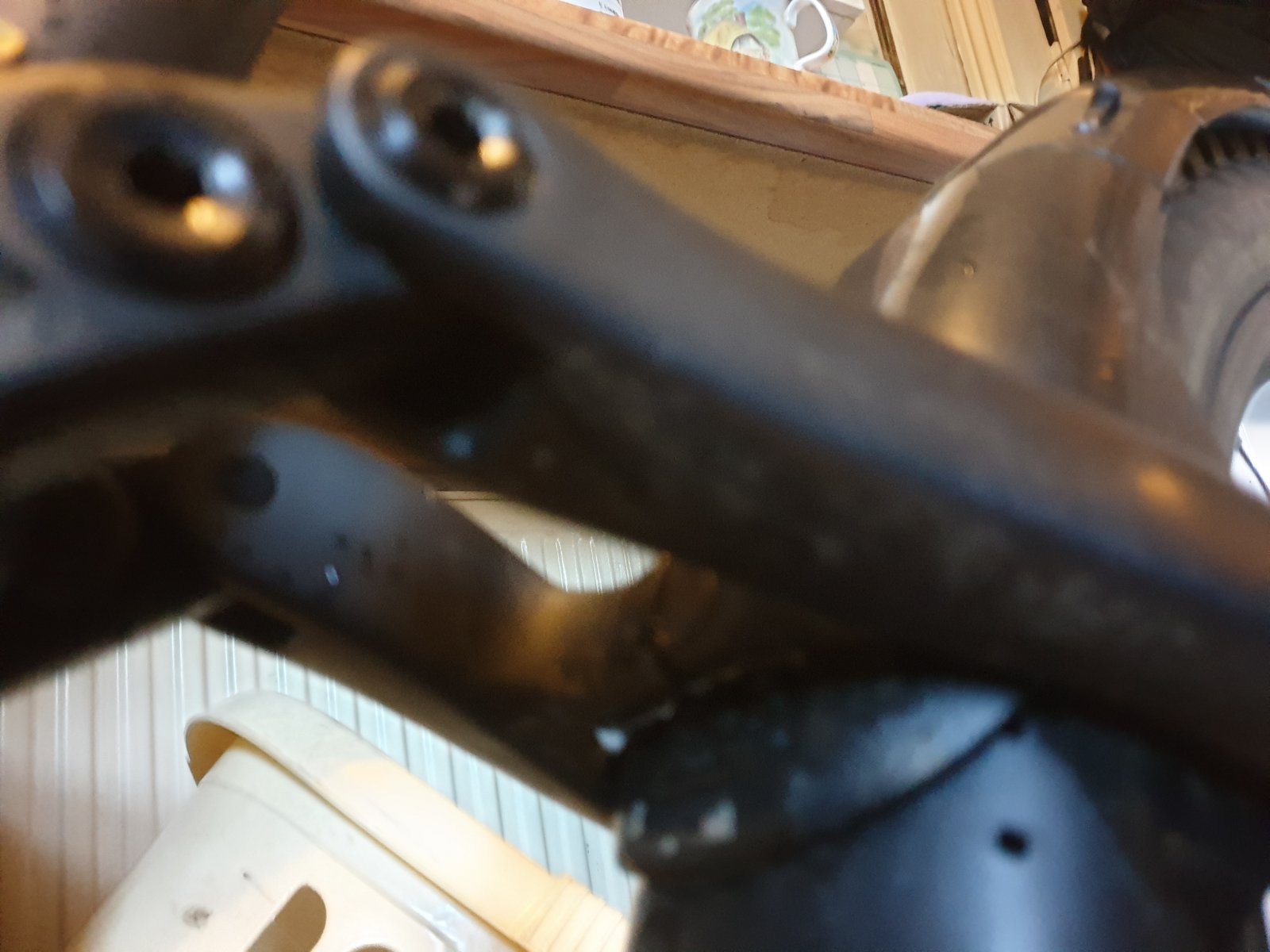

Aha, just the man!

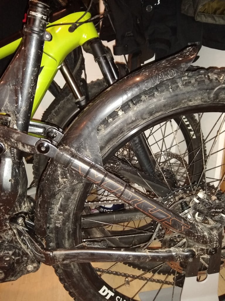

So, my dream rear mudguard … At the mo, on my Vitus E-Escarpe, I have a bodged and chopped RRP Proguard Front Max as my rear, set on the seatstays. Now I don’t think I’m alone in doing this to protect the pivots, but it’s particularly useful on Vitus eMTBs given the split seatpost which exposes the rear shock and top of the motor housing to driving mud. So, frankly I reckon that RRP should develop an adapted version of this!
First, lose the lip at the front and maintain a consistent curve. I’ve chopped mine down as it was pinching just behind my motor, causing a clag-point for mud.
Second, make it a touch wider/ more flexible at the mounting points. You’ll see in the photo that I’ve added some holes for additional cable ties to help pull the guard away from the tyre.
Third, and perhaps more importantly, make it a few inches longer to give a bit more protection for my arse. I didn’t have time to change the other day before I had to walk the dog and I overheard two separate groups of people discussing the fact that it looked like I had shit myself. There’s a reason the rear Mudhuggers are popular, but they’re a little OTT for my liking – and provide no protection for the pivots.
Right, I think that’s all of my not remotely unreasonably list! I’ll seek no commission when it becomes your bestseller. Freebies will however be accepted!
non non non
leave the front portion as it is, but protect the inside of the chainstay yoke from rub with mastic/helitape or velcro. leaving the front lip in there actually helps secure the guard/keep it straight in use.
protection (especially velcro) deadens and sound it makes on the chainstay yoke.
Again
non non non non
you really don't want it more flexible. if you want it to conform better use a hairdryer/heatgun (gently)
And you really shouldn't be using massive tyres in mud anyway.
Fair enough... but... they're not really needed if you'd have fitted it as described above.

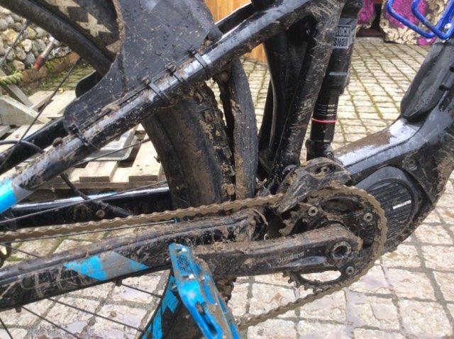

It's on .. took a "before" mud picture to see how it limits muck spreading ... It's 0 degrees, so couldn't get the helitape to bend ... it's not raining for the first time I can remember, so stuff it, I want to go for a ride. Be interesting to see what happens round the rear linkages without the "front long mug hugger" stuffed in there - which wasn't working as well as I would have liked.
Used three zip ties either side and used bigger than supplied, mainly because the supplied ones had "sticker" stuck to them and I couldn't be bothered scraping it off.
Sorry rrp for the thread hijack :) There's no such thing as bad publicity .. :)

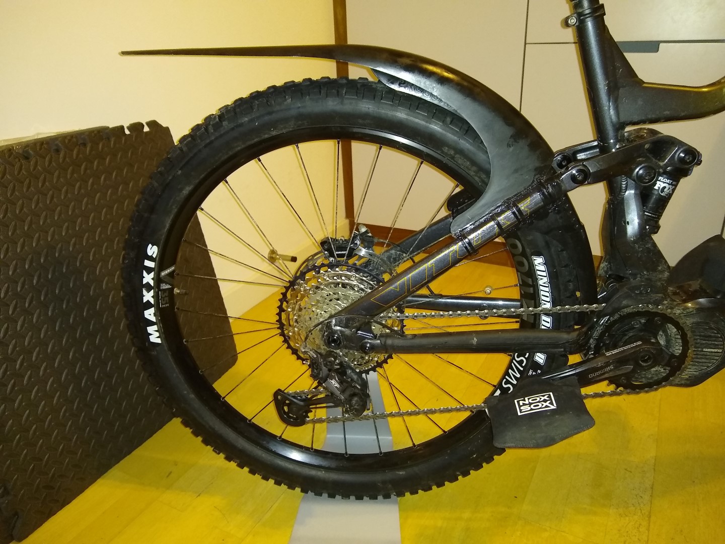

Cheers @Zimmerframe for the tip - and @Simoto123 for clarifying. I'd started staring at that photo, trying to figure out what was going on, so you've saved me some effort there.
It is interesting that @RapidRacerProducts Ltd are specifically looking at eMTBs. The mud and spray never bothered me as much until this winter - my first on an eMTB. Between more rides, more speed and more miles per ride, the amount of mud I'm frequently wearing is preposterous. I usually ride with a claw brush in my pack, mainly to declag my tyres. The other day I actually retired to a quiet corner of a field with my claw brush to declag my arse.
So, like you Zimm & Sim, I've reluctantly come back round to the Mudhugger. I had one knocking around, so last night I mounted it over my Proguard. I'm not sure if I'm keeping this configuration, so didn't bodge or batter the Proguard further. It obviously looks appalling, but less appalling than I feared. (The silicone was still wet and looks awful in the flash photo. It looks fine now under normal light.)
Test ride imminent!

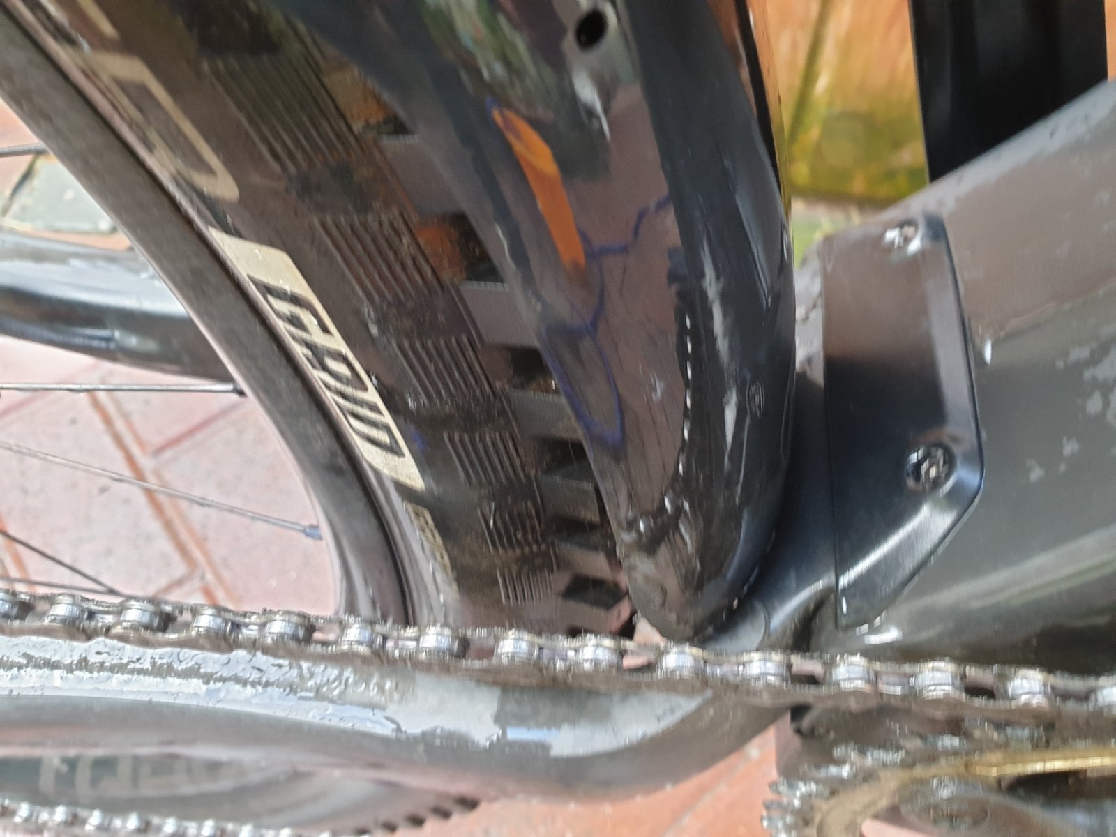

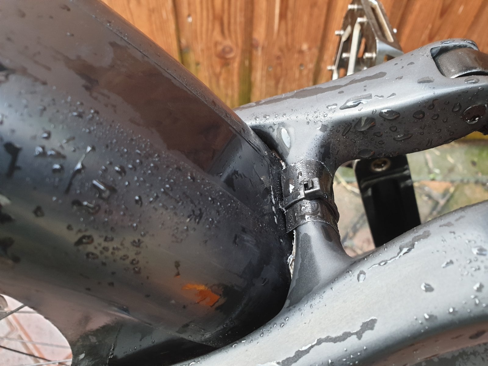

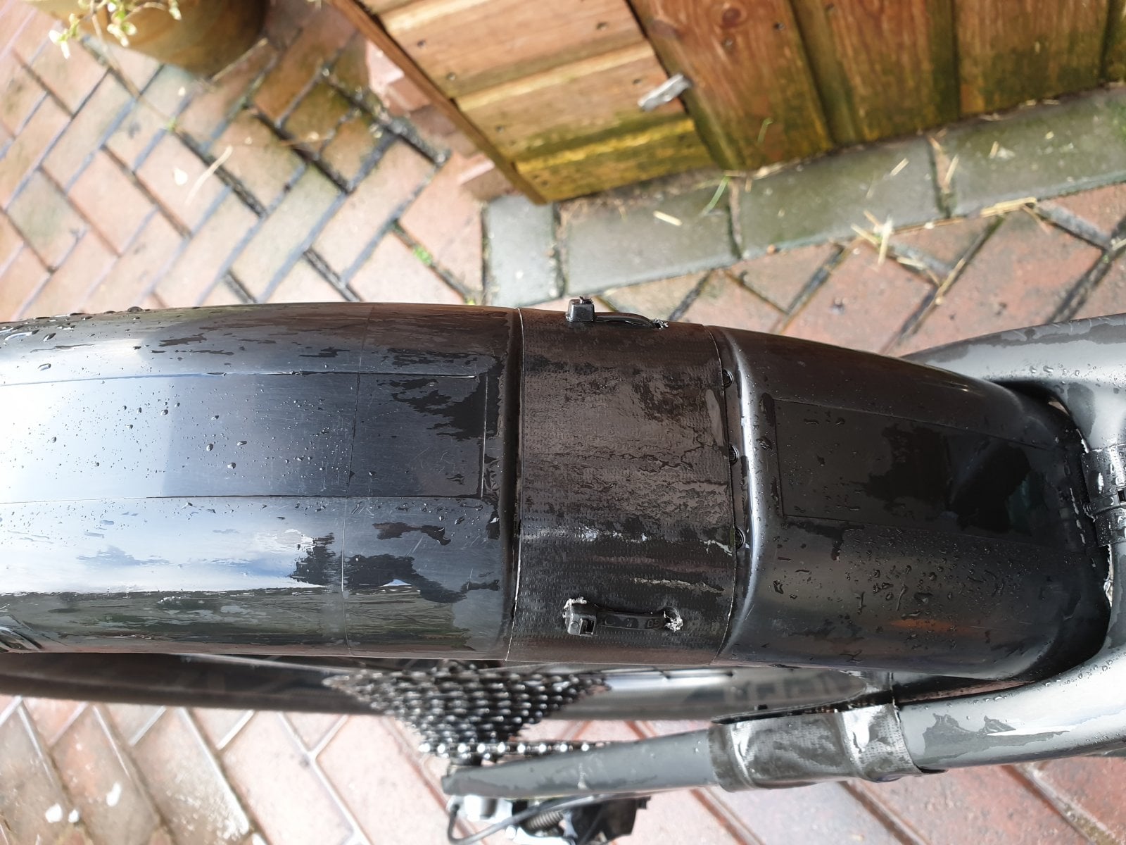

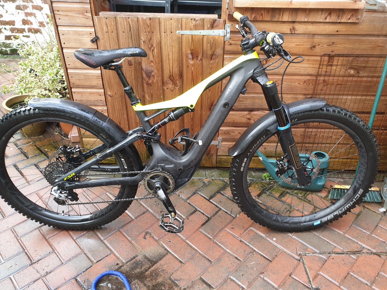

here goes with the explanation. First a gratuitous shot of sworksie. Sorry about the yard. It’s winter and I can’t be arsed.

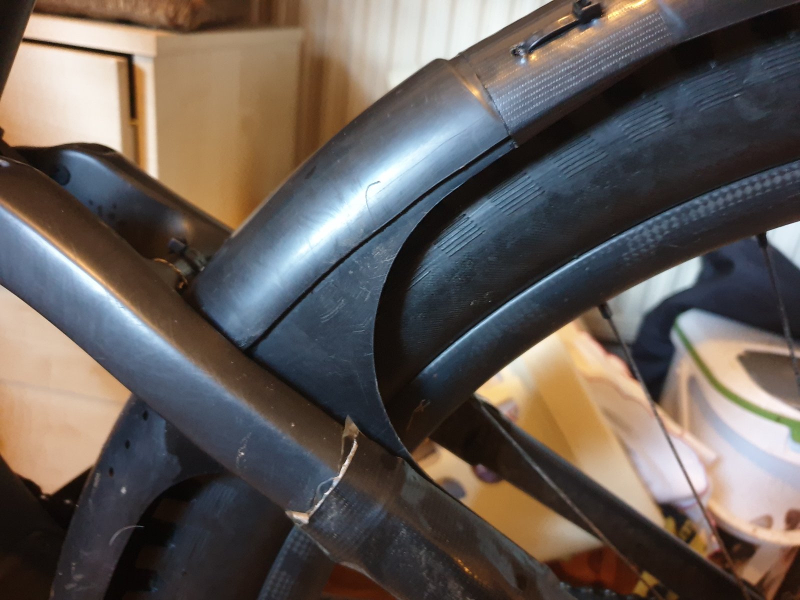

Next, a closer shot of the guard.. You can see two cable ties which thread through the original holes in the progaurd and the hugger below. Really tight fit of one inside the other, no glue required(stroke of luck there). The mounting section off the progaurd was neatly cut at a profile to match the line present on the hugger inside. Many inches of land at either side of the ties.
Next one shows where the mudhugger lands as standard. The overlap is hidden in the shot, obscured by the seatstay brace. About 1” of the progaurd comes through the seatstay brace. Out of shot.
A pic of where a tie goes though both elements and around the seatstay brace.

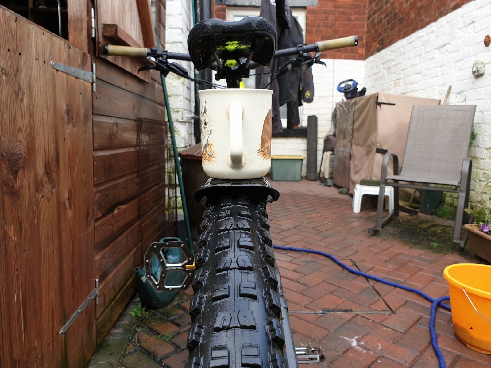

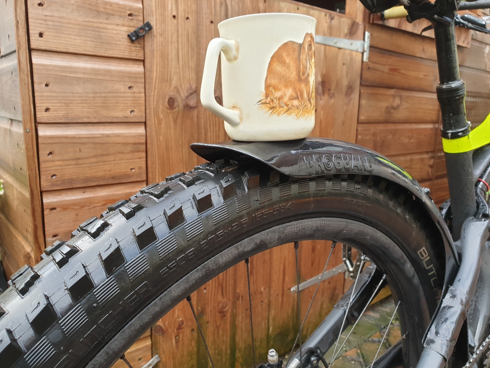

Finally(phew) A couple of pics to demonstrate the integrity of the assembly. Showing I hope, an almost total lack of deflection with alf a brew sat on it.
i believe my slight reluctance to argue with gary about the rigidity, (I had couple of sherries on board that night) when, I knew it was very sound after at least a hundred mixed miles already on it. Many more now. Sorry about that Gary old chap. Little weight left in the progaurd after stiffening and mounting section removed, and as I said a Really tight fit of the hugger inside the progaurd. No noise, little flex or deflection. Really good solution, if a little expensive. I had both elements, so not too bad.
in the last shots a line can be seen where the progaurd overlaps the hugger, and the profile where one meets the other horizontally.
there we go clear as mud, sorry for the unintentional pun.
Dude this isn't STW, no ones judging your yard. Great bit of ingenuity... but let be honest my medium mudhugger was pretty rubbish as a rear guard (for the rider) until I added the extended to make it as long as their new "large" model. You need a lots extension on a 29er wheel to stop the 'flick', as per RRP post

Thanks for all the pictures and the explanation ! It all makes sense now !!! Cunning, looks like it works well and certainly maintains rigidity ! You're lucky to have a seat stay brace, there isn't one on Kenevo, so I'd struggle to maintain the same level of strength and support you have. For some reason I thought it was two RRP guards. I was really struggling to work out how they went together before I committed to buying them :)
