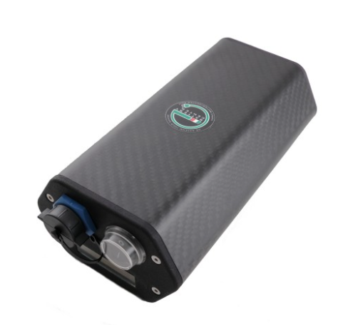

Volabike - A Spanish company but with the option to set the website to English :
252/378wh extenders for Bosch, Ebikemotion, Fazua, Giant, Mahle, Polini, Specialized.
E-batterycentre - Italian .
For Bosch, Specialized, Focus Tec Pack.
They do quite a funky hexagonal 360wh pack weighing 1600g which is compatible with Specialized, Shimano, Yamaha, Brose, Bafang, Oli, Bosch & altri :

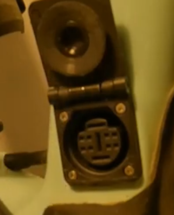

I wonder how these generic extenders manage the parallel battery charge risk. If the internal battery is near empty and the external is fully charged the charged battery will tend to rapidly discharge into the internal battery causing the destruction of the internal battery. It is possible that the internal BMS might prevent this from happening by regulating the charge but it would have to shutdown the internal connection to the motor. It seems using a parallel switch is the accepted method but that requires both batteries to be connected to the switch and then the switch supplies power to the motor. This would require wiring changes.
IF the external port on the stock bike only has a charge port that port may only be designed to handle a small 2amp charge and not able to supply full current for use directly to the motor as an external supply rather than for the charger.
Do you how the generic batteries handle these issues?
mike_kelly
Aug 11, 2022
937
771
US
The Orbea has enough pins that they could indeed run the motor connector out so the the external battery can connect directly and still have separate pins for the internal battery charge port.
Tonybro
🦾 The Bionic Man 🦿
Jan 15, 2021
1,293
2,927
Lancashire
The BMS on the Orbea Rise must be pretty sophisticated as the extender battery does NOT charge the internal battery, It powers the motor and the BMS switches to the internal battery after the extender is exhausted. So it must check for the presence of the extender and if there, electronically switch power source to it before switching to internal batttery when exhausted. BMS reports range based on the combined availability of power when the extender is connected.

Yes since they planned to have the external battery from conception and the battery will not be rremoved they must have the functionality of a MOS Parallel switch built in.

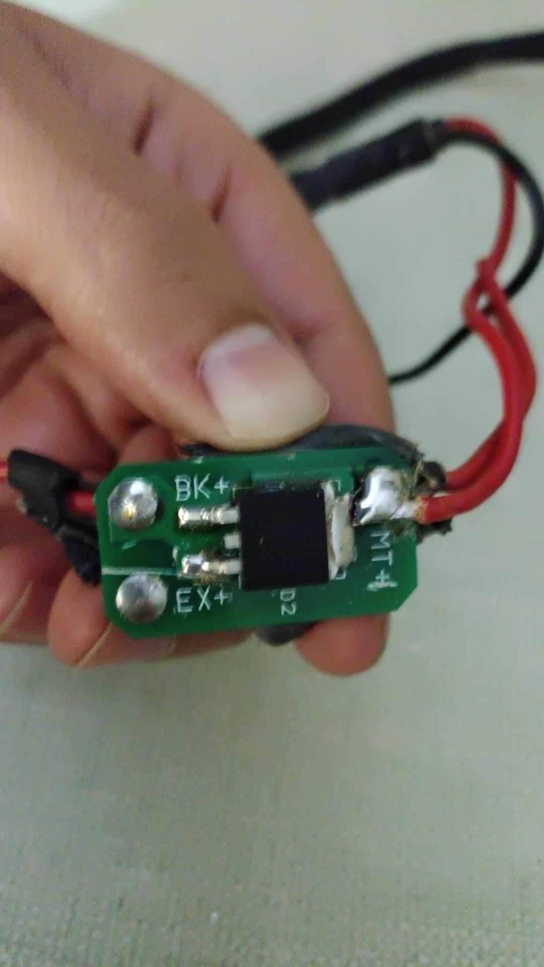

Hi guys,
I recently bought a 2019 Kenevo which came with an installed Volabike range extender, the cylindrical one for the bottle cage.
The problem ist the stupid thing sometimes works and sometimes not, which can be a terrible pain in the arse especially when riding big tours with other people.
Volabike saya that both the bike battery and the extender must be charged to 100% to work. From my experience this is not true, because it happened to me that the extender started working when the bike battery was discharged at about 60%. I then changed some settings in blevo and then ist suddenly worked.
Question for Volabike and/or Trailwatts users: Do you experience similar problems? Do you really have to charge the extender to 100% as volabike claims, otherwise it would not work? I think this must be bs, because that would mean that it would be impossible to turn the extende off when it used some power, because then it would no be usable unless charged to 100% again.
What could cause such problems? Really angry and p*** off with the damn thing, since it ruined my day again today.
It just stays at 100% and remains unused.

Hi guys,
The problem is the design of the diode module, it´s just an schottky diode
It takes only a basic thermal test, let´s say 10Amps to check that those diodes overheat seriously
In Spain it´s already known, many peope affected by the same problem as you

Thanks very much for your reply. I’ve sent Volabike the wiring and obviously they replaced the diode you mentioned (for free). Since then the extender works flawlessly :) I couldn‘t be happier.
Best regards
