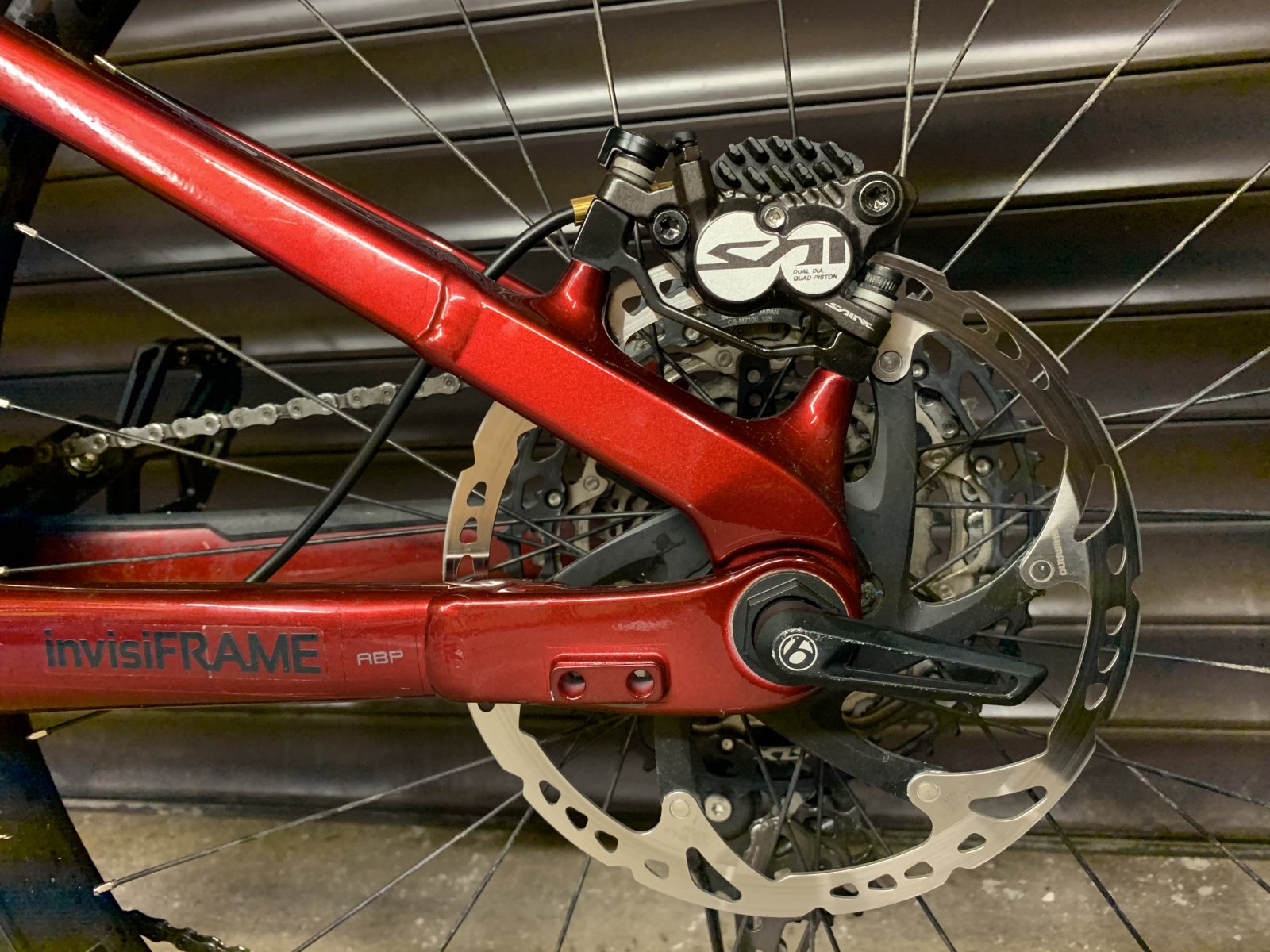

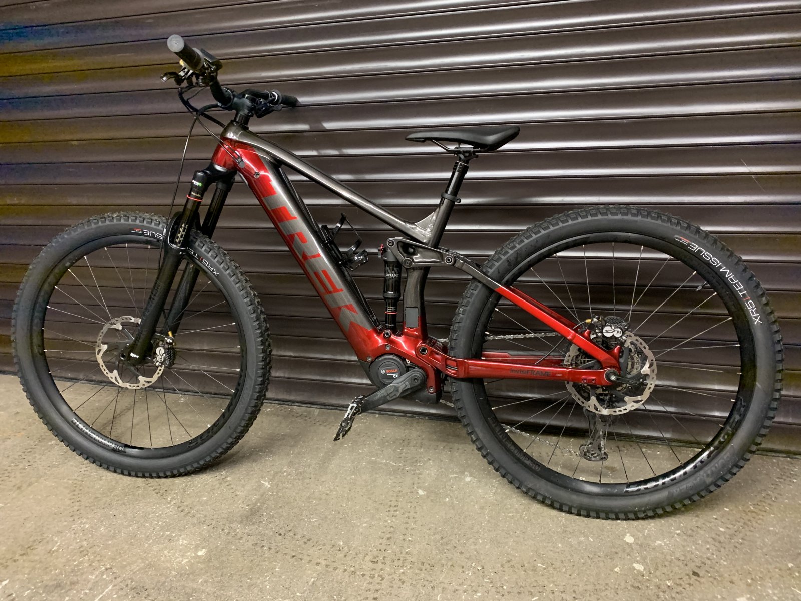

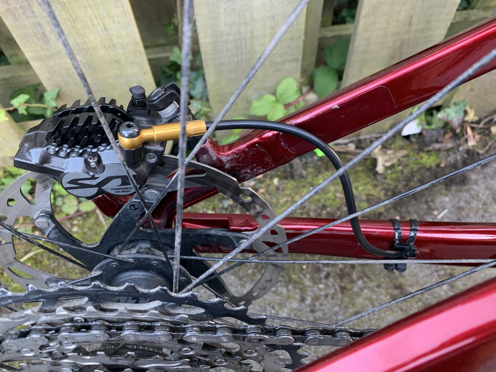

All done. When the new motor bolts arrive I’ll fit them then go riding until the battery is flat ? ⚡?? View attachment 24906 View attachment 24907 View attachment 24908

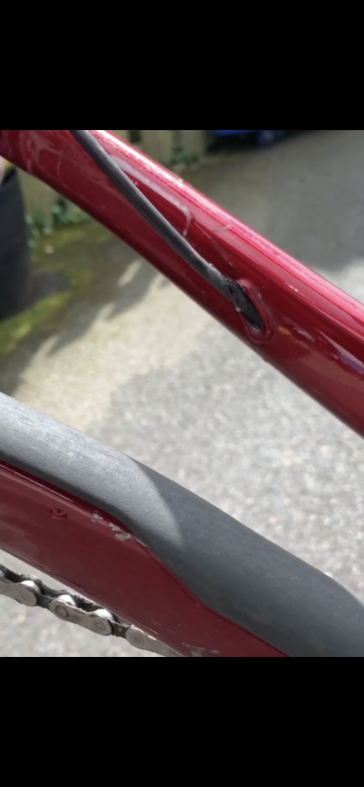

Point of note - with the OP's pictures - I would pull a bit more cable through to the caliper end, the wheelbase on the Rail does grow through the suspension travel - I wouldn't be surprised if that was under some tension, having done this myself.
A sound piece of advice, and you were correct. It was too tight and rubbed through and cost me another hose. It’s now got a longer length between frame and calliper. Lesson learned!

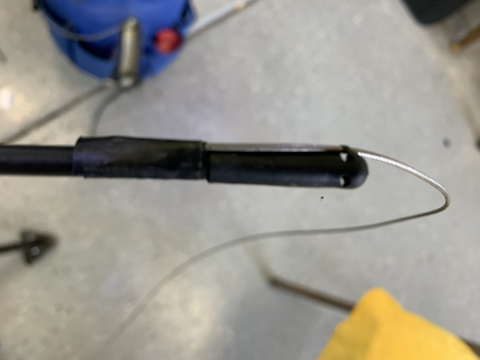

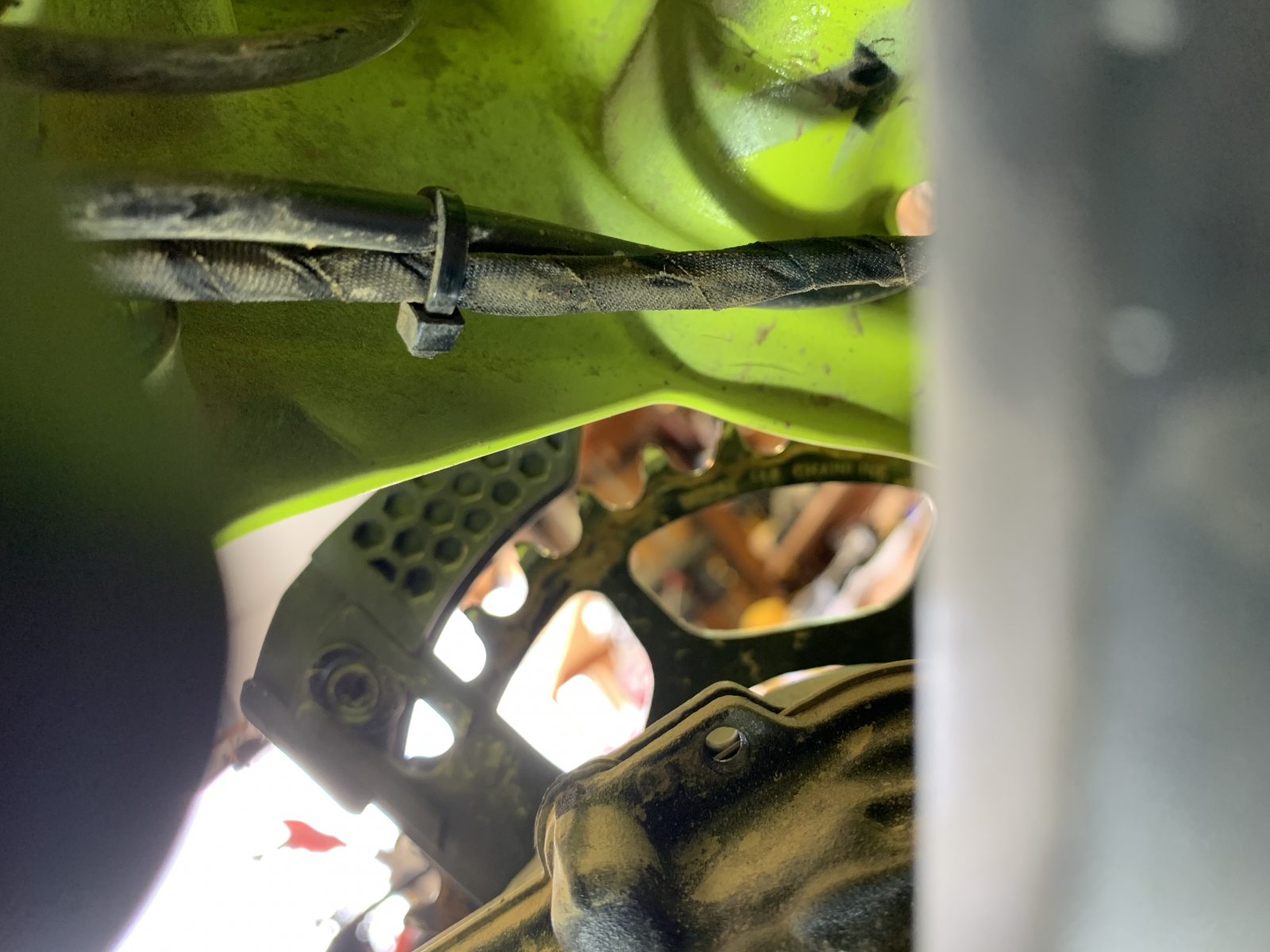

Just a couple notes from my brake replacement experience. The rear brake line was zip-tied to the motor wires, so impossible without dropping the motor. The active braking pivot changes the length of the brake line between the chain stay exit and the caliper. Vent the air, or remove your shock and fully compress the rear suspension before you position the brake line and cut it to length. I hate overly long brake lines so I took this opportunity to clean things up but ended up with a brake line that is a little short because I wasn't aware of the active braking pivot impact on length. I used an old mechanical brake cable, the braided metal part, to fish the brake line. With the cable end still attached it was easy to grab it. I installed Shimano Saints, great brakes, the pre-inserted olive is crap and easily gets misaligned and messed up. Make the lever connection the old fashioned way, slide on the cover, the nut, the olive, tap in the end, then thread everything into the lever.

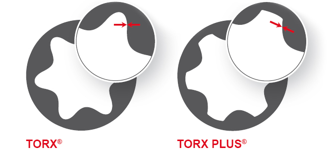

I copy this also here:
Just found out something today:
I was wondering why Bosch sells T40 1/4 torx with a 8 euros price tag here locally. Well one reason could be that Bosch CX GEN 4 T40 bolts are torx PLUS and not ordinary torx.
There's a small difference:
