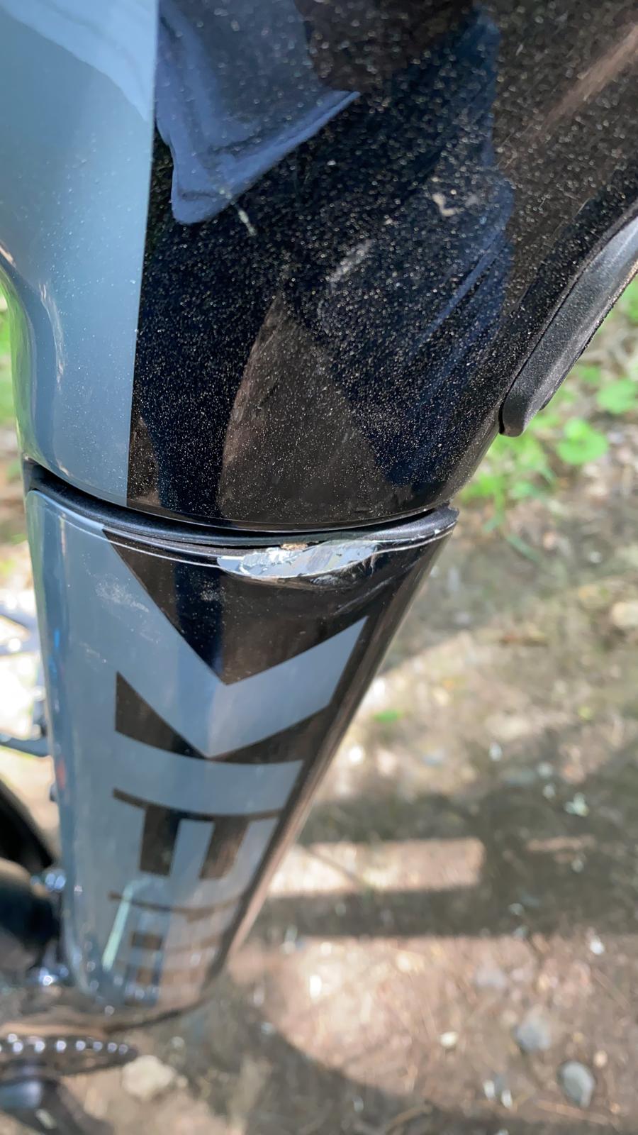

So I got my Rail 5 on Monday. Messed around with a few things at the house that night including taking the battery out to see how it works and charges off the bike.
Had my first ride last night and 15 minutes in my battery pops out when I'm doing about 15 mph and lands on the rocky ground. It scratched and dinged some of the edges of the outside painted "downtube" part. Not happy. I had the key in my backpack so I cleaned the battery off, put it back in and used to key to make sure it was locked. The bike rode fine after that so no battery damage apparently.
I figured it was user error and I must not have locked it when I put it back in at the house after taking it out. After playing with it today though it seems like you can't NOT lock it. What I mean is the key will only come out of the lock when it's in the locked position so I clearly didn't leave the key in an unlocked position. That means it popped out when it was supposed to be locked in. After putting it in and taking it out a couple times I think I was able to recreate the event. I put the battery in, visually it looked like it was seated, the key turned to the locked position and when I pulled on the battery a few times it came out. Seems like it can go in and visually look ok but not actually be locked in.
Has anyone else had this happen? I don't know if this is a defect and I should take it back to my LBS to look at it, or if this is just a thing with these batteries where you need to make absolutely sure it's in properly even if it visually looks ok and seems locked. I love the removable battery thing but not if it's not secure.

@Thesag as @Darren says it's a common Trek fault, unfortunately. Follow the steps in the battery alignment .pdf at the top of the thread and you should have no further issues. However I would put a warranty claim in to get a new battery cover at the very least. Not good to have it all scratched up on your first ride through no fault of your own. Batteries don't like being dropped so perhaps a replacement battery as well.

Just an update on this. Trek is replacing the painted outside cover but the battery tested ok on their diagnostics so no battery replacement under warranty. Apparently there is a service bulletin on this issue so in addition to the alignment procedure done by the shop, there is some kind of plate or something being shipped that gets installed to help secure the battery better. Doesn't sound like the bike will be available until at least the end of the week.

My LBS so they needed to do the alignment procedure AND put some kind of plate in that will hold the battery better. It was a comedy of errors because the plate came in but didn’t have the screws they needed so it took more than a month to get the bike back. They replaced the cover but not the battery. They claim a tested it out OK.
I got one ride in before we had about two months of rain which flooded our lakes and most of our trail systems. Got to ride the other day so I’ve only had a couple rides since getting the bike back but so far so good.
