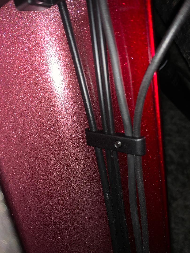

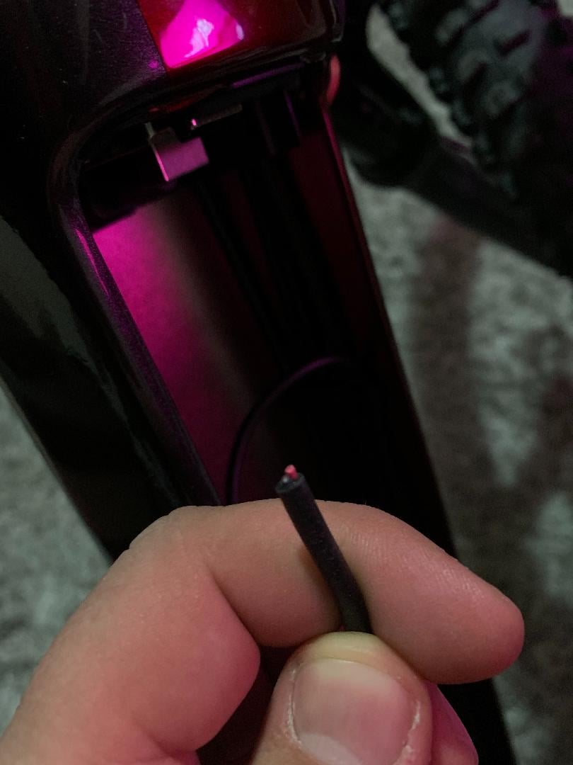

Hi riders, i have a question about your Rails...bough my girlfriend a rail 7 and...inside the frame, under the battery , there are 5 cables....purion, dropper, back brake and shifter...what that the 1st one from left to wright does ??? (her is broke, but the bike is working normal)
