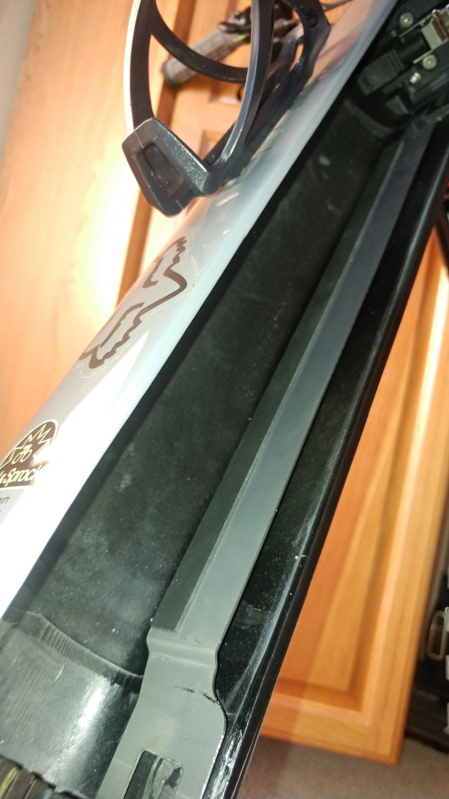

My 2020 9.7 kept shutting off...no power while riding. After 4 trips to the dealer, they feel it may be finally fixed. My bike was built without the battery truss. That's a long piece of metal connecting the top n bottom of the battery connections for stability. Well...it's installed now. We'll see it it works.
MOTO13
Sep 16, 2020
330
368
Elkhorn, Wi
From what I was told, my dealer had no clue that brace was even missing. This was the 4th time at the shop. They thought it was a software or motor issue the entire time. Some Trek rep stopped by, looked at my bike and told them the part was missing. They ordered it from Trek and installed the part. Apparently not having this brace is not uncommon for 2020's and some 21 models. They just didn't install the brace on every bike at the factory for whatever reason. I didn't even know this part was missing until I picked the bike up and they explained it to me.

Look at your bike. Does it have that metal battery truss thingy mabobber? If not...that's probably why it keeps shutting off.

I would definitely look into getting one of those thingamabobbbers installed. Are you in the States? From what it seems, dealers were supposed to be installing these on bikes when they assembled them and neglected to. Availability shouldn't be a problem I am assuming.

The alignment plate kit was supplied by Trek as a recall, all the later 2021 Rail's came with them already. What I also noticed was that when the alignment plate is fitted, the battery is aligned differently, sitting further out at the bottom (couple of mm out from flush) than the alignment procedure suggests and virtually no gap at the top.

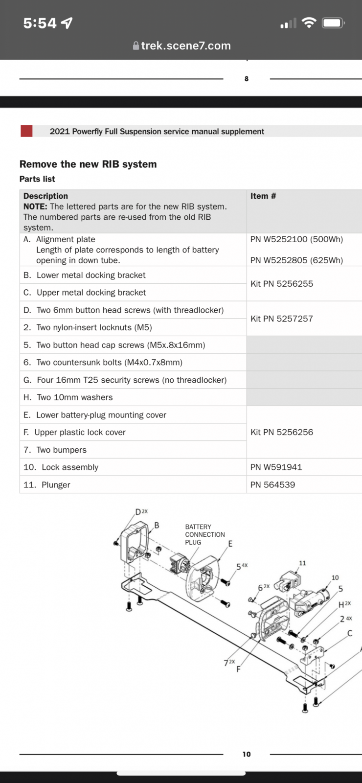

Here’s some more part numbers for the battery truss/bracket/brace/strip for the Powerfly. It’s called an ‘Alignment Plate’. There’s different part numbers for different battery size (500w or 625w).
Some owners are having success by simply performing a battery alignment procedure. Others believe that the battery tube may have some flex, which may be causing temporary power failure. I believe that any movement at all is causing additional wear and/or failure of the battery connections at the lower bracket. (I know, this isn’t Rocket Surgery). A rattling noise from the battery compartment could be an indication of future power failure. I don’t know if this helps but my Powerfly’s don’t have the “cutoff” issue …however my Rail does.

I’m on my phone so I’m not going to look back through it now but I’m quite sure that the parts are also described in the 2022 Rail Parts Diagram in the Trek Sticky section? The reason I think I’ve seen it as I was surprised that they have two options in the manual, one with the alignment plate and one without. It could have been for the Powerfly but I thought it was the Rail.
