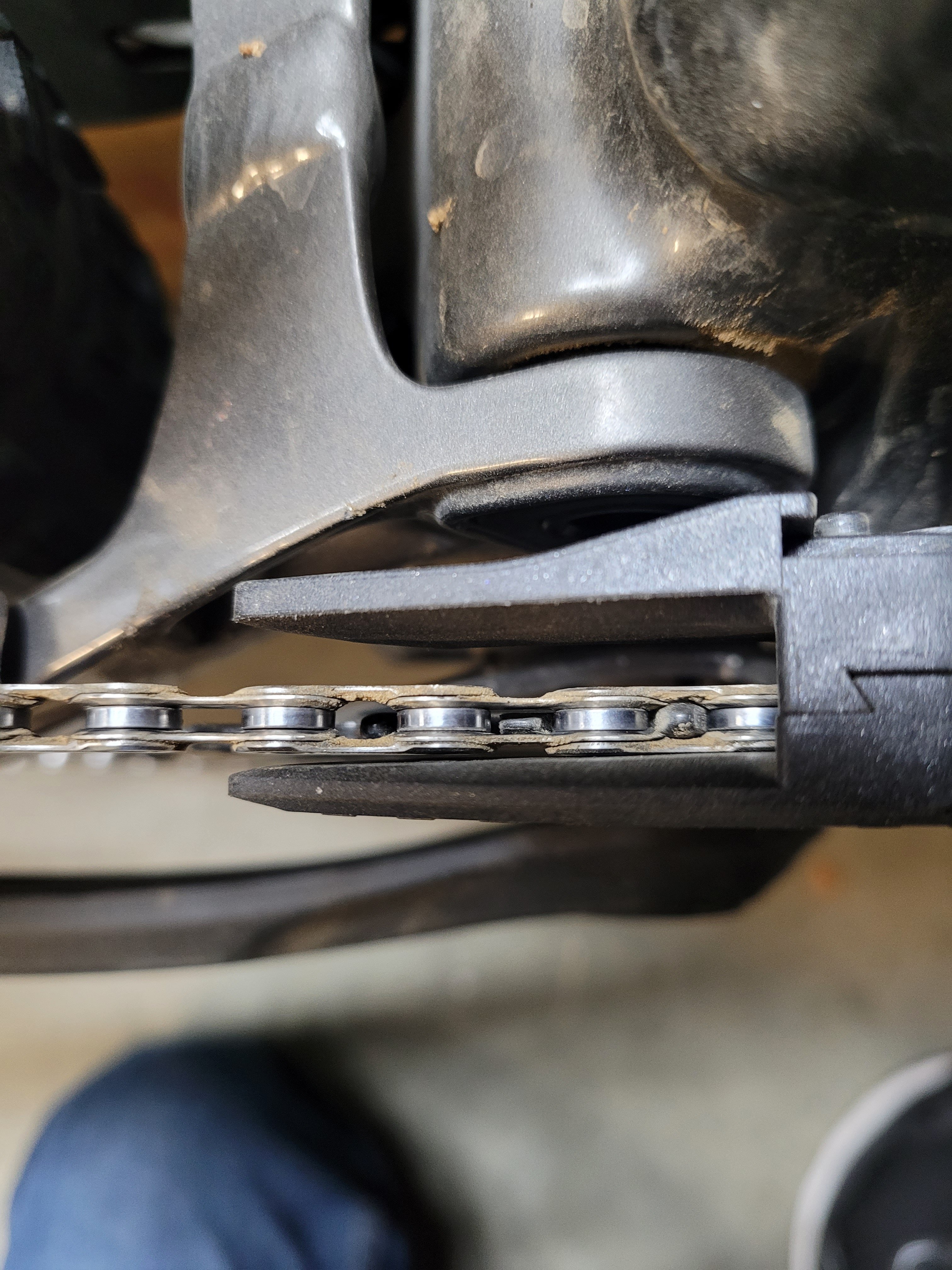

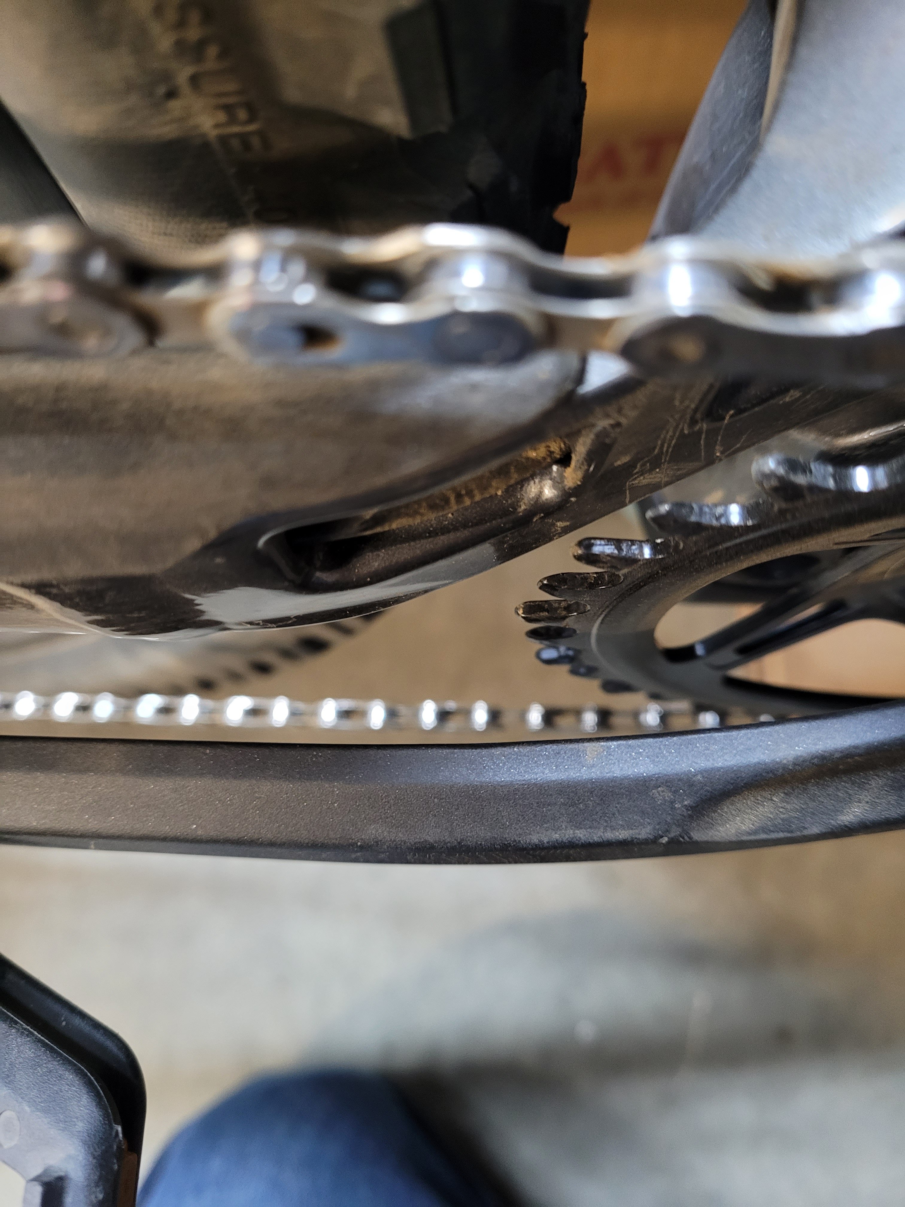

I have a 22 rail 7 and I’ve changed the chainring to the raceface 52mm offset 34t.
So far so good, no issues and good clearance, but I’m fancying a 36t so I can use the bigger cogs of the cassette!
Has anyone used the 36t 55mm offset raceface chainring to allow better clearance? How’s the chainline with it?
Thanks👍🏻

Hi, I also saw that RaceFace 55mm offset 36T and I thought it should fit, so I just bought one. Yes, it fits with plenty of clearance and it only required 4mm worth of shims to adjust the chain guide out. While it doesn't make a huge change to the gearing, for less than $30 it is a step in the right direction. Now to find a 38T that fits...
