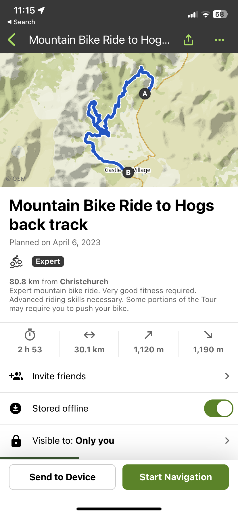

Just wanted to post some quick thoughts here on the upgraded navigation on the Kiox 300 with the latest firmware (app 1.12.5 April 23).
Last weekend I was heading away to an area I had never rode in and I was riding by myself. I wanted to plan my route and use the Navigation. I had never even heard of Komoot before, so I downloaded from the app store (iOS) and planned out my route. All went fine and my route came out exactly as I had planned within the app.

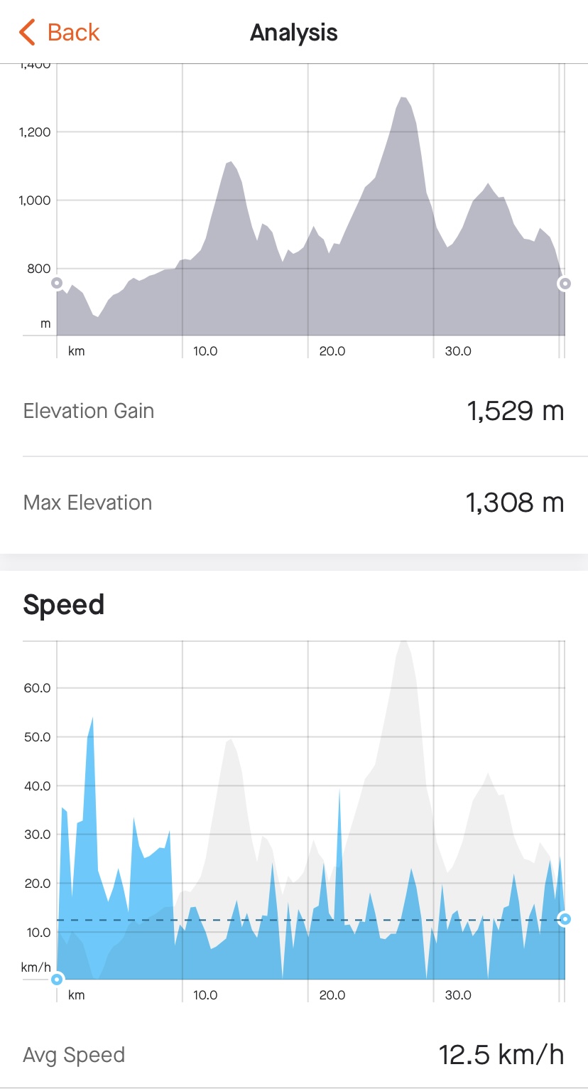

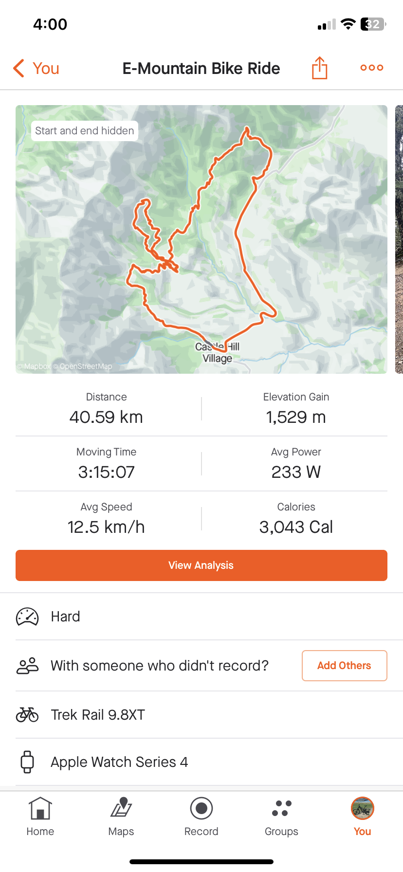

I downloaded it "available as offline" as I wasn't sure what cell coverage would be like. Got to the trailhead and sent the route to the Kiox 300. It uploaded fine and showed in layman's terms the route to follow. Now granted this isn't the flashiest interface with only a white trail line on black screen but it still showed me the junctions and turns to take. It also alerts you when your "off trail" which is handy. It also gave me advance warnings in metres when turns were needed in forks/junctions etc. On the strava below obviously I rode on the Road from B to A on the Kommot, didnt need Navi for that :LOL:

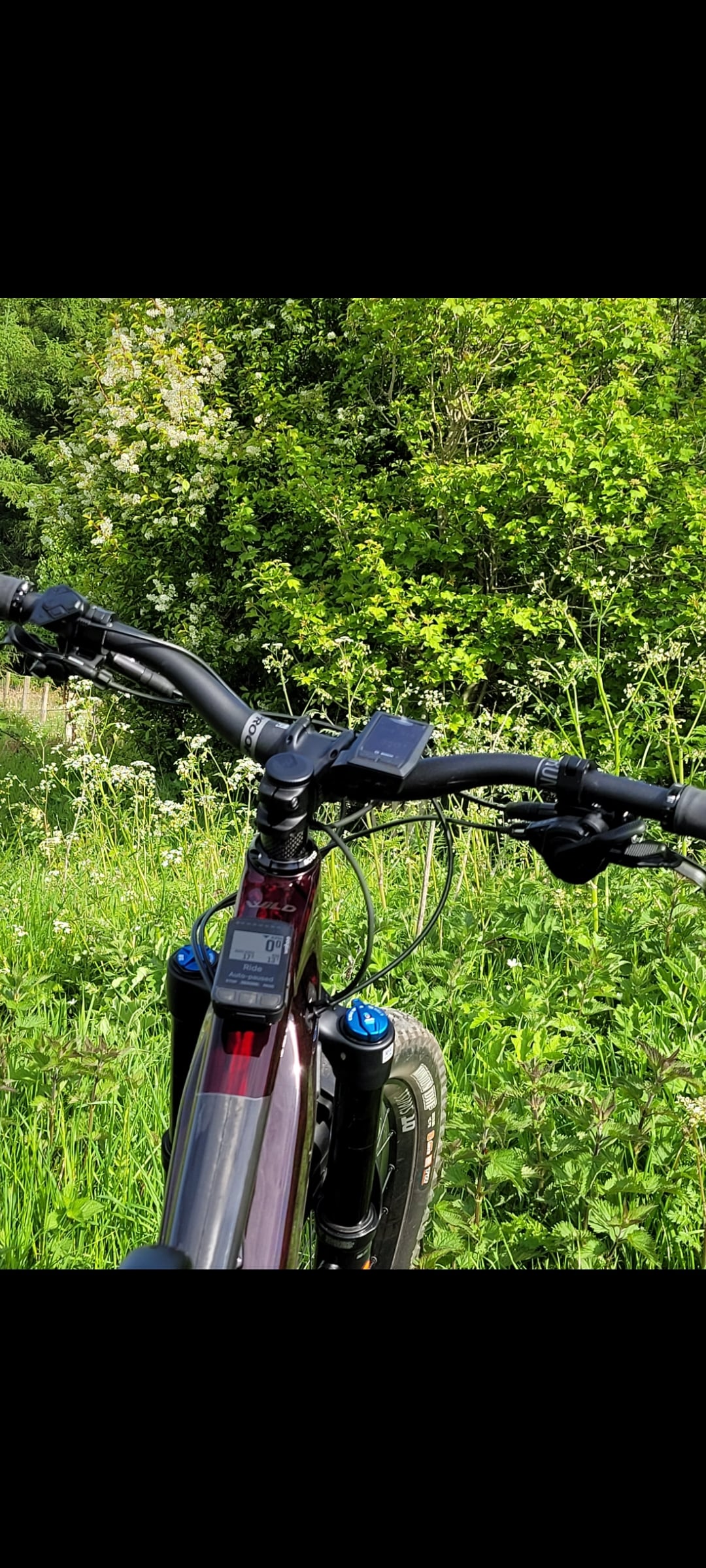

I tried a route on the Kiox and when I set off it said I had completed the route. I have therefore gone back to my trusty Wahoo for GPS and attached it to the top tube to avoid having more stuff on the bars.

I tried a route on the Kiox and when I set off it said I had completed the route. I have therefore gone back to my trusty Wahoo for GPS and attached it to the top tube to avoid having more stuff on the bars. View attachment 115433
you have Kiox...not Kiox300. If you import a route you have to designate it "point to point" or circular. A circular route will start and finish in the same place so the direction of travel shows the out route v the in route.
