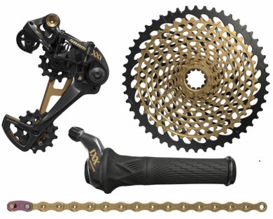

SRAM XX1 Eagle Gold 1x12 with gripshift - butter smooth shifting even under load and definitely ticks the bling box ?not cheap though.... I had the stock XX1 actuator previously and the difference is very noticeable.
Was it easy to get used to the grip shifter ? Accidental shifts ?
Also, any fitting issues with the Eagle 12 speed stuff ?
I was just talking with the bike shop about these and they wondered about the cassette fitment.

I LOVE gripshift, I've had it on previous bikes and just prefer it - I find it much more accurate and you can fly up and down the cassette much easier (if you need to). No fitting issues at all, it just bolts straight on. The cogs are narrower than 1x11 allowing the 1x12 cassette to fit into the same space without modification.
