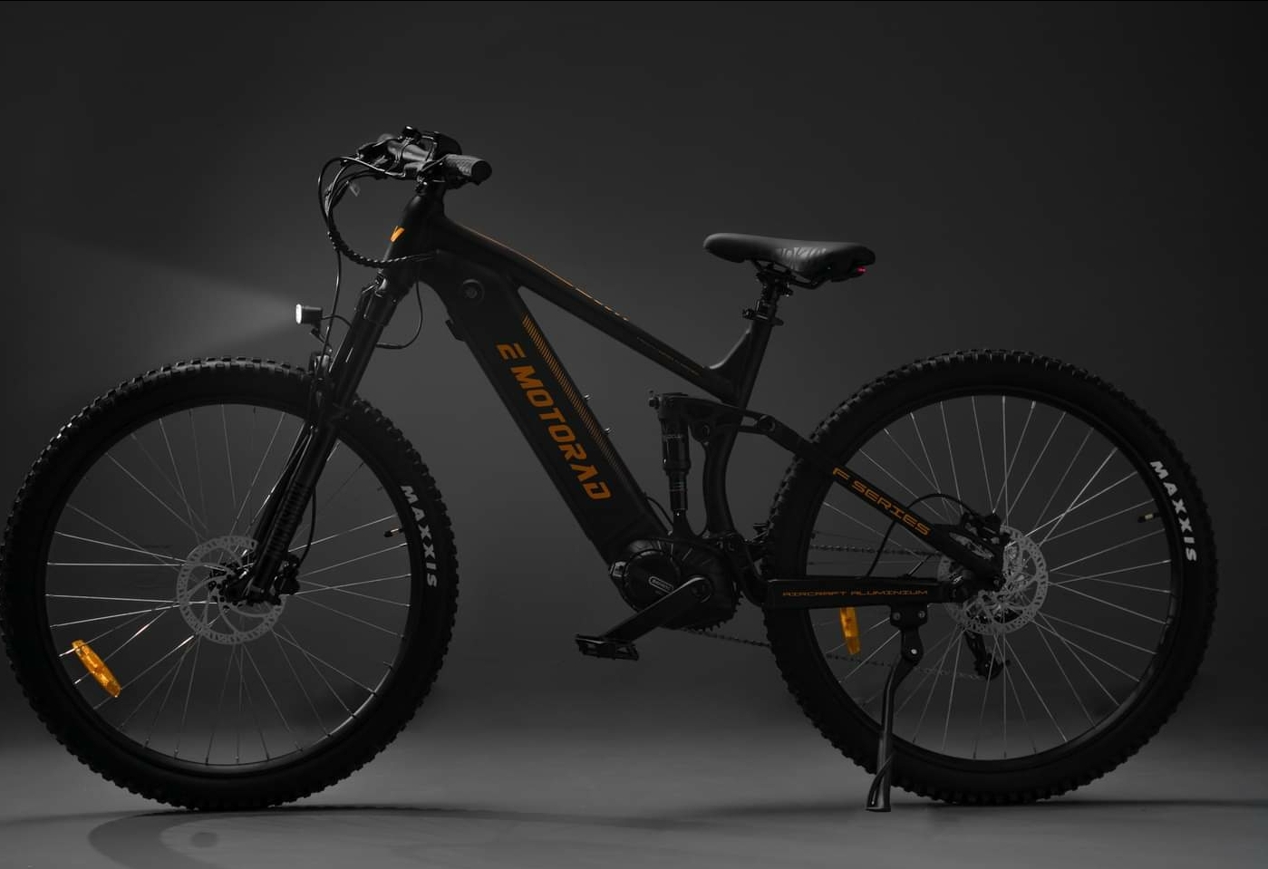

Good morning guys. I'm new to the forums and already see a lot of content I'm excited to dive into.
I have a question for the group.
I recently bought a 2023 EMotorad Athena. It comes with a Bafang M600 motor and was surprised that it is limited to a max speed of 25 km/H.
Another model I had tested was not limited so I was a bit disappointed.
So my question is if there is a way for me to increase the max speed in any way? I see other riders in my area blitzing by on their bikes (Cube, Trek, Specialized etc) and I am quite envious.
I hope someone here can help me out, point out what I need for the job and some instructions.
Thank you in advance.
Kyokushin
Mar 28, 2021
332
195
Sol
KK blackbox from @Dado is no brainer. I am using it and no better choice.
You may also buy the BESST interface, i have this one too, but if you want something for easy and 'daily' - pick the above blackbox.
