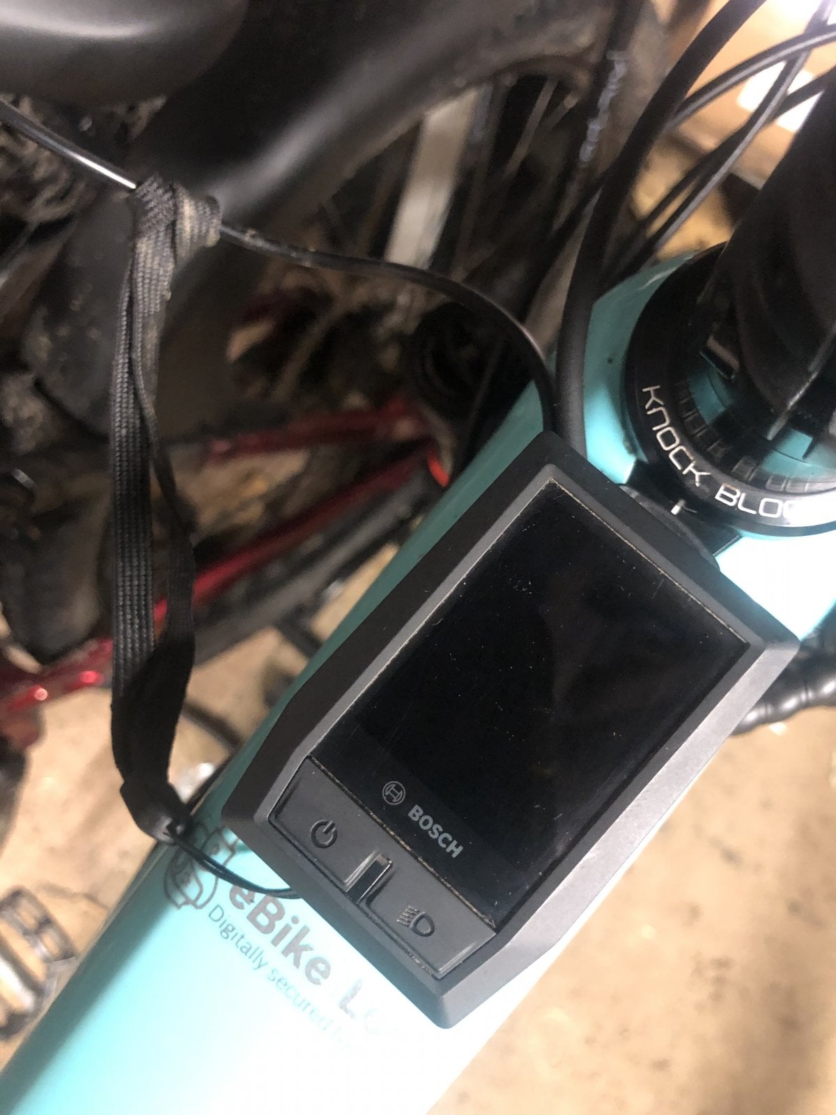

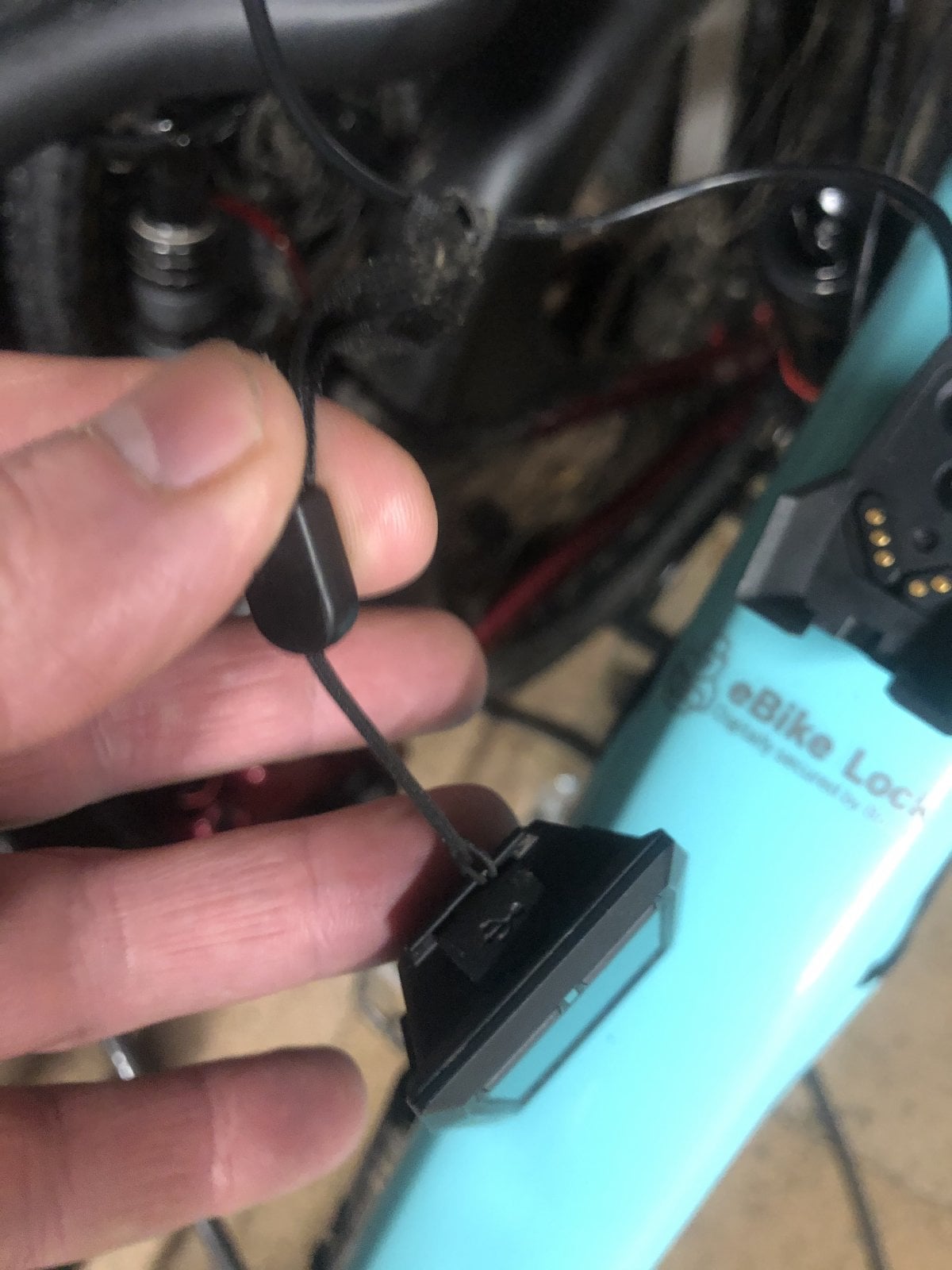

Regardless of where you mount the Kiox, a short tether or lanyard attached is important.
A mount for the stem is good location for me. I ordered the tube mount but changed my mind. I think what’s most important is that the Kiox can release magnetically in the event of a crash without losing it.
The tether is a great idea. I used an old phone / camera strap
