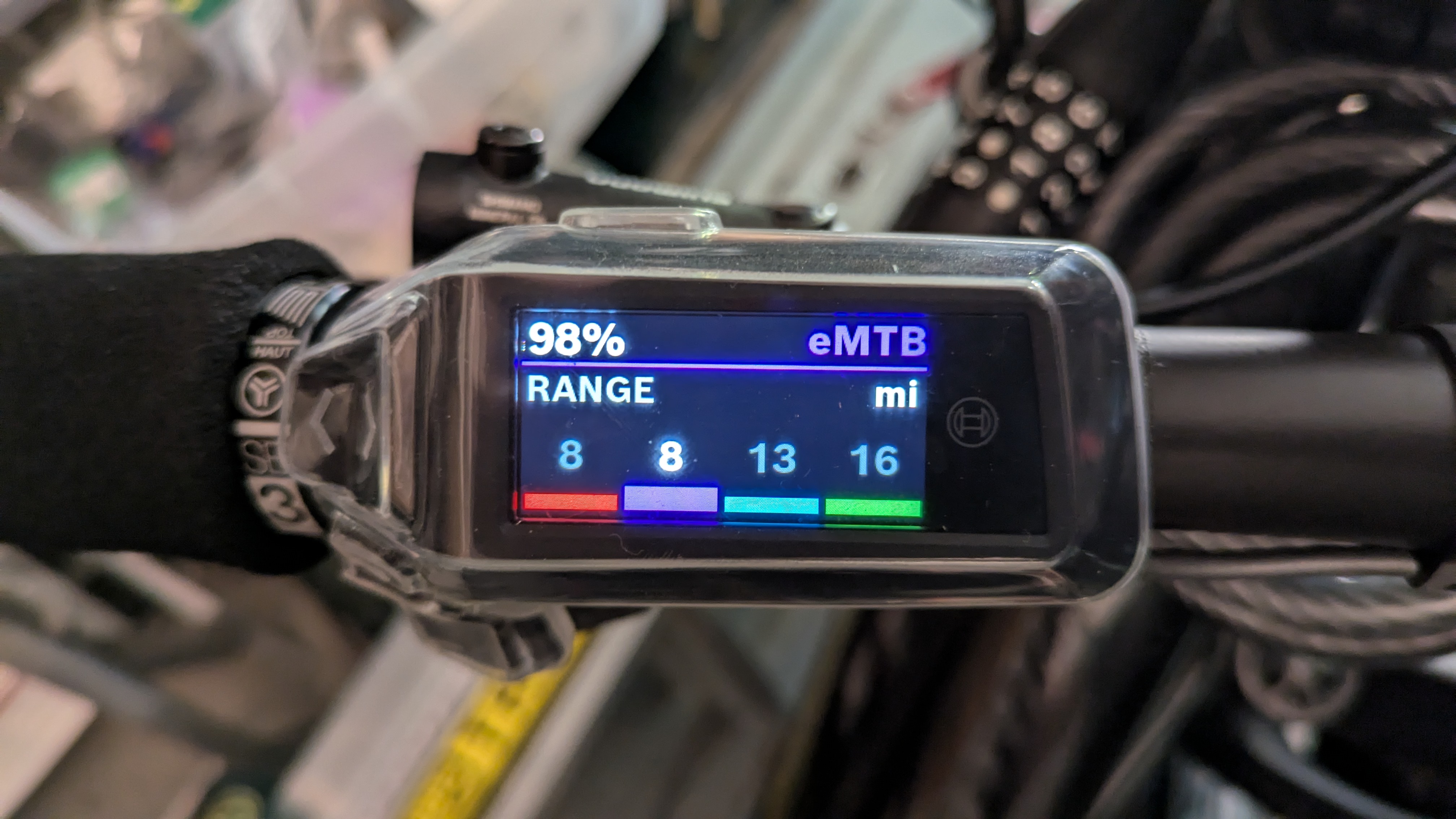

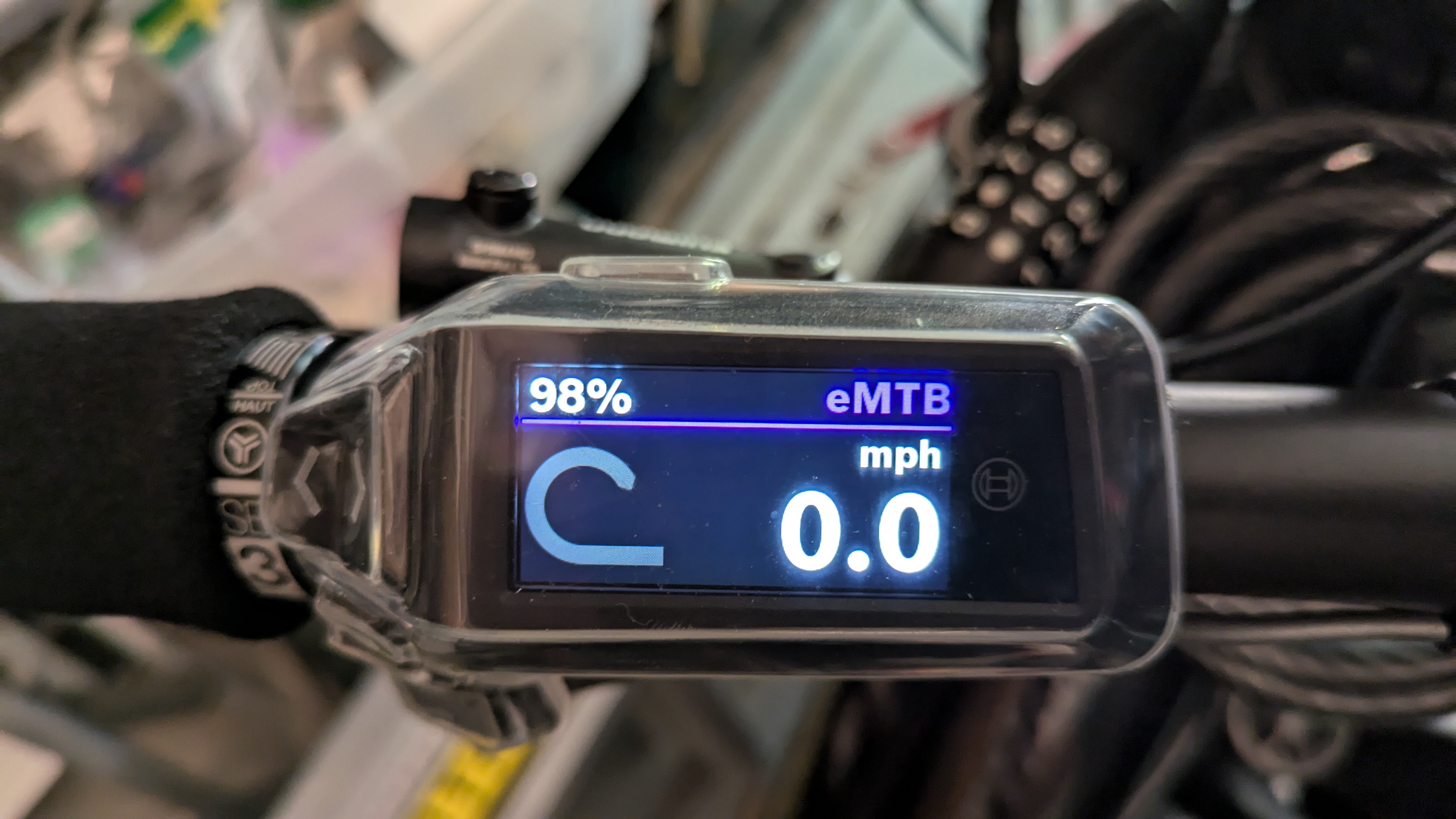

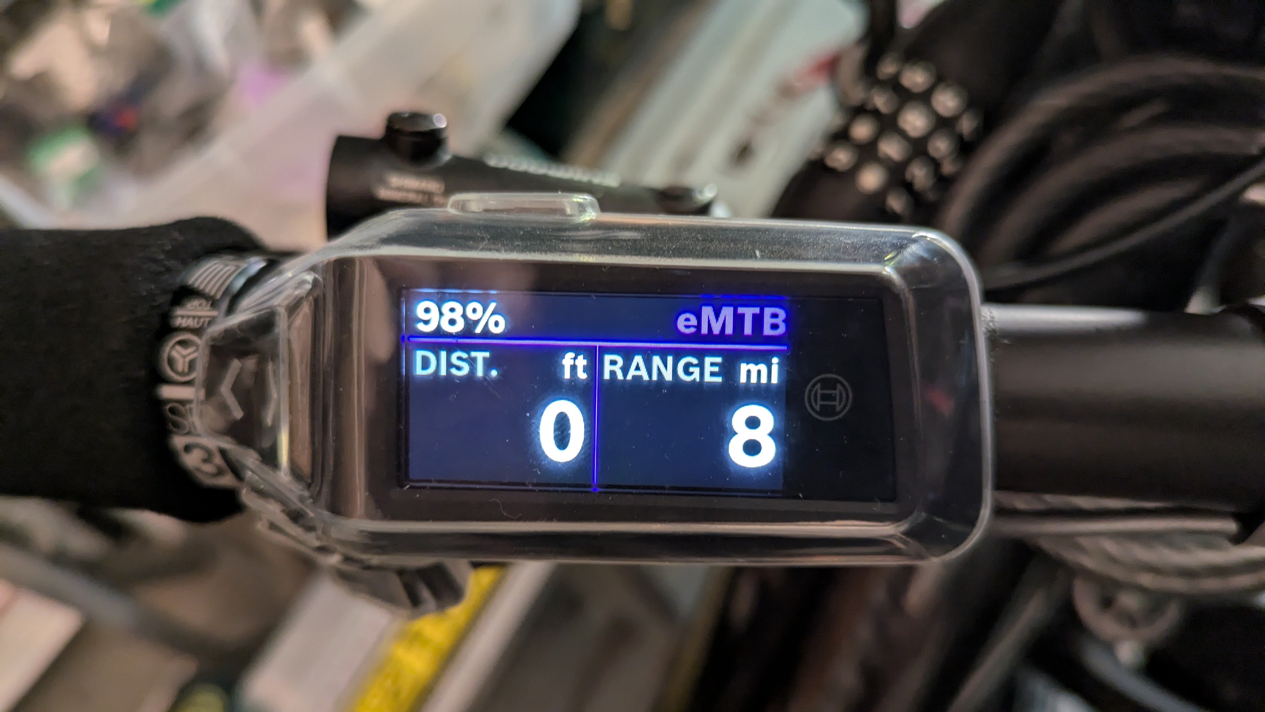

The latest Purion 200 update (don't know if it's relevant if you have the Kiox display), is excellent as you can customise the displayed info, by removing screens - (in my case the phone battery info), reorder them and even create your own, admittedly limited, info screen.
Yeah that's what I plan on doing, remove everything other than 1 screen really with the essential info I want, like battery range/percent and mode - everything else I can see on the kiox

You have to have the Speedo as one screen, so this is how I've set mine up;
