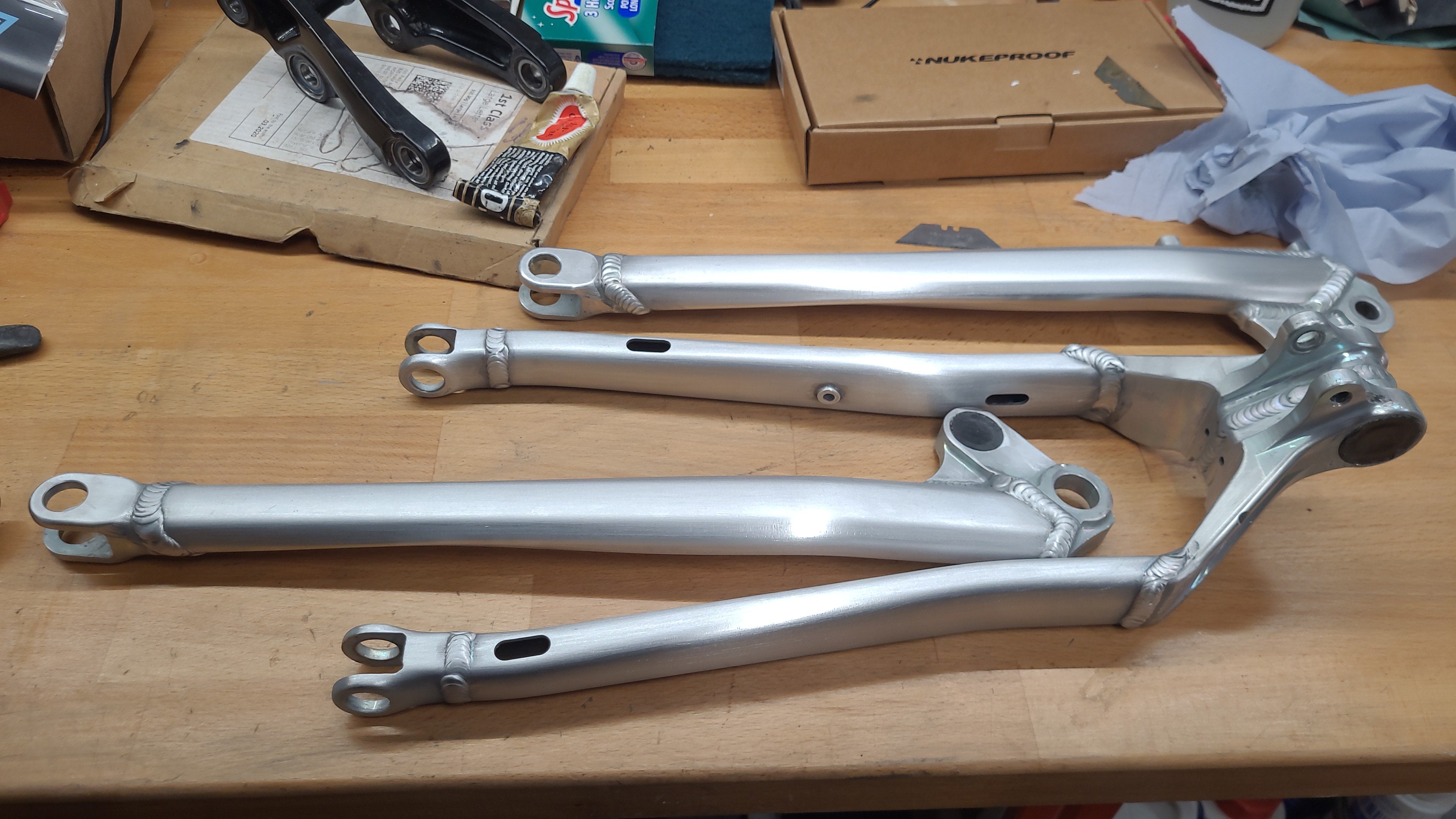

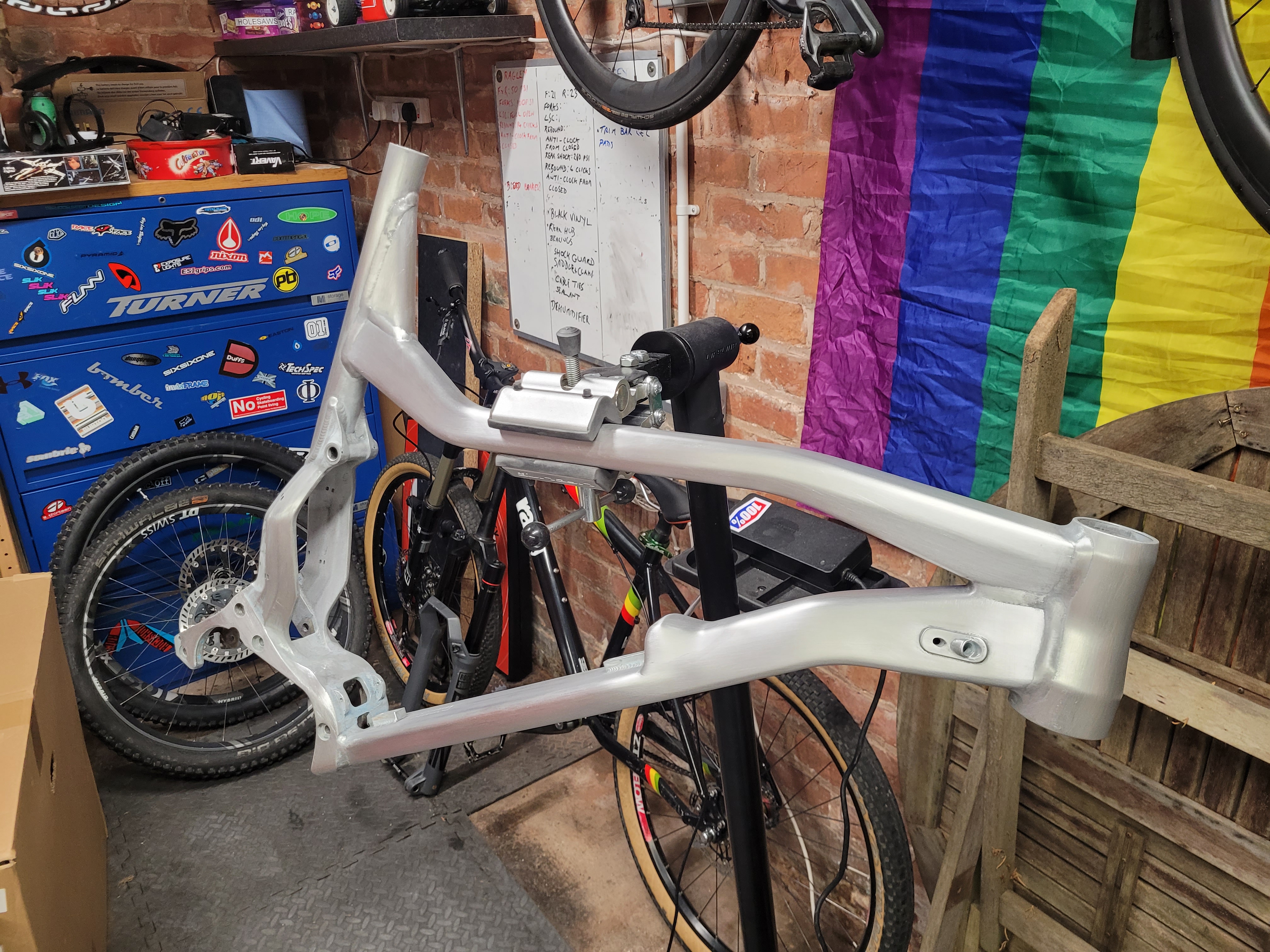

Paint was looking a bit tatty on the old girl and I had always wanted to raw a frame so decided to give it a go. Started off with this
Many hours with industrial paint stripper, sand paper and wet and dry later

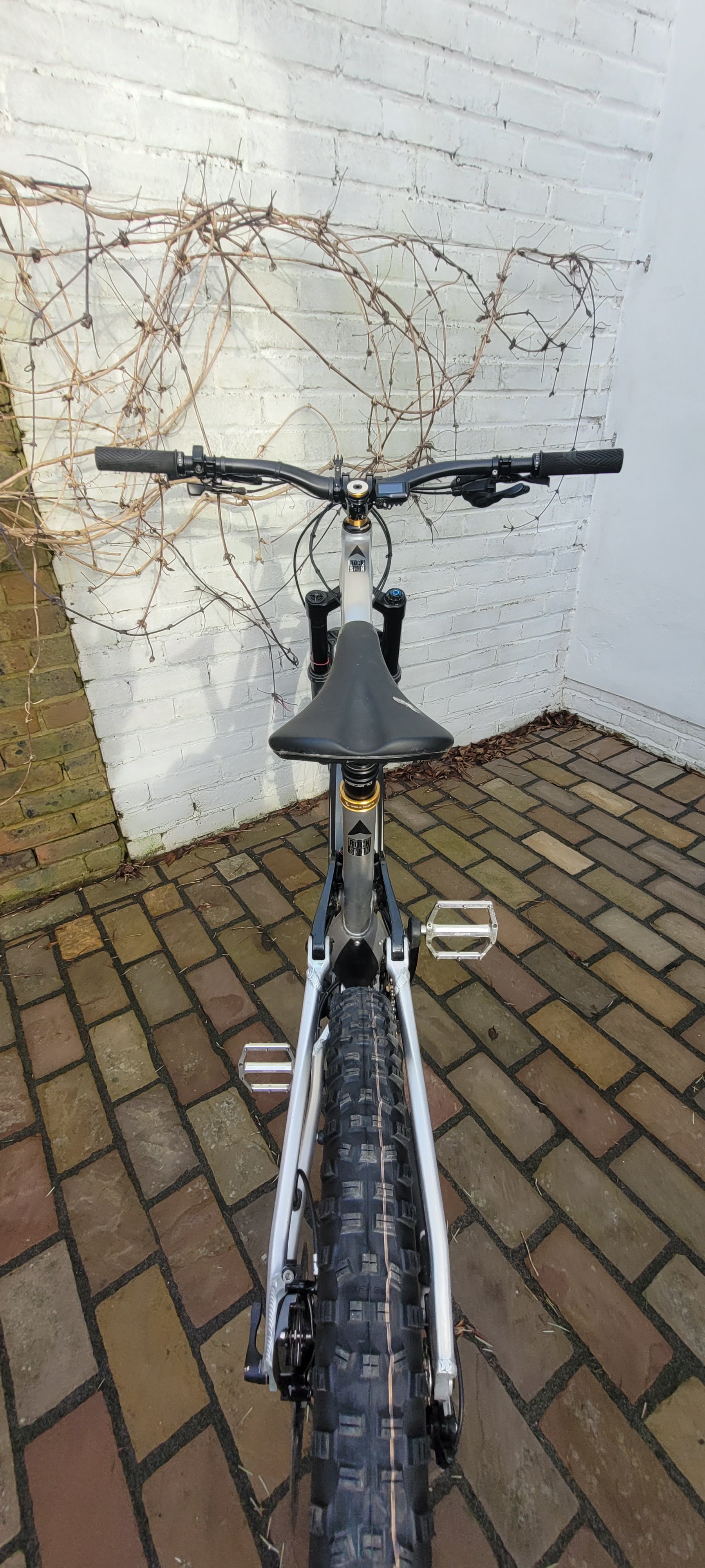

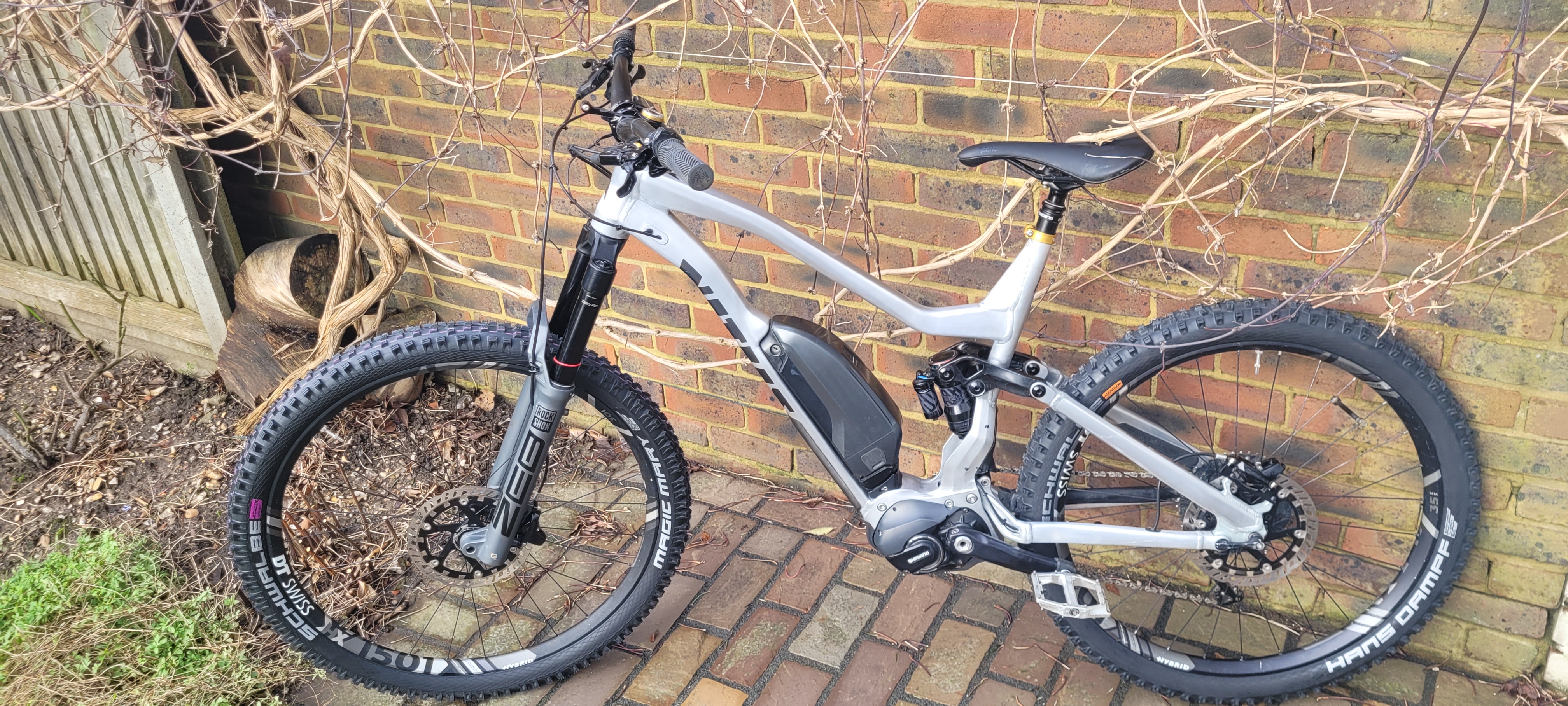

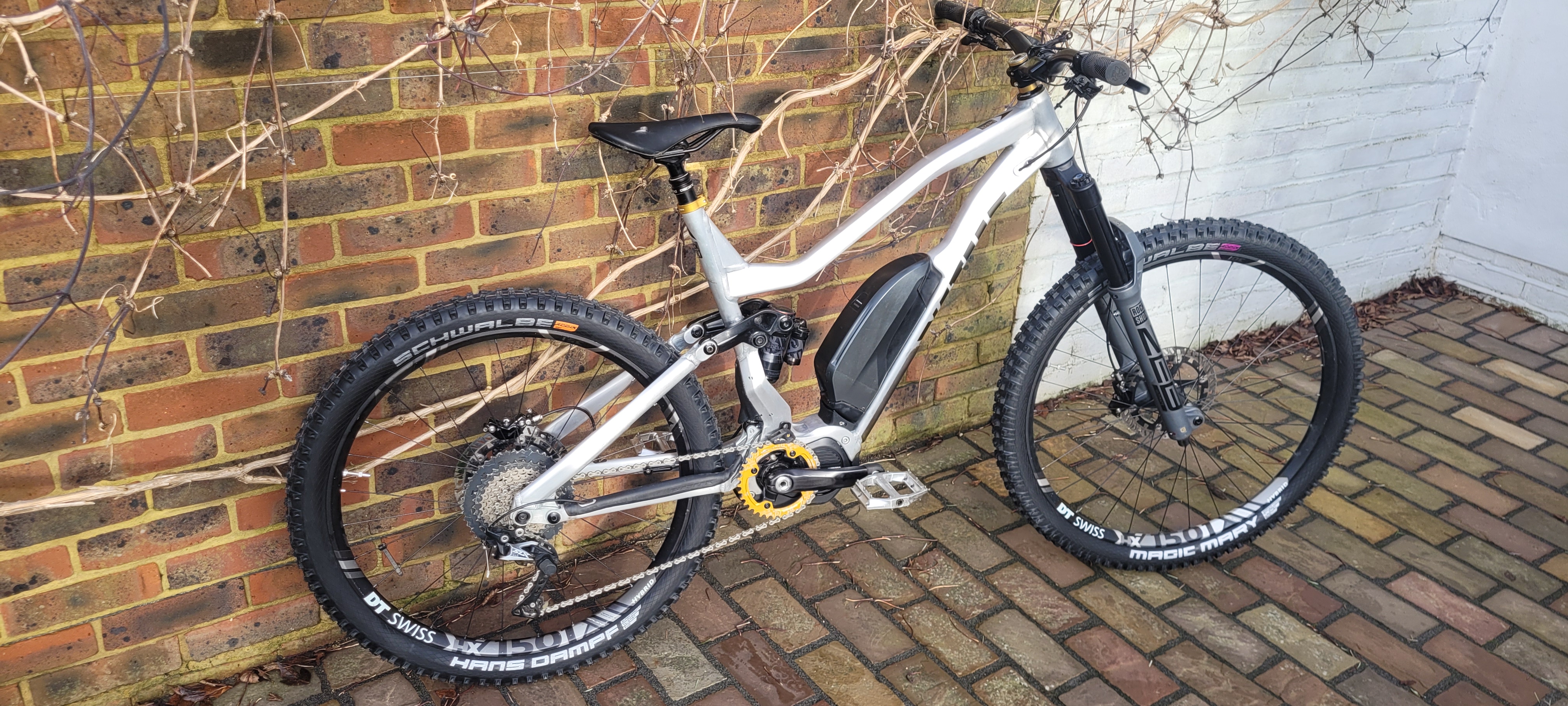

Quite pleased with how it turned out

So good. Looked into this a while back but it seems the chemical that strips paint has been removed from paintstripper 😒What type did you have to use?
davosaurusrex
Apr 21, 2018
614
365
Worthing
Starchem Synstrip. It's the proper stuff, I did it outdoors wearing chem gauntlets, eye protection and a decent mask. Even then it took quite a number of applications and further sanding. There is also filler around the top battery mount knuckle where it is welded to the frame, filled and sanded flat before painting, that was fairly stubborn to sand off
