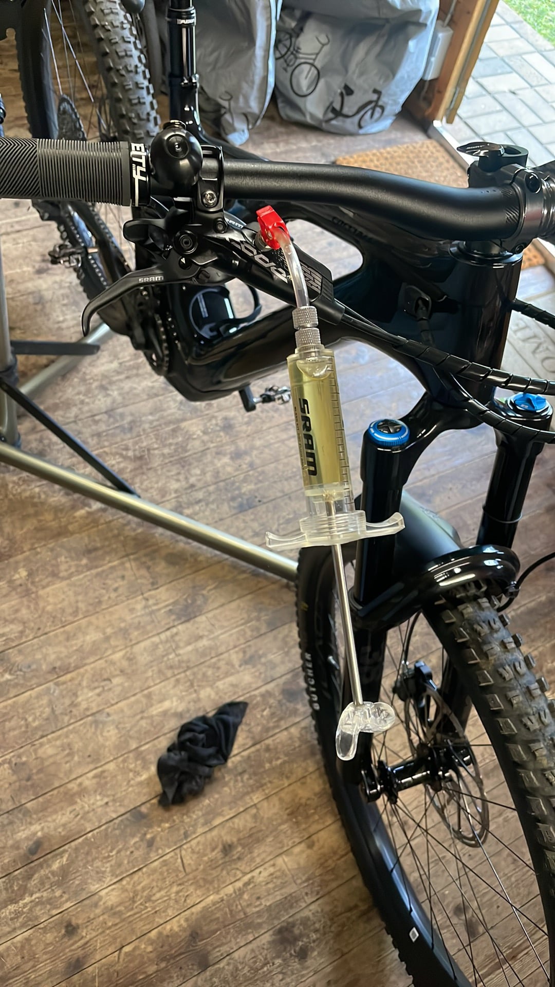

Hello. i am having some problems with the rear brake on my levo.
i noticed this after getting my new frame.
i have bled it with the sram bleed tool myself. and there is no air left in the system.
the lever is very firm with the block from the bleed kit installed. In the rear calliper If there still was air in the system i woud also feel it With the bleed block installed.
but when i instal the brake pads an squeeze the lever in need to turn the reach adjustment to the end to even have a bit of a functioning brake. I also noticed that it was adjusted like that before i started bleeding it. so it must be something i adjusted like that and did not really notice before.
i am almost 100% sure that there is no more air in the system, so i started looking at the rear calliper and the pads. What i noticed is the folowing. When i pull the lever the pistons come out push the pads out (yes thats how they work🤪). But when i release the lever the pistons completely return into the caliper. And this is what causes the strange feel in the lever and the need to adjust the reach on the lever to the end…
so what can cause this? is the spring that is between the pads to strong or bent to cause the pistons to go completely in, causing the long reach on the lever… Or did i mess something up with bleeding it?

did you set the lever at the correct distance from the centre of the bars before bleeding?
Tip of lever 80mm from centre of the bars. That sets the position of the piston in the lever reservoir.
You also have air and too much fluid in the lever syringe. The fluid should be soild from the syringe through to the flex tube.

Hello. Yes i did. that is where i noticed that the lever was adjusted to its max.
the picture is after my first try to bleed it. And did the last step in the procedure where you push and pull on the siringe to get the last air out of the system i have tried 2 more times after this but it does not get better…
