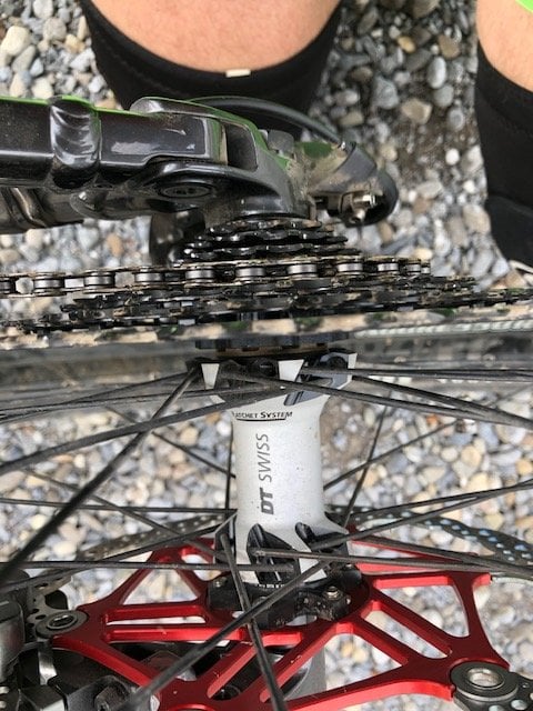

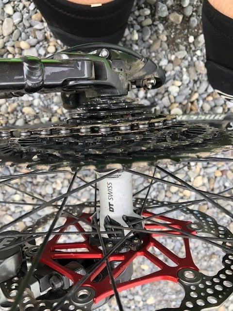

i'm having some trouble with my EX1. i am riding the meta power 29 2018 with ex EX1, and there is a terrible noise comming from the cassette when pedaling in 4th and 5th gear (counting from the hardest gear).
does anyone have an idea what this could be? i did about 400-500kg with it, cassette still looks fine to me.
i am posting a video and some pics from the cassette, maybe somebody can help me out with it

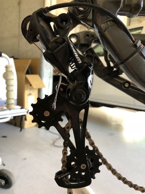

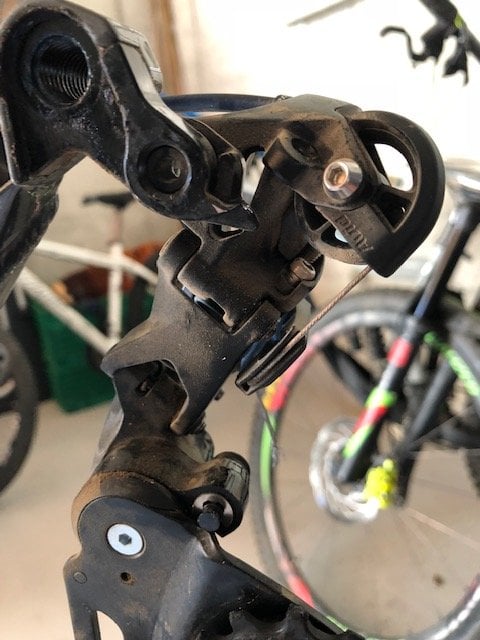

View attachment 6092 View attachment 6093
Do you have any pictures taken from this angle with the wheel in and the bike in gear where the noise is occurring? I'm hoping to see how close the jockey wheel is to the cassette. It could be hitting if the B-Screw is not correctly adjusted. SRAM may have a very specific measurement with respect to jockey wheel to cassette spacing. I know this applies to their 12 speed Eagle stuff and since this derailleur looks very similar I suspect the same applies to the 8 speed EX gear too.
Are you sure the derailleur has not taken a hit? The shift cable end is missing and there is what possibly looks like a scratch on the bottom edge of the lower hinge. It doesn't take much to put a derailleur hanger out of alignment (they are designed to bend/snap) and it's not easy to see until you put an alignment gauge on it. Any good bike shop mechanic should have one but personally for the amount of use it gets you are better off having your own. Yes, for what it is, a DAG is not cheap but it is one of those tools that you will be glad you have in your toolbox.

Almost for sure it will be the b screw tension , all of ours came with no where near enough clearance , have a look here , about half way down it shows the clearance setting being done with a template , but the gap is 22mm and easy to measure . It needs setting at your normal sag too , so iether get someone sitting on the bike or let the shock down to 30% sag before checking the gap
How to Correctly Adjust the Rear Derailleur on Your E-mountainbike | E-MOUNTAINBIKE Magazine
