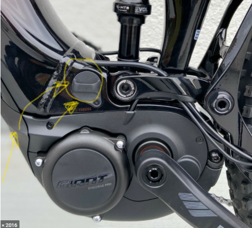

From the charging-Port on the bike to the pins in the bike connecting the battery is just a "through-connection" - I measured that.
So, there should be no difference than charging the battery externally with the charging-adapter.
But it is.... battery in the frame it charges mostly up to 70-80% than stops. Have to power cycle the charger, than it continues.
Battery outside the frame, charges without any problem.
I think there might me an interference with the bike-electronic, or a contact problem (but i cleaned and measured everything)
More and more people seams to have that problem. I told my dealer, I'll wait until this "famous" 10 charges and than it might work, otherwise the bike goes back for service...
thats the point, I can't understand why is this problem happening, has no sense.
I cant find the official Gaint statements, maybe somebody else has them?- but I believe the smart charger will automatically 6 amp charge off bike, and 4 amp charge on bike.
Perhaps the differance in charge rate is effecting charge cut-off?
Edit: I could not verify this using my power monitor. The charge rate current, at least at the wall outlet, was the same charging on and off the bike.
