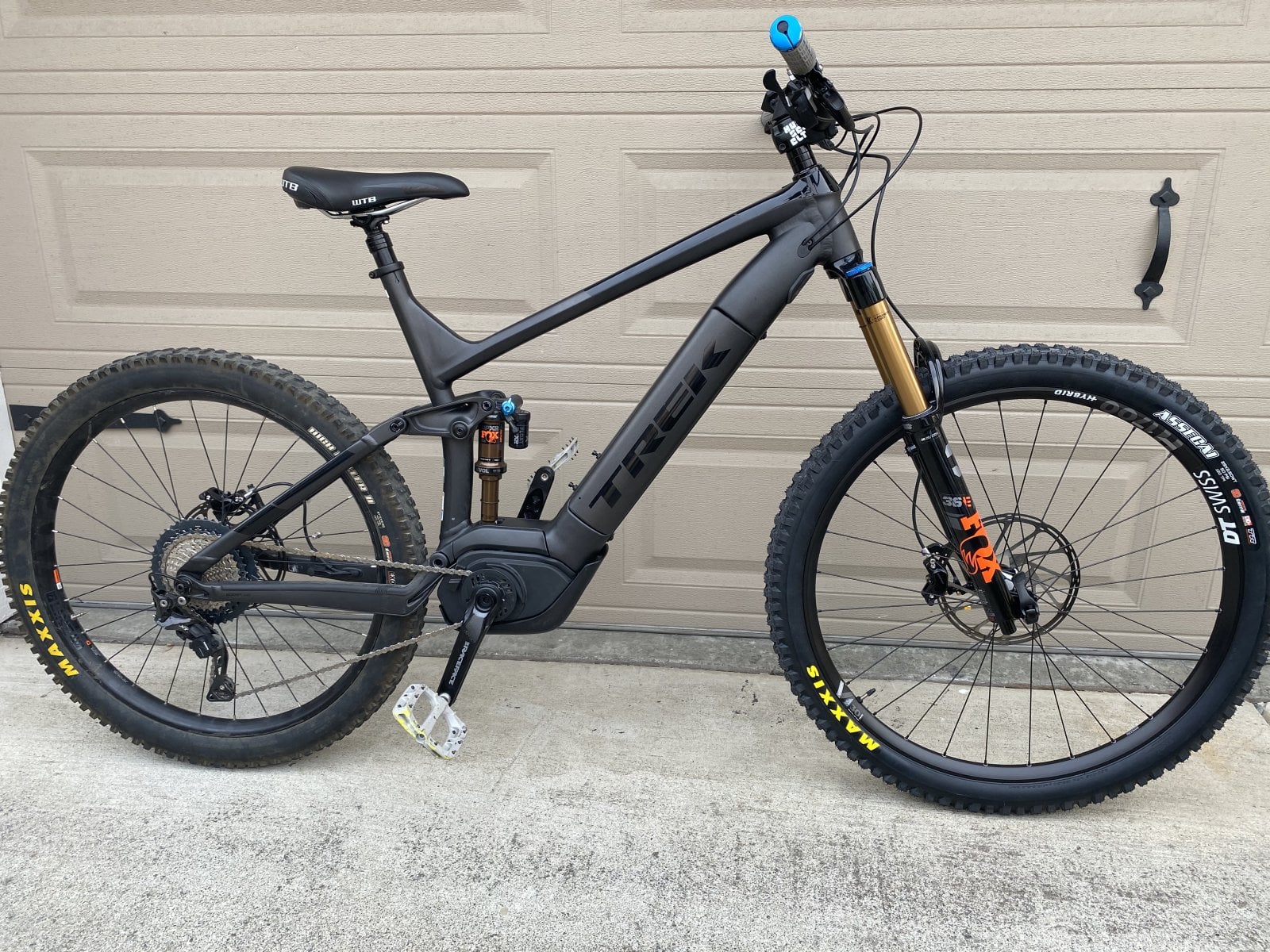

Greetings from smokey California. Been indoors too much the last few weeks. Spent that time drooling over the rail but decided to upgrade my PF instead. Can’t friggen wait to get back out now! Booyeah!

Is that a Powerfly 2019?
That's what I have; wondering if I could do that to my bike as well.
And what width are those tires?
Yep 2019. You likely can! Originally wanted the LT version(Light grey) of this but liked the black. Identical frame. Replaced the stem with a shorter one. Replaced the rear shock with one with a longer stroke. Fork is a 29er 36. Front tire is a 29-2.5w and the rear is 27.5- 2.6w.

So I guess you had to replace the fork to fit the 29er wheel. How much travel do you have on that fork?
And can I ask, exactly what did you replace the rear shock with? And it fit, without having to do anything else?

Fork is 160mm travel. Shock is a DPX2 205 x 60. No issues with fit. The eye to eye is the same, and the stroke is 10mm more which is similar to the powerfly LT with the same frame.
