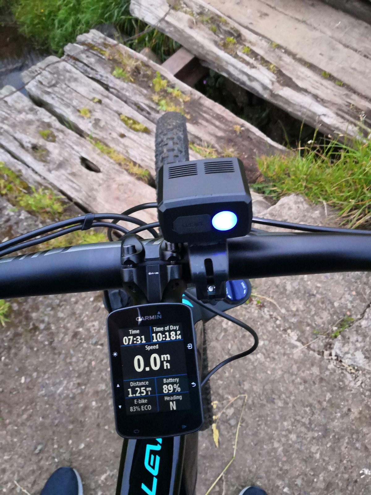

I also purchased a Garmin 520 plus on Fathers day as there was an extra 10% making Halfords the cheapest place to buy new. Came with the out front mount though, which looks odd on the Levo I thought so I ordered a budget step top cap from ebay (should arrive today so looking forward to fitting).
I also have a small saddle bag for basic tools. Will likely fit some small basic mud guards but like the clean look.
Finally I snapped by Blevo while I had some free Android app store credit. I like supporting cottage app development for products. I hadn't realised I could actually use it to up my speed support, will be tinkering with that tonight. I'll be giggling like a school girls if I can get assistance up to 20+mph (which is my own upper cruising speed anyway but I soon buckle keeping the power going).

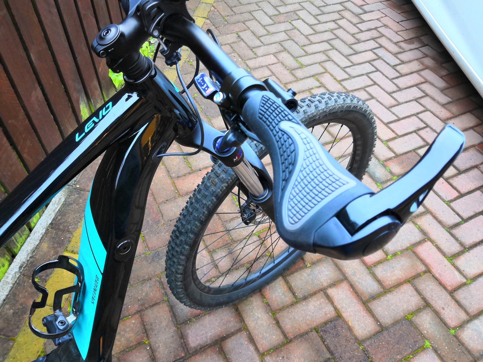

Fitted some more ergonomic (for me) grips. Large palm area saves my wrists a bit and when I'm going for it on a short road section I can grab the alloy grips at the sides.
Maybe not the prettiest, but do the job, low cost ebay items and 2 mins to swap back to the original specialized grips. IMG_20190624_205736.jpg

Also fitted a stem mount for my garmin. £3.99 from ebay. Decent secure fit to garmin but a smidge loose so u added some strips of electrical tape to upper face of mount to put a little grip force into back of garmin.
Went out on a bumpy ride and it was secure.
Also fitted a little bike light. Allegedly 600lumens. 2 small leds. Says they are xlm t6, not sure myself but even if they are the battery is small so wont last much over 1 1/2 hours on a charge. Pretty bright though and can be removed in seconds. IMG_20190625_221833.jpg

I used to have similar grips with the bar ends, by Ergon. They do the job they are meant to do very well indeed, but once I started to ride singletrack in the woods, the bar ends had to go! They kept snagging on the shrubbery and yanking me off the bike. :eek:
To swap them back just for the road trips was never considered. Once I had discovered off-road, there was no going back. I do it, but I am not at all keen to bike on the road.
Good point that I got stuck on a metal gate yesterday just leading it through lol. They may not last long. Shame as they put me into a more comfortable position when on road sections.
I don't like road either, just want off ASAP hence I nail it. First time I snag those grips on a trail though and I bet I change them lol
