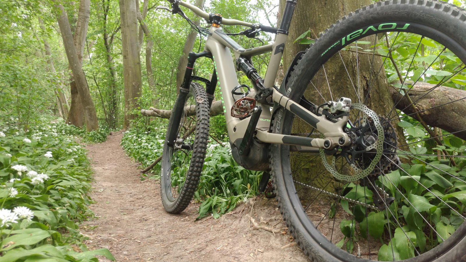

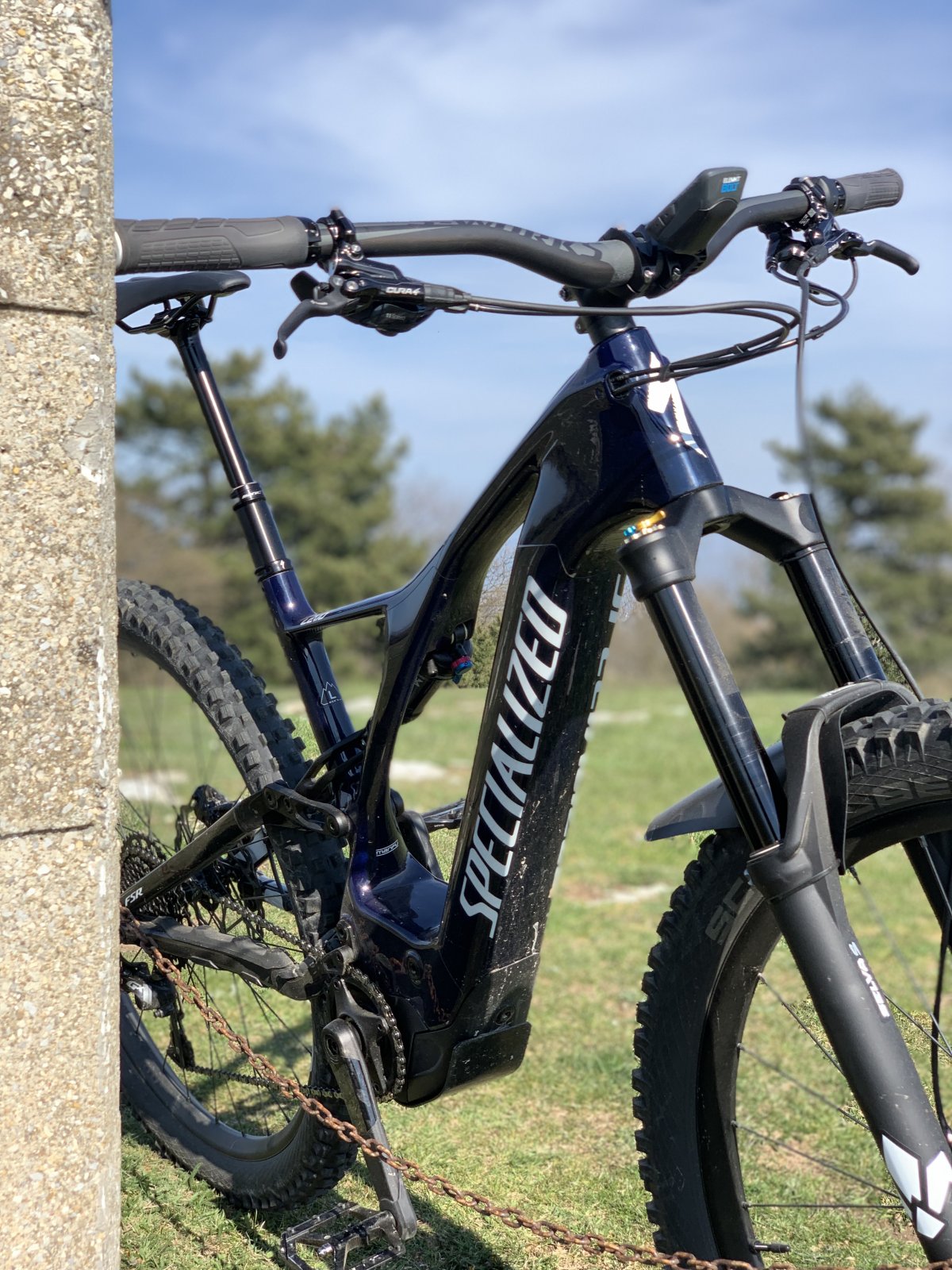

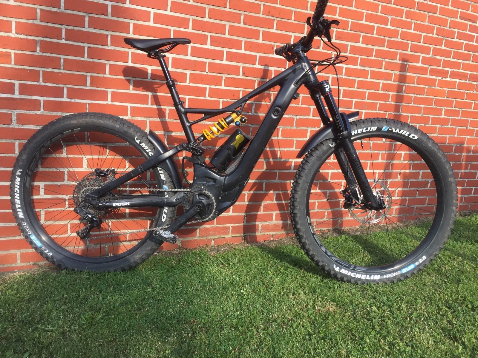

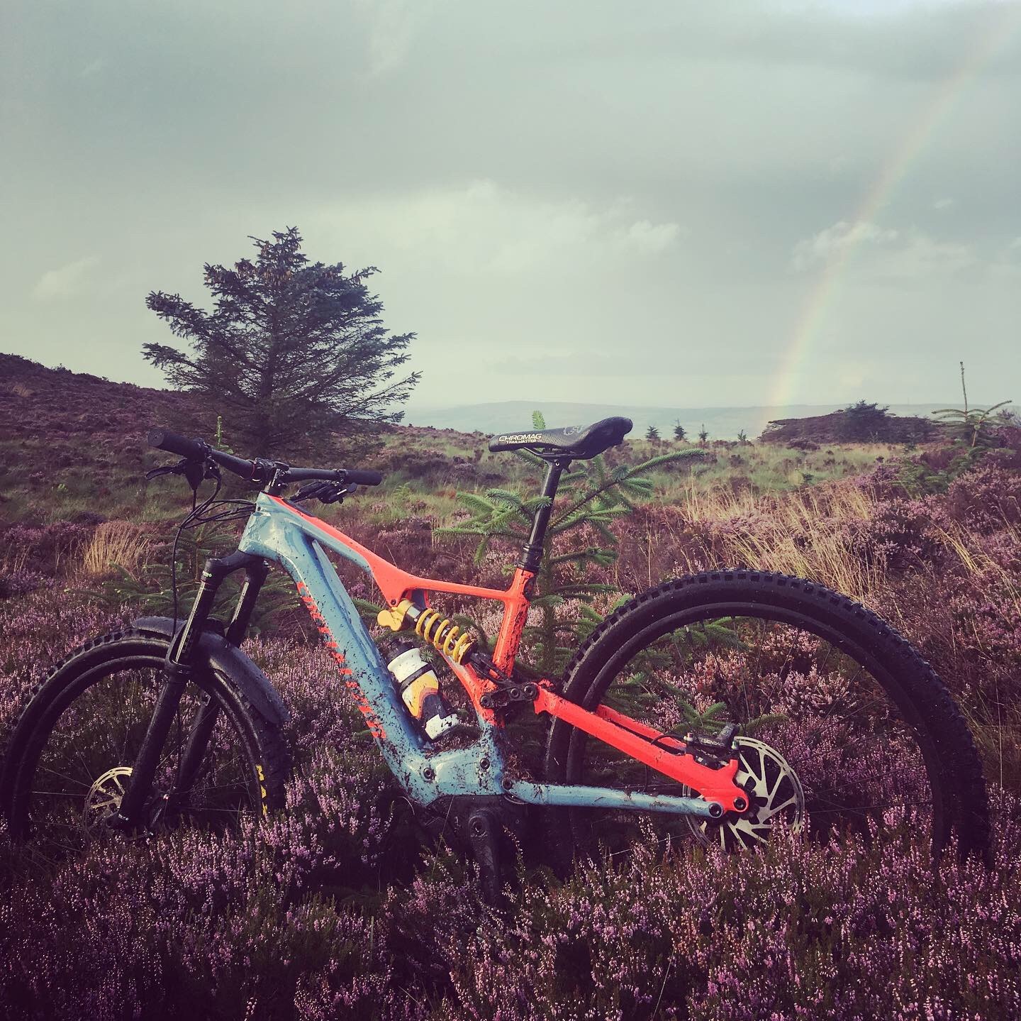

Love how it ride this levo.
Öhlins EVO 150mm&TTX coil Shock!!
StuR
Apr 28, 2018
449
730
Forest of Dean

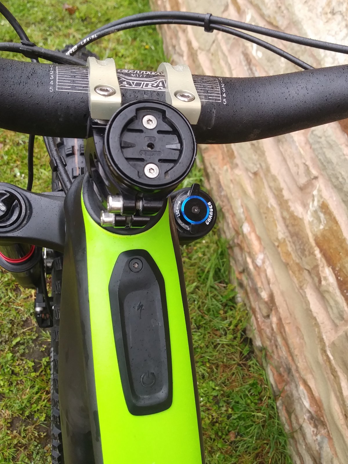

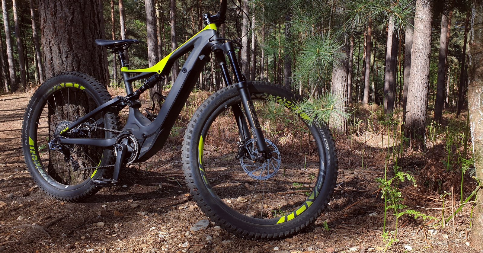

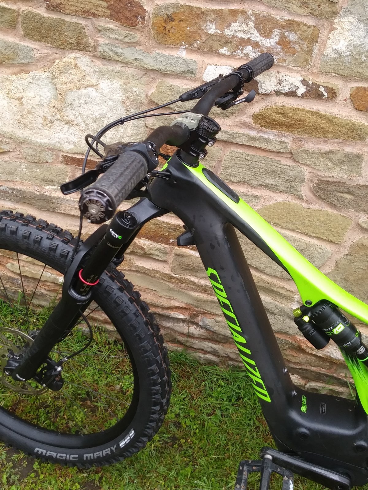

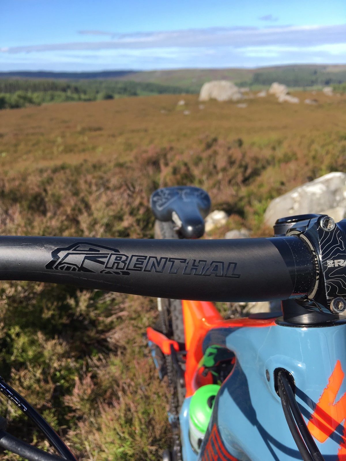

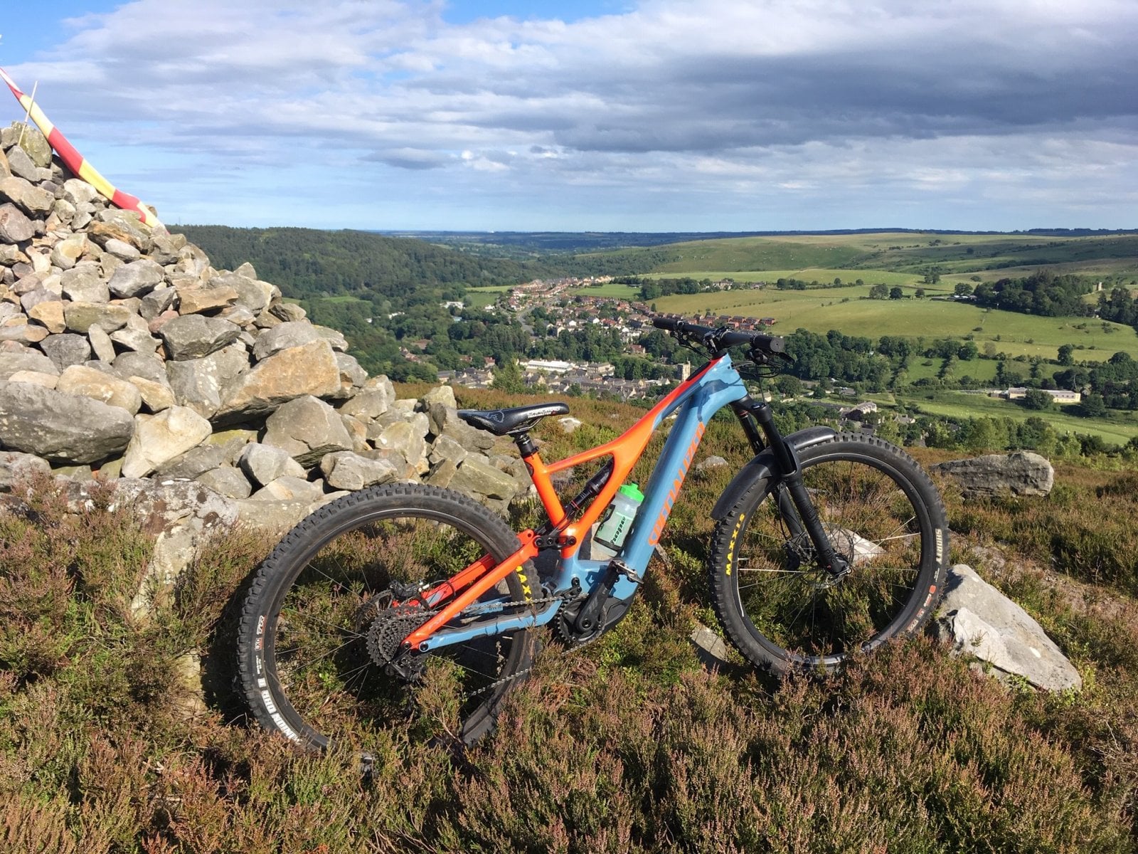

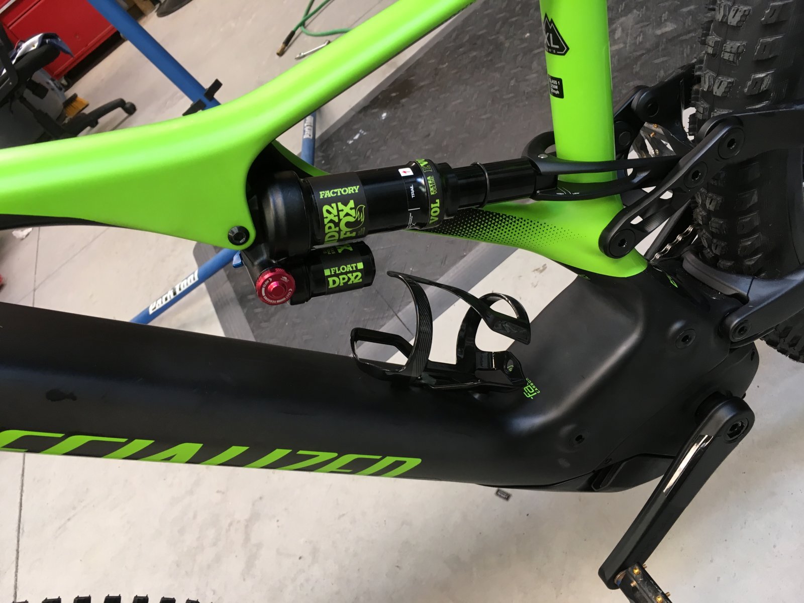

Been tweaking my Levo Expert 19
Mods so far -
Shaft upgrade to Pike fork - 160mm travel
DVO Topaz shock 210 x 55 - 157mm travel
Running 27.5 wheels from an 18 Levo
Magic Mary 2.8 soft compound (Orange)at front
Standard Butcher Grid 2.8 at the rear
Raceface Chester pedals
Renthal 800mm Fatbar
Renthal 31mm stem
K-Edge steerer tube Garmin mount
Revgrips - (pro , large)
Observations -
Chuffing Awesome !!
Super Plush and confidence inspiring
Bulldozes through the lumpy stuff but still nimble
Still playing with 27.5 v 29 v 27.5/29 wheel combo but I think I prefer the 27.5 with 2.8 tyres
Switching to 27.5 with tyres as above lowered the bottom bracket about 13mm.
Lengthing the fork to 160mm and flipping the shock chip to High has raised it back up about 6 mm .So BB is now about 7 mm lower than with standard 29er
No pedal strikes , although I am being careful of pedal position through the rough stuff.
Head and seat angle barely changed
Potential Further Upgrades -
Crank Bros Lithium wheels are seducing me
Some sexy coloured disc rotors like Hope are turning my head as well
Rear tyre needs some attention - Butcher is ok in the dry and rolls well but is worse than useless in the wet .Probably swap it around with something else (not decided on what yet) depending on conditions.
Sump guard for motor/battery

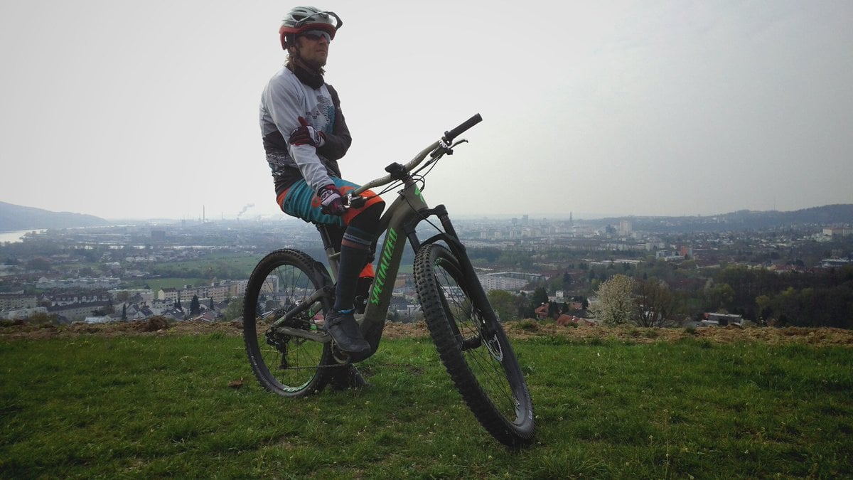

jemen
Jun 1, 2018
317
379
Austria

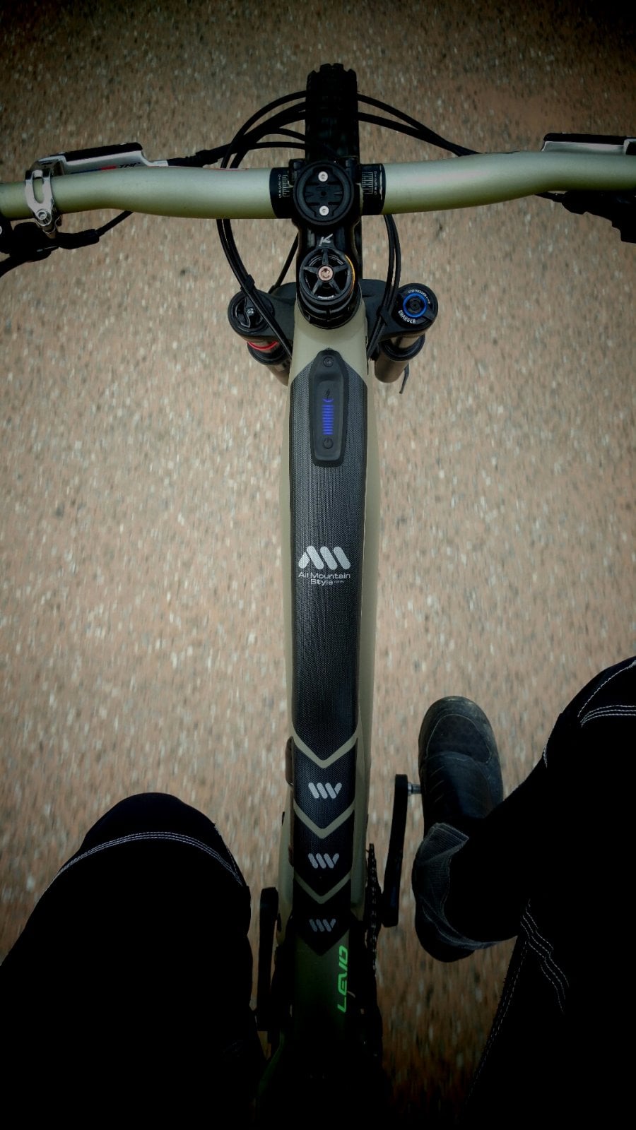

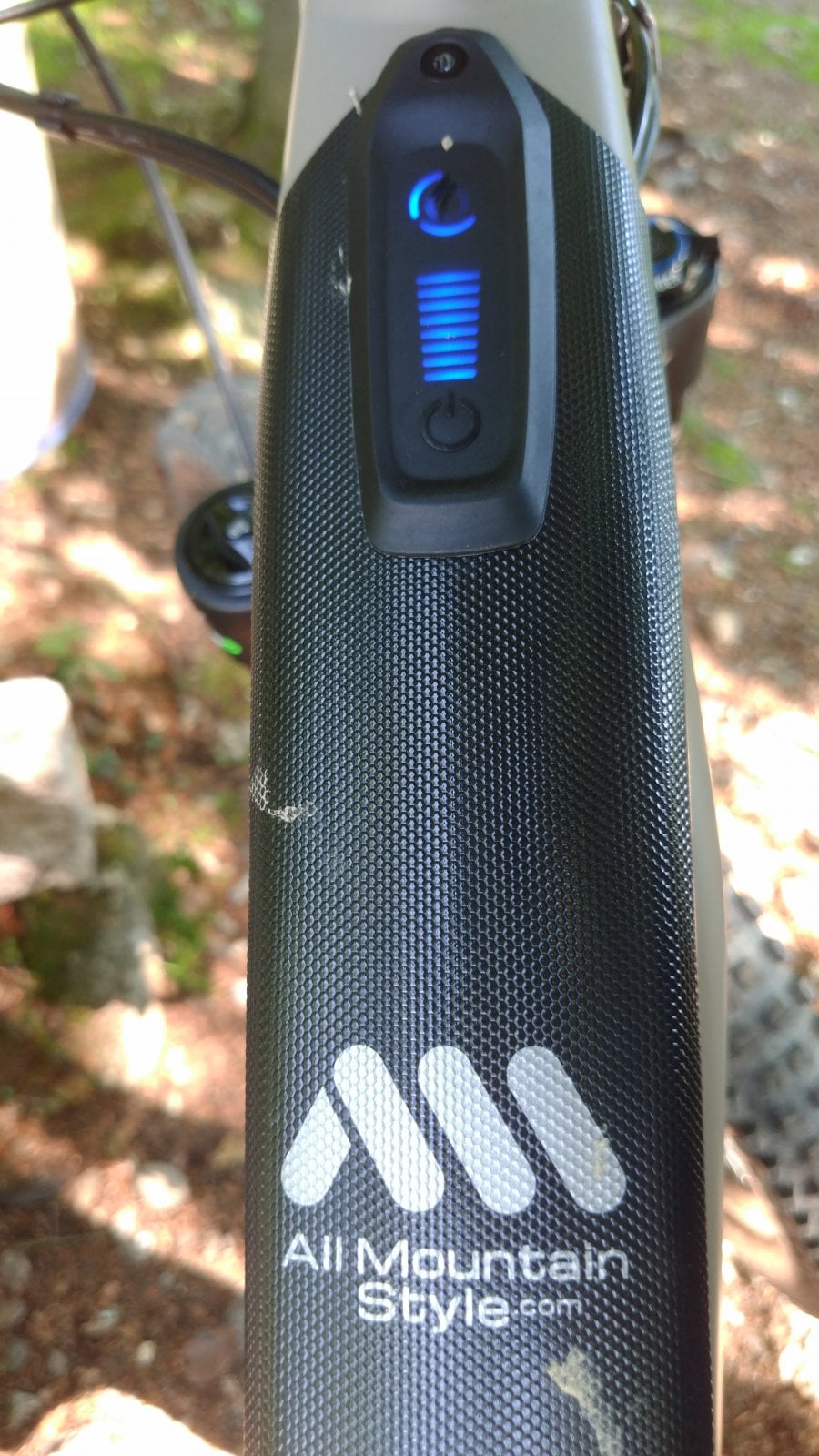

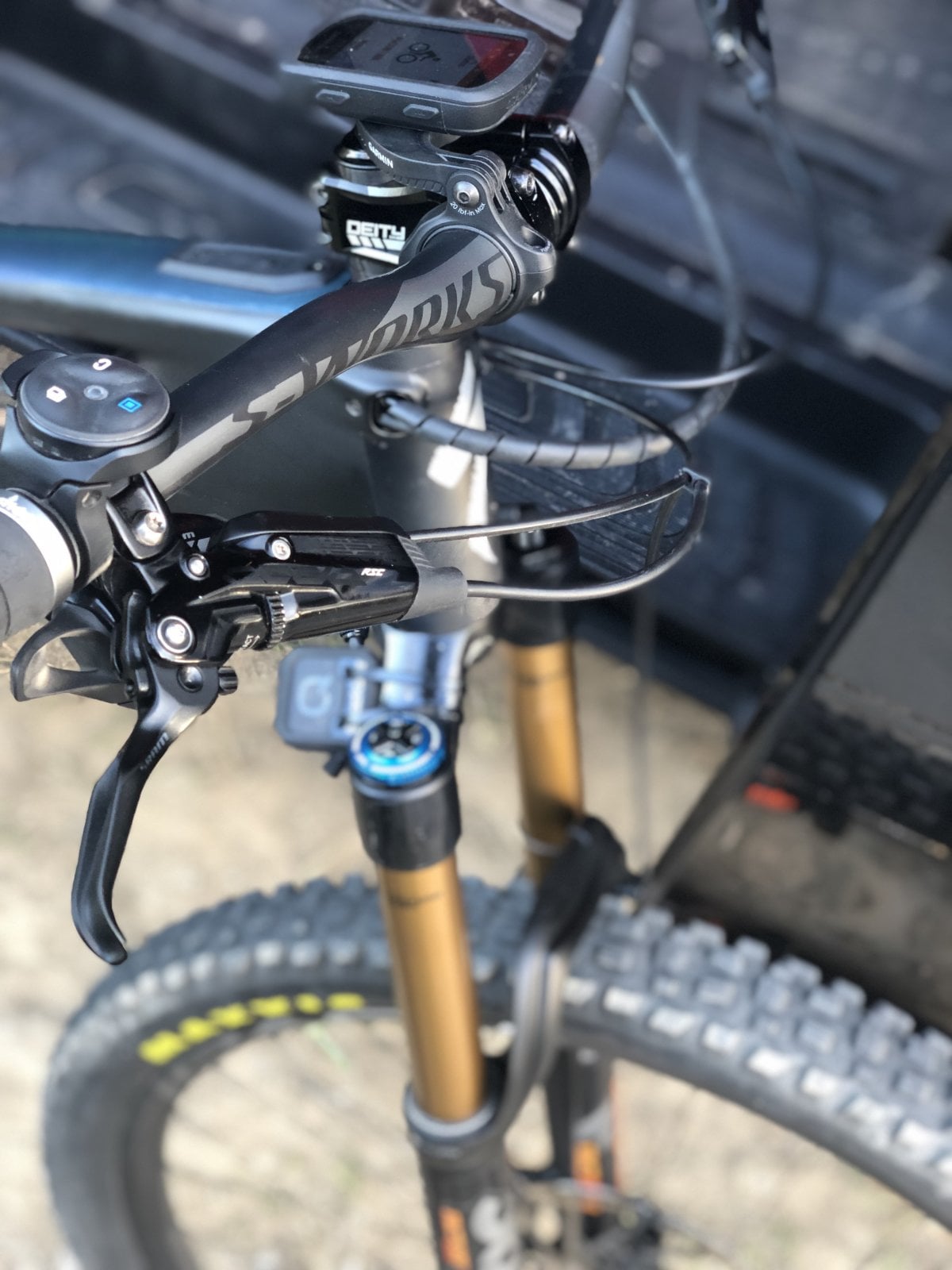

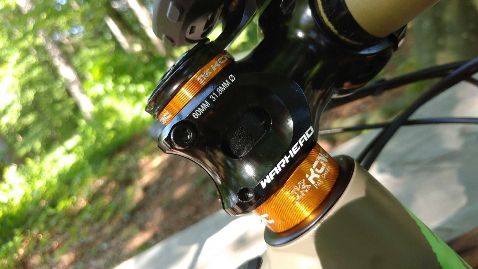

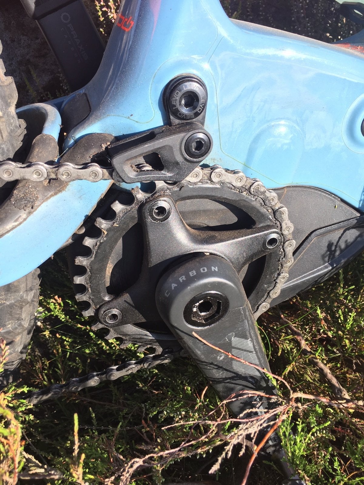

Minor recent changes compared to my last years Carbon Expert:
Allmountainstyle frameguard
TRP Quadiem DH Brakes & Discs (I recommend them hardly)
Rockguardz Carbon Mudguard
Nukeproof Warhead Stem
KCNC Spacers
Renthal Carbon Handlebar
Renthal Chainring with ethirteen bolts
WTB Silverado Saddle
Nukeproof Horizon Pedals
K-Edge Garmin Holder
Upcoming changes:
Michelin Wild Enduro Tires
HT X2 Pedals (for more release angle)

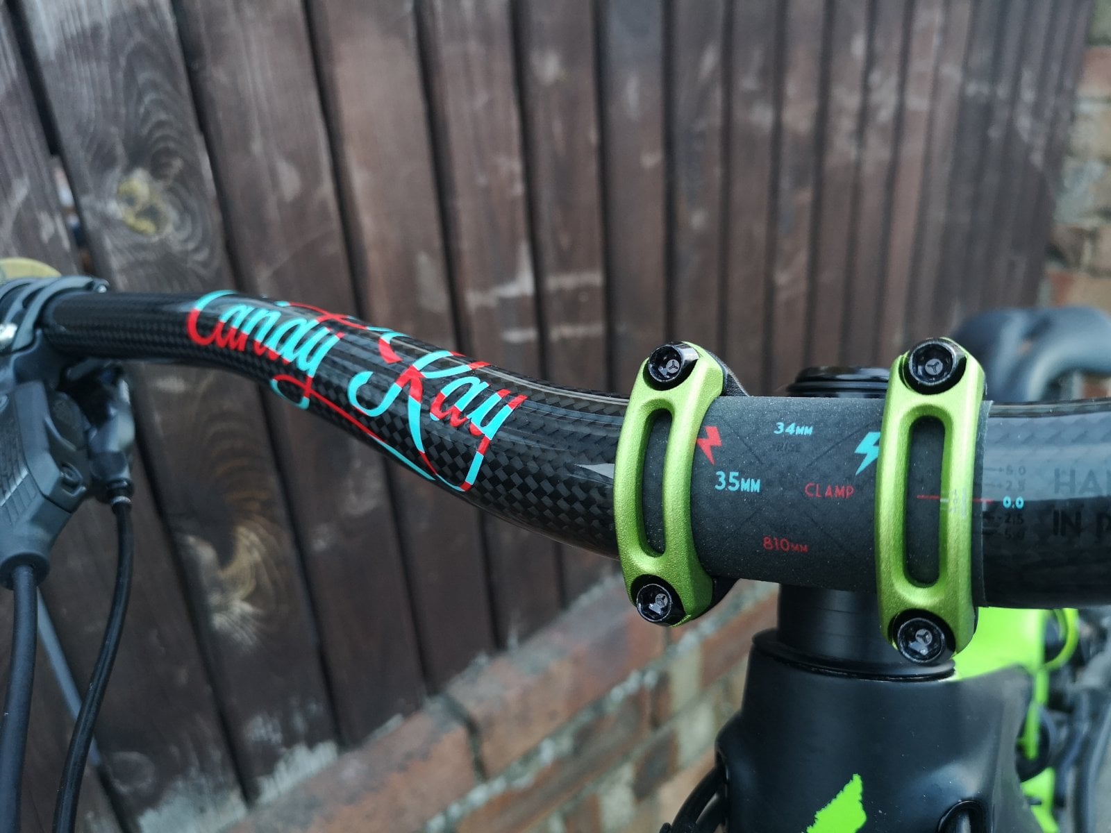

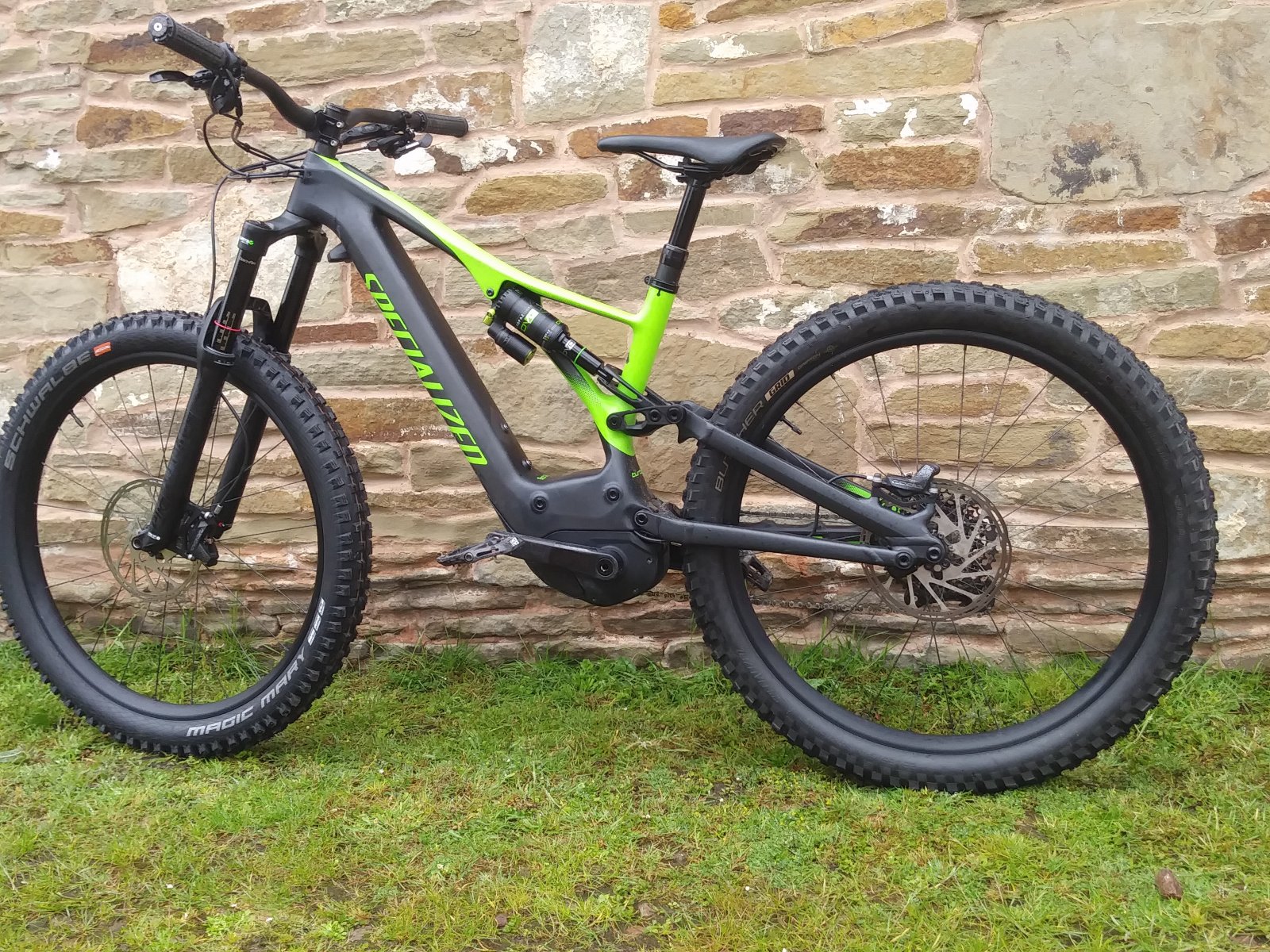

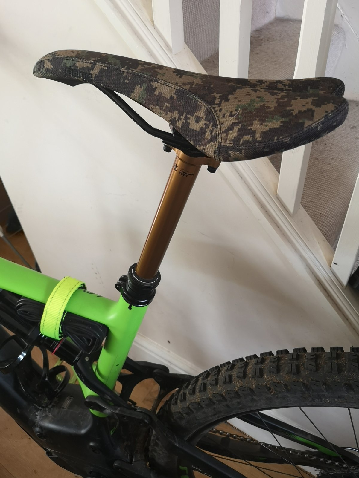

JonnyLevo34
Jun 23, 2019
26
28
Kent

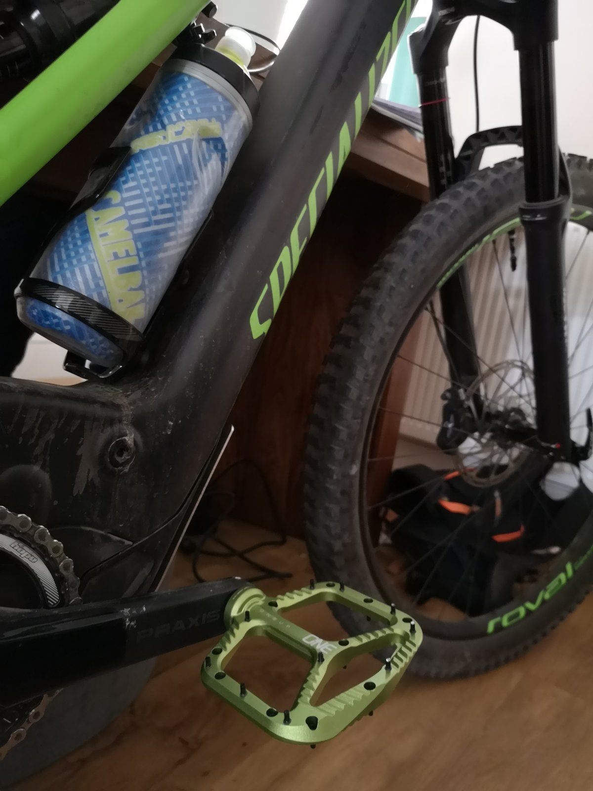

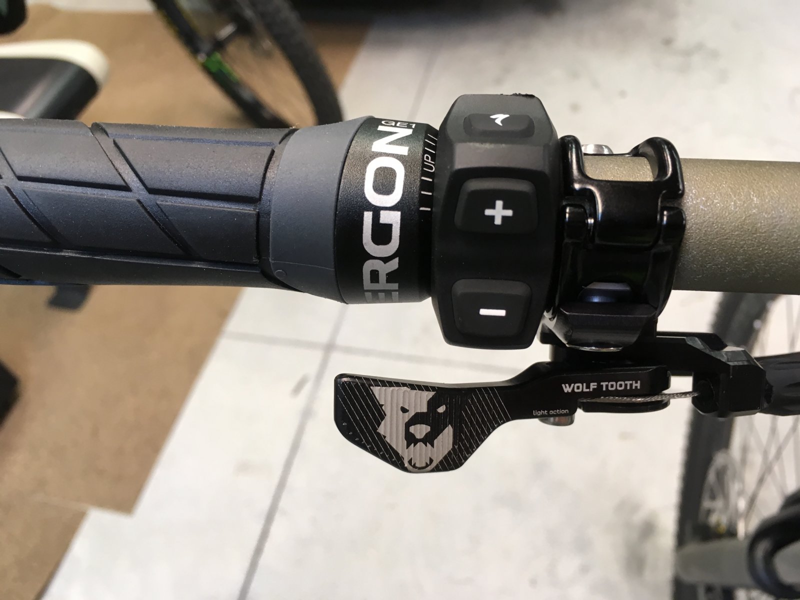

Candy Ray bars 35 810mm with 34mm rise
Spank Split 35 stem
Fox factory dropper (30.9 with a shim off of old bike)
Wolftooth dropper lever
Charge spoon saddle
Schwalbe Magic Mary 2.6x29 orange front and rear
OneUp components alloy pedals (still unsure of these and may go back to DMR Vaults V2)

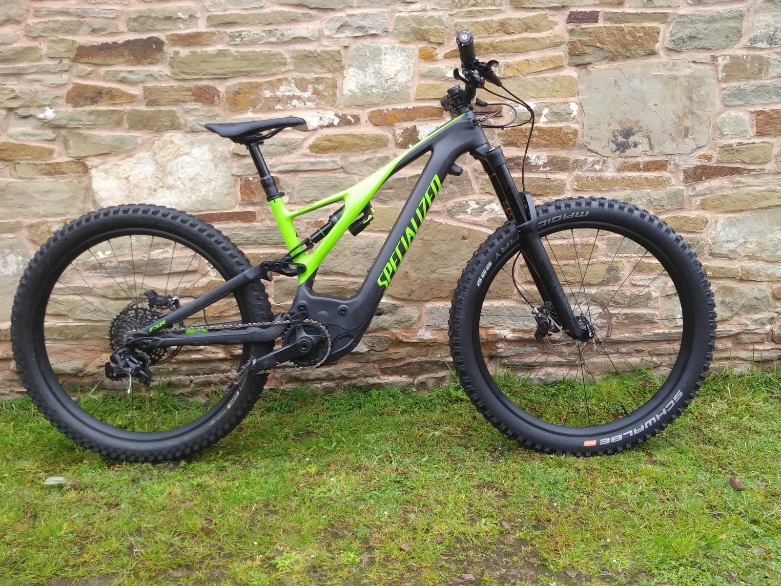

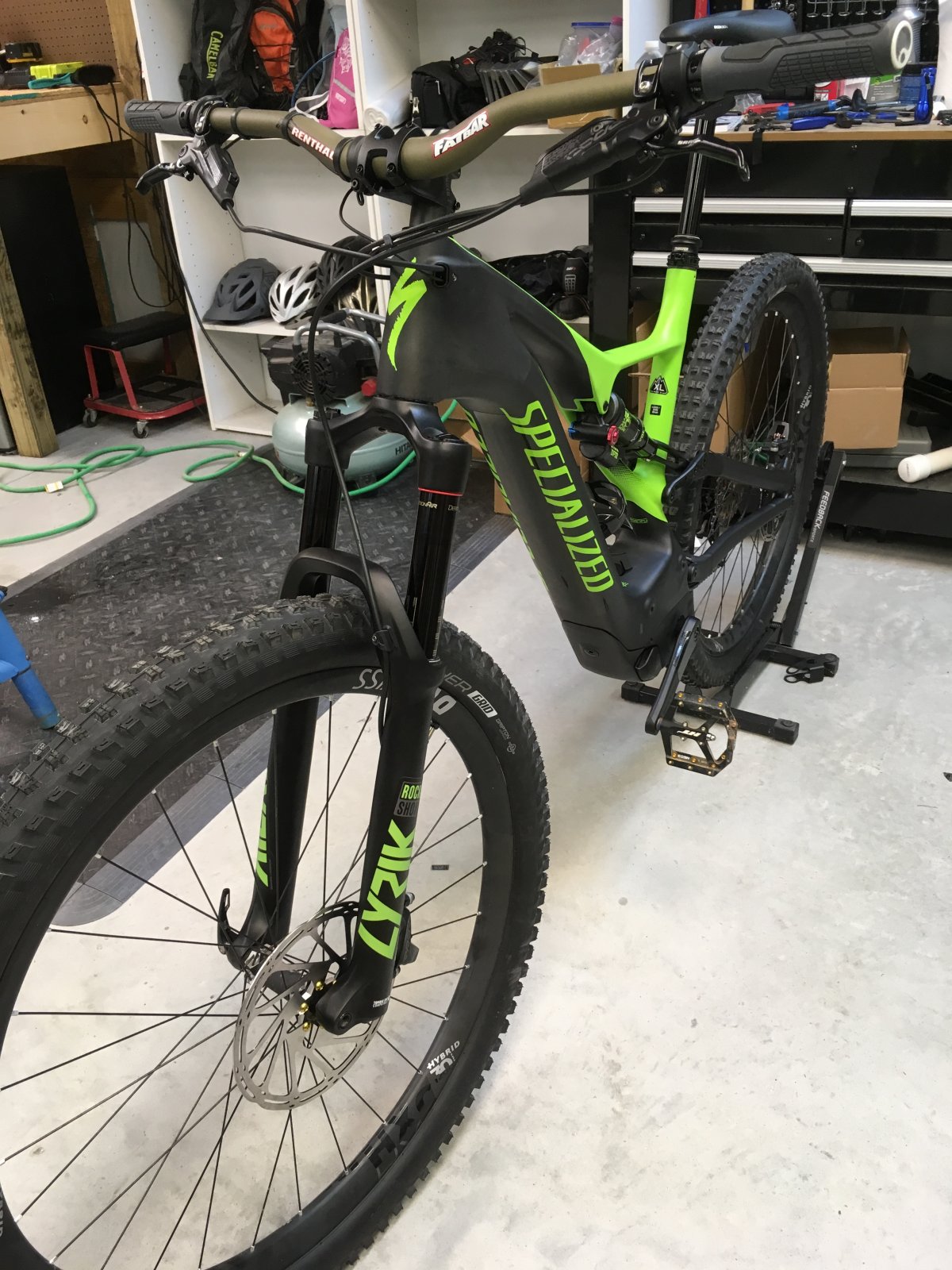

Mike192
Jul 7, 2019
Braintree, Essex

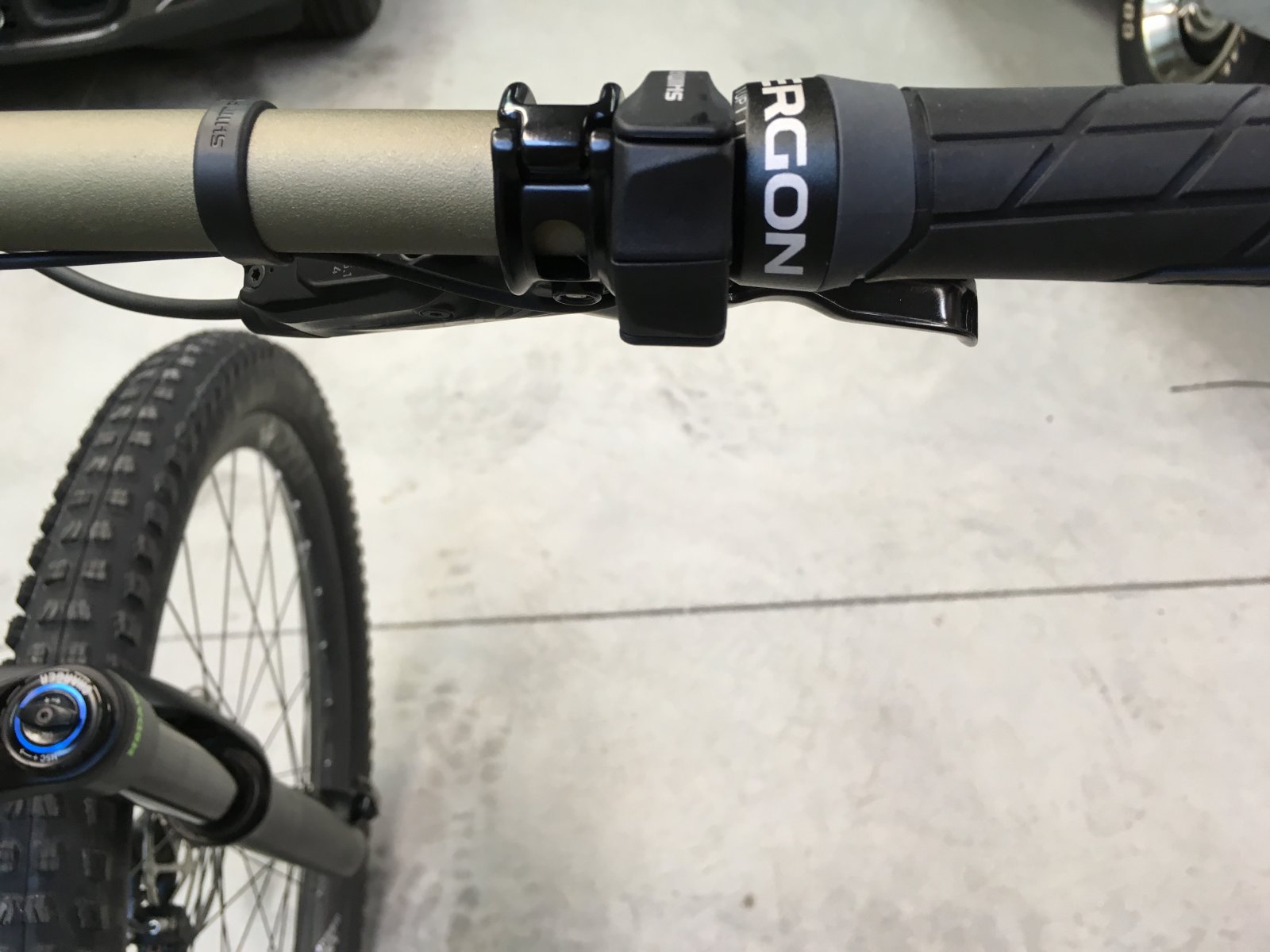

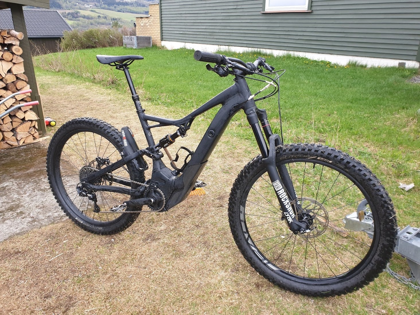

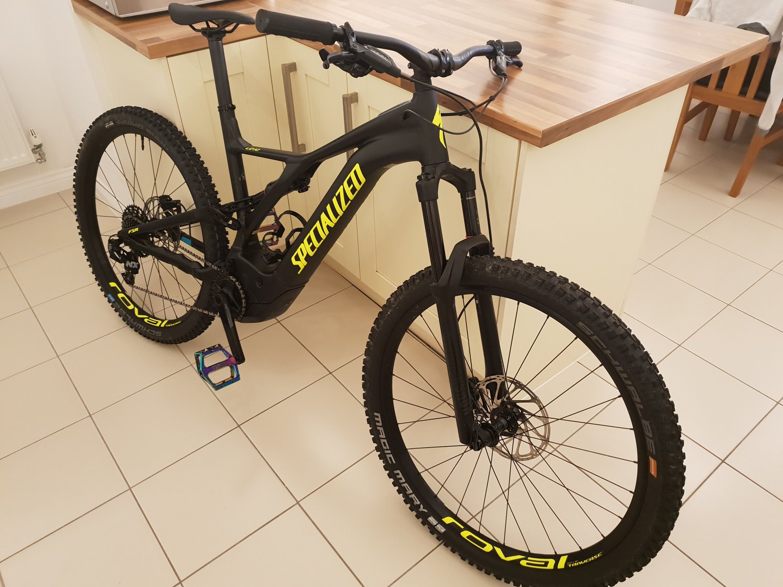

Only had my Levo Comp Carbon 3 weeks so far Invisiframe wrapped, changed seat and grips to Ergon and swapped out the forks to my existing 160 Lyriks which I had Push ACS3 converted last year. I also have a set of blue Hope V4’s with blue centre disks which I may put on but just riding and trying out the RE’s that come on the bike for the moment.
Might also swap out the rear shock at some point any recommendations? Loved the coil that was on a Fantic 180 that I demoed while riding at the Forest of Dean.
