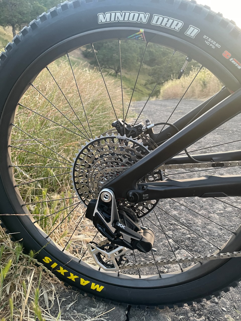

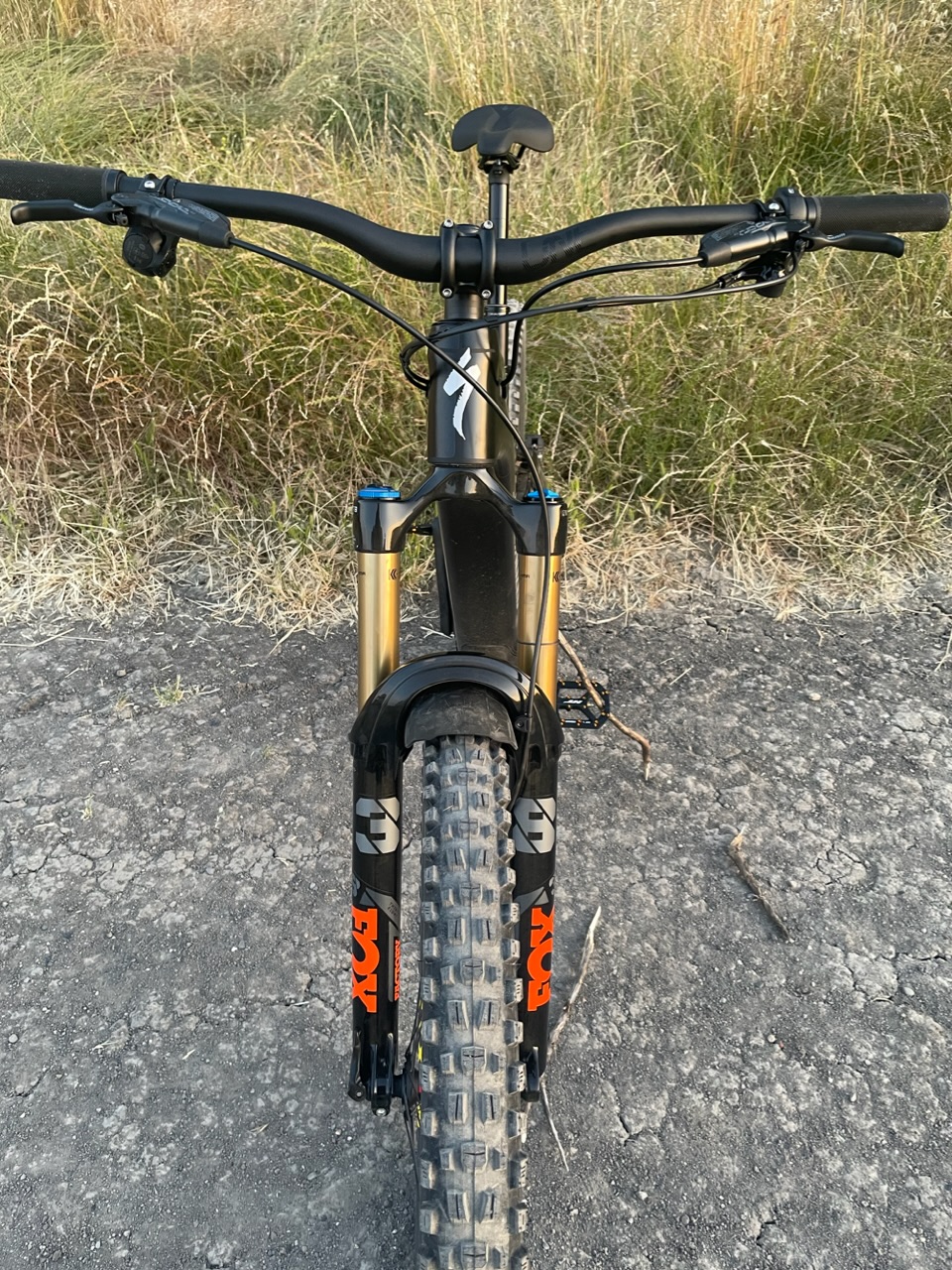

Just thought I’d share my bike build. I took it out for a quick shake down on Memorial Day after finishing the build.
It started out as a carbon comp, which I got on sale for $6,750 (cheaper than an S works frame, but it’s the same).
- Fox 38 factory e-bike version 170mm
- Rockshox 2023 super deluxe ultimate coil with HBO (230x65 to match the Cascade long link)
- MRP premium spring
- We Are One Triad with DT Swiss 240 hubs 28/32. Sapim spokes
- Assegai 2.6 front, DHR 2.6 rear
- Tannus foam inserts with tubes
- Cascade long link (165mm travel)
- BB set to low
- Sram eagle xx transmission
- Praxis carbon cranks 160mm
- One Up carbon bars
- Enve M7 stem 50mm
- HT ME03 evo+ pedals
- Fox XL front mudguard
- Invisiframe wrap
- Kept the stock saddle, dropper, grips, and brakes
Total cost $12.8k, which is about the same as an S Works. I like tinkering, plus I was able to support some companies I like, and choose a bike that suits my preferences.
Also, I have enough spare parts to build most of another bike…

very nice, how are you finding the coil shock? some reviews and shock tuners are suggesting the rebound damping is too slow. How does it ride?
pontoon
Apr 24, 2023
63
21
I like it, but I’m no expert.
It rides really well. I switched the bottom bracket back to the high position and prefer that. I’m still messing with the suspension. I swapped from 3 to 1 volume spacer on the fork if I recall correctly, and am still playing around with the clickers. I got the traction and cornering to be very good, and i think I may have messed up the balance front to rear when jumping just a little bit. Overall it’s awesome and just needs a little more fine tuning.
